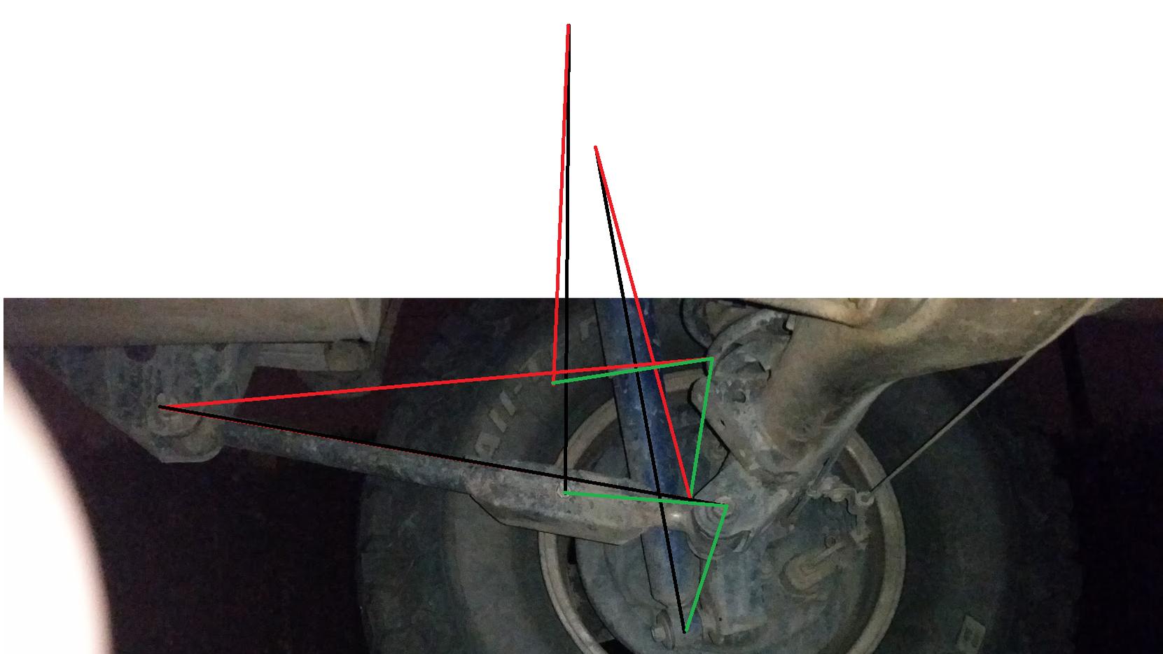

forgive my crude drawing here, but its about the same. also since both shocks move in, it should give more flex travel, as if I needed it.

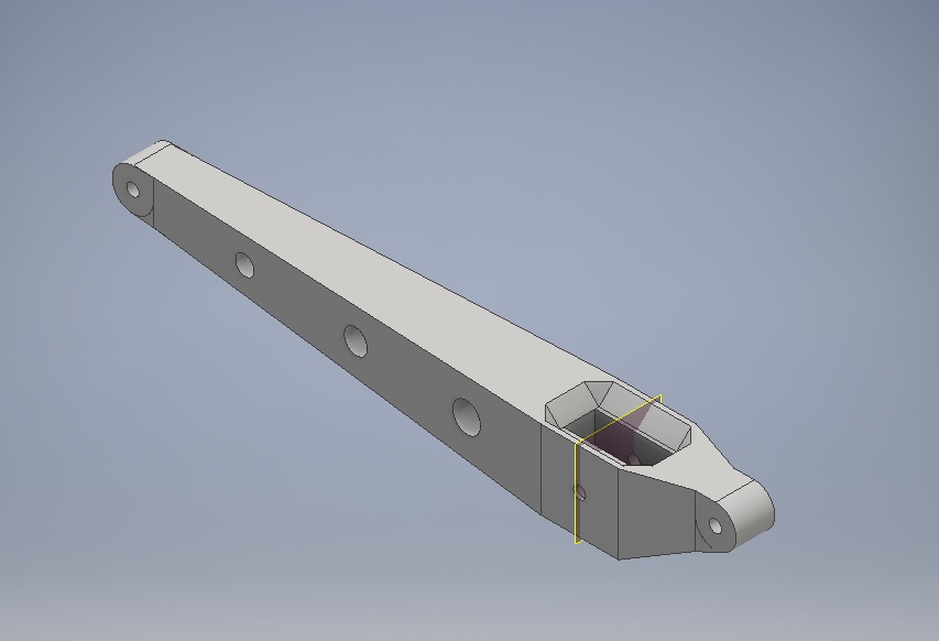

screw ill just do a whole new arm from scratch, 30" and call it a day.
That's the geometry I was trying to visualize. I guess the angle isn't nearly as extreme as what I had imagined. I'm interested in seeing how much the shocks will be softened by the new geometry. But, out of curiosity, why not just find a different shock that is about the same length as the lc shocks but valves a little softer?
more travel.
subbed i have a feeling this geometry isnt going to work. I would just not waste your time and get longer shocks. Also dont trust that FEA, do the hand calculations, dynamic not static...
also travel is usually a function of shock length in a proper setup.

You said that for 9" of travel at the shock you will get 12" of travel at the axle . . . is that a calculated number?
And then, looking at the picture, just by mounted the shock at that location on the lca, you will be compressing it a good 4" or 5" inches (just a estimate from looking at the picture), unless of course you raise the location of the upper shock mount locations at the frame. So you will be reducing the shock travel proportionally by that amount right off the bat. The shocks will also be in a stiffer region of the valving with being compressed. Arent you concerned about that offsetting the goal of softening the shock?

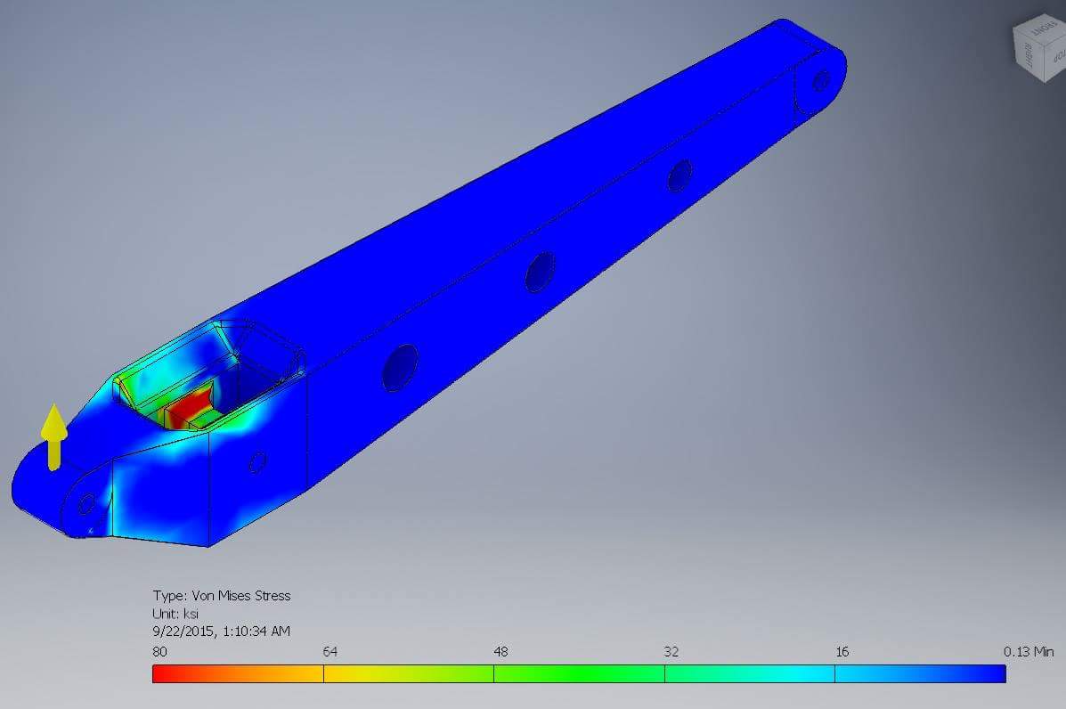

so before we go any further here, my field of study is manufacturing engineering, not mechanical, so any advice in that regard is greatly appreciated. I have been using inventor for more than 6 years and solidworks for about 5 years, mostly for modeling on various projects. I dont know all that much about stress analysis so you will have to bear with me here until I do a bit more research. what im saying is feel free to school me on it as im just figuring it out as I go. also dont hold your breath i have a very busy schedule this semester.
I redid the entire arm to the length it will be eventually which is 30", it has two backbones running through and has an outer shell as well, all in 3/16 mild steel. the strength of the first arm was being held back because what I already had there was limiting the design. this one worked out a lot better.
for the fea setup, I constrained the frame end of the link as a pin, and im planning on making a platform that will be conected to the shock mount. the platform will be constrained to a frictionless plain in order to allow it to move. perhaps the proper way to set it up would be to make a frame and connect the shock and end of the link to it so it can move the way its supposed to.
Im not sure if I mentioned this, but the upper shock mount will also move up about 5" and there is plenty of room for it, then ill cut a couple access holes in the cab and seal them with small deckplates.
moving the shock mount up, also I dont have bypass shocks.
yes its calculated, but that was with the stock arm length, I moved the shock foreward on the arm 5.25" and the arm is 21" long hence 15.75:21=9:12

It looks like the stress analysis for the lower control arm is a bit off. I believe you have erred on the conservative side though, so the end product will probably be way overbuilt. (which may not be a bad idea anyway)
But here's where we went wrong: The compression and rebound damping forces the shock will exert are solely a function of the shock shaft velocity. You may be able to find a shock dyno graph from the manufacturer, but if not, the forces on the lower control arms will be purely guesswork. Plus, even if you did come up with the shock dyno info, you would still have to guess at the shaft velocity.
If I was to venture a guess, I would say the shock damping forces are on the order of 300 - 500 lbf. (about 10x less than what you were using in your model)
The geometry you proposed looks like it should work. You'll just want to make sure you don't end up under-damping the rear axle.
snivilous and I had a conversation about this, basically this would be the worst case scenario, like driving accross the desert at 75mph and doing a 4ft jump without springs and a solid beam instead of a shock. snivilous recommended using a force of 10g only the corner weight, which in the back is about 10000lb maybe a bit less. anyways after adjusting the fea a bit more heres the new arm at 20,000lb of force, most of the stress is around the shock mount itself, ill increase the diameter of the bolt to fix that problem.
That's cool. It does seems a bit extreme, since the max force will likely be in the 500 lbf range. Vehicle weight also has very little affect on the damping force since it's the unsprung weight that will primarily affect the rebound velocity of the shock.
I think you are dead on, if you look here this icon shock shows about 1300lbf for the front I believe. anyways thats why im going to test my short links first, they can definitely stand up to 500lb of force.
also did you ever find any evidence that the rigidity modulus was different for different typesband tempers of spring steel? all of the information i found pointed towards them.being all about the same.
Yep I agree there, my concern was the stress concentrations from the other forces on the bar.
