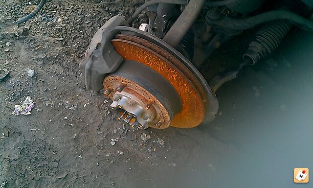

Went to, you guessed it, a junkyard, grabbed driveline bolts and studs, spotted a taco with my manual hub spindles, going back in the am, hopefully ill be back on the road tomorrow though.

Taco Spindles are all put in in. Grabbed the piece off of the diff to get rid of the ADD altogether as well.
