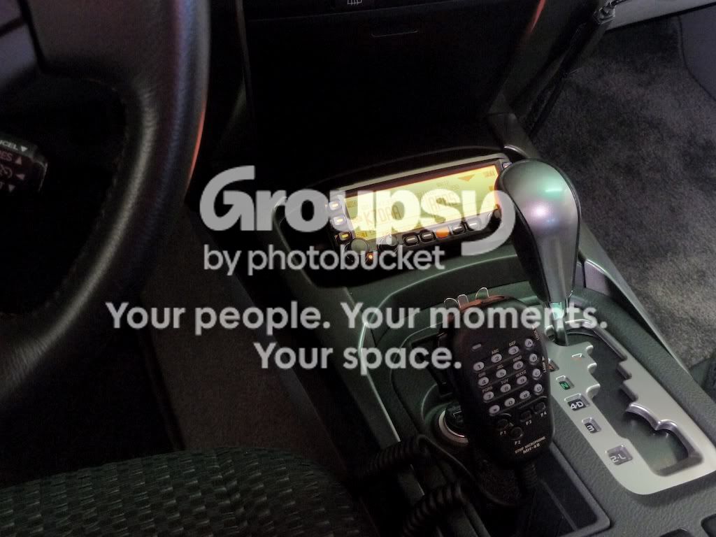

Communications-Yaesu FTM-350AR Ham Radio w/APRS

Communications
Yaesu FTM-350AR VHF/UHF Transceiver

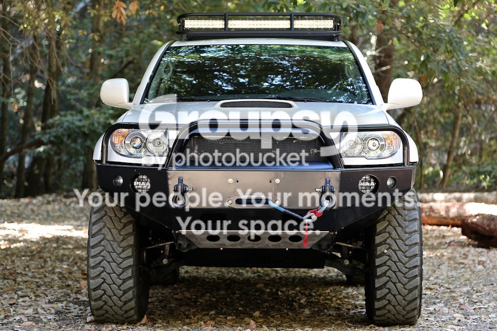

Shrockworks Front Bumper
Warn 9.5xp winch
Amsteel Blue Synthetic Line
Shrockworks aluminum fairlead

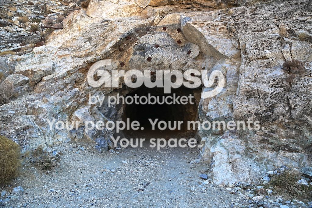

Hey Dawg, where was this picture taken?
svana,
That pic was taken about 1/4 mile into the Reward Mine. The entrance is at N36 45.096 W118 03.017. The turn off for the trail is off of 395 at the Manzanar/Reward Rd about 12 miles north of Lone Pine. Here is the entrance to the mine.
692A1925_zps4c08adcc.jpg~original
Thanks burninator!
svana,
That's pretty awesome, I wish we had something like that on this side of the country. Can you drive through that? We have caverns here, but they're just walkthroughs.

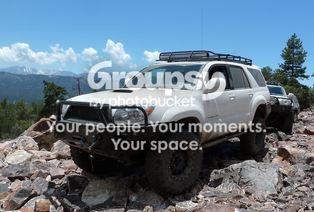

With your lift and wheels and tire setup, how tall is your car? I'm gauging to get a lift for my runner but want to make sure I can make it into my building which has a height restriction of 7 feet tall.
[MENTION=106568]Kitsune[/MENTION] My garage opening is also 7 feet tall. The highest point of the roof rack is around 6' 8" so no problem with clearance.
