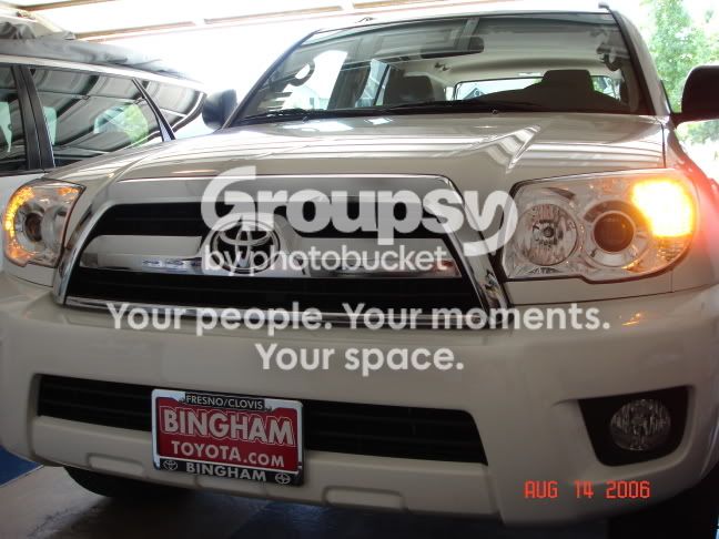

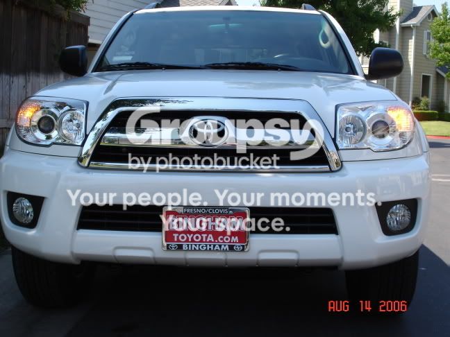

Okee Dokee, I finally did it! I ordered the DRL flasher relay early this week and installed it this morning. I followed the instructions posted in the thread and found out I had the non-DRL flasher unit, so I replaced it with the DRL flasher unit and it works! Very cool! :biggrin2:
The hardest part was getting the relay off the fuse box.

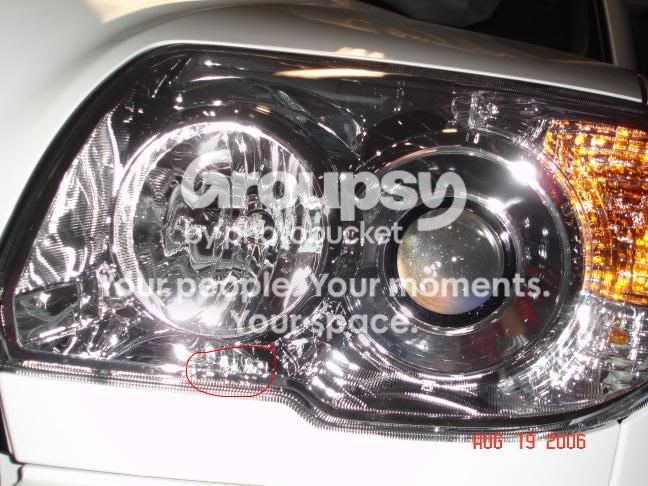

I don't know if anyone has noticed, and i dont know if this only concerns the 06s or even the 03-05s, but have you guys looked at the lens cover of the headlights?? My friend noticed this, that i didnt. There's a "DRL" logo on it. It has like a "KOITO" or something, then "DRL" right next to it.
I guess it means, it's all DRL ready??
22DSC01092DRLDRL.jpg~original
I have Canadian version with DRL, but couldn't find DRL logo on my headlights.

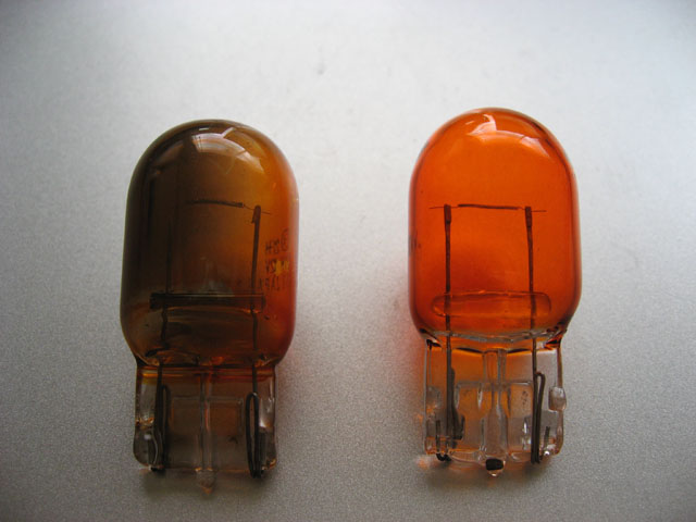

It's been a little over 2 years since I've done the DRL mod and my front light burned out yesterday. I've attached a picture of the old bulb and a new one. You can see the old one looks pretty bad and burned, it doesn't look like the bulb was made to withstand constant usage. Maybe that's why Toyota decided to use the 4157 bulb instead of the 7440 on models equipped with DRL from the factory. Otherwise, there are no problems with the wiring or the socket that I could tell.
