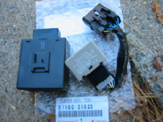

Yes it comes complete. When you receive it, all you get is the DRL flasher. Its the big black box on the left. To the right is the Non DRL Flasher and the wiring harness that goes with it.
If you want the DRL flasher you have to remove the smaller beige NON DRL Flasher and wiring harness and plug the DRL flasher into its place.

sharp4runr said:
I started this thread almost 2 years ago and finally got around to doing it. Thanks for all your help!!!!
DRL Equipped :)
I've had that damn part for it must be a year now and still haven't done it. I think it is because I didn't have a visual......and now I do thanks to your picture. So, it is about damn time that I get in there and set this up. I would have perferred to wire it to a switch, but I don't think I have the skills to tackle that. I know someone did it.....was it save? ......and simple?
