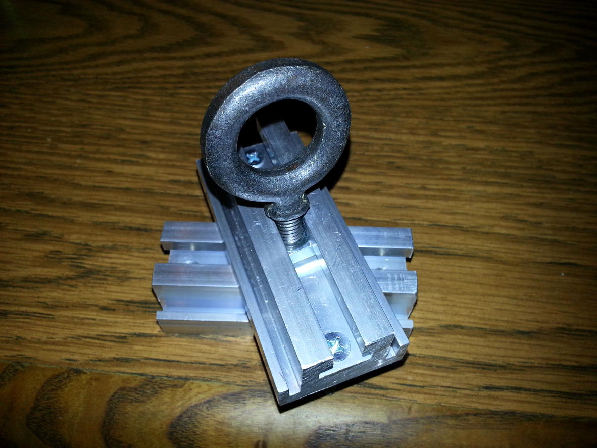

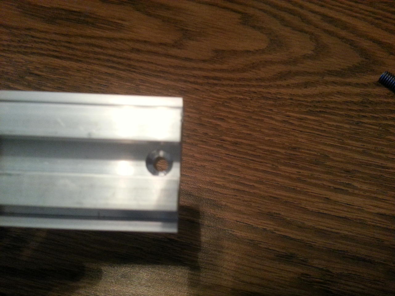

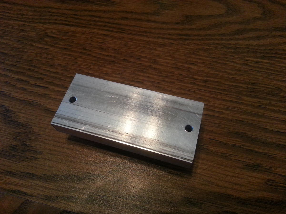

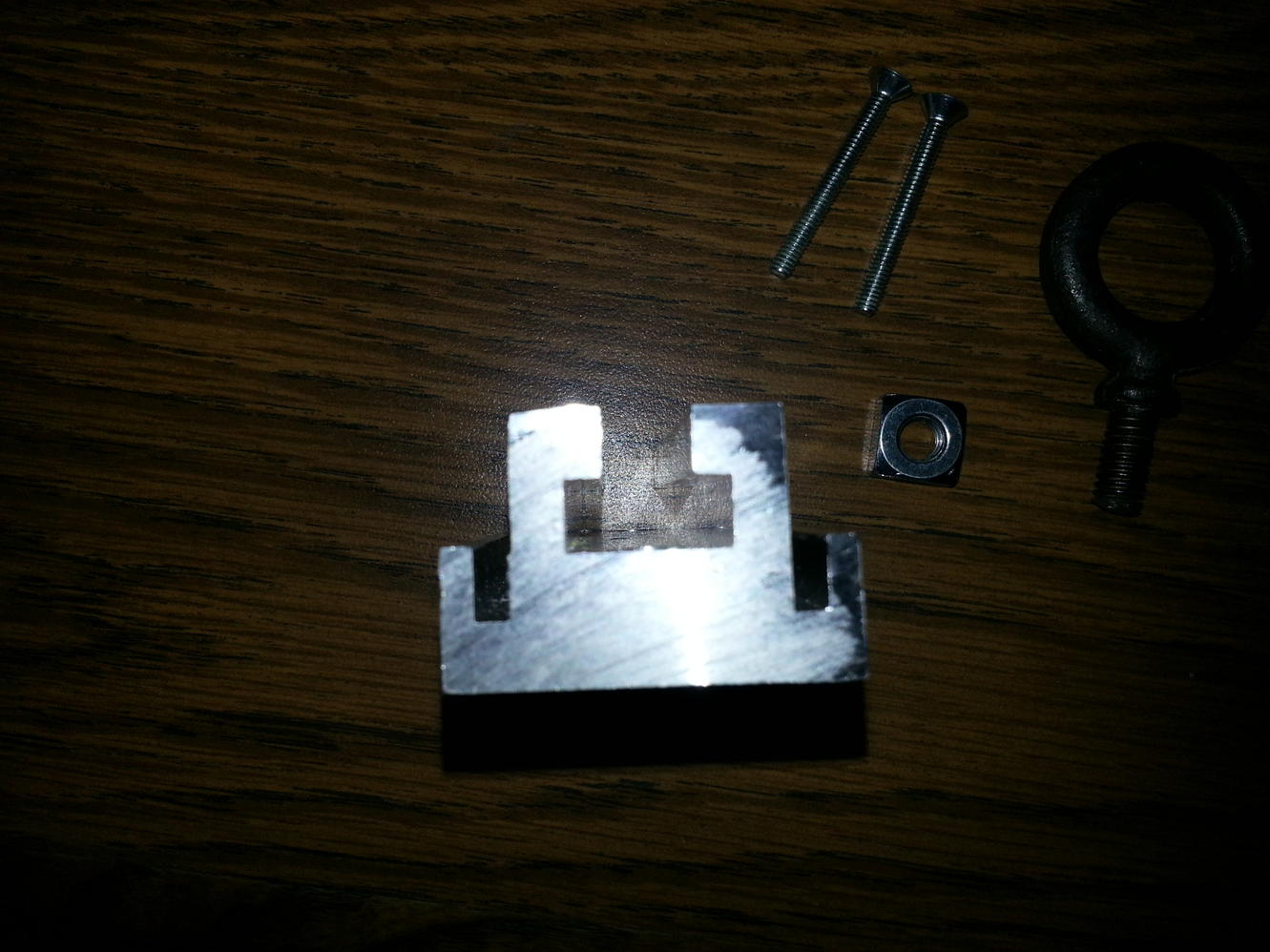

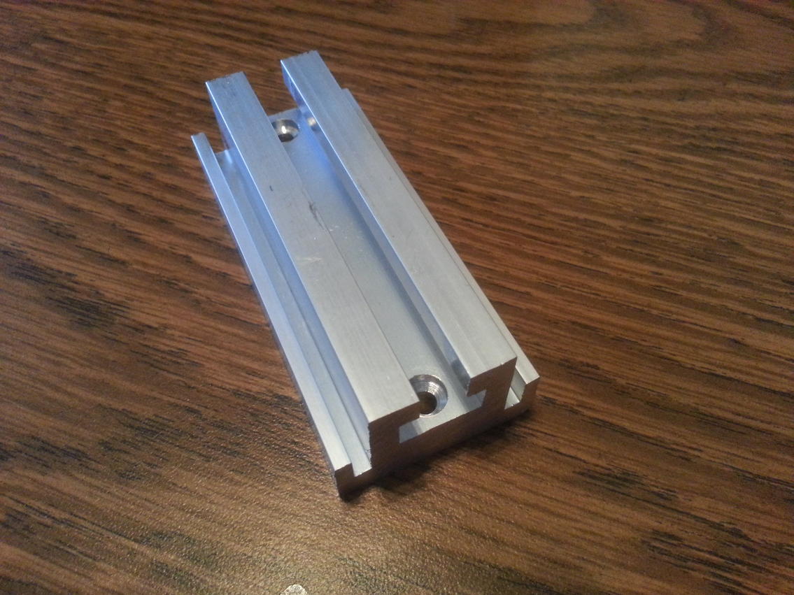

I was thinking of doing a cargo box for the back of the t4r but I still want to keep my tie down points in case I need to strap something down. I was looking through some of the supplies at the CNC shop I work for part time and think I've found a pretty slick solution if I do say so myself. :naughty:
We sell something called a T-slot table which helps our customers bolt down their machine and the material they're working with in a precise manner. The extruded aluminum will hold a bolt head or square nut in place by tightening down the bolt/torquing the nut. It seems plenty sturdy (I'll post as I run tests) and the best part is the bolt can be slid back and forth and torqued down where you need it to sit. They are affixed with relatively small bolts, but I think with a fender washer, a backing plate and making the bolt holes every 2-3" it should be plenty sturdy.
I was thinking a set of 4, 3" segments would give me plenty of places to mount to, but the T-Slot channel comes in 10' lenghts so it can really be used on pick up trucks, roof racks, flat bed trailers...just about anywhere you need adjustable cargo mounts. The I bolt pictured doesn't require any tools. Just tighten the bolt down to lock, loosen to slide. I'm thinking it could probably be used to make your bolt on accessory lights moveable as well?
Now to the point; any questions or recommendations to improve the design are encouraged. Making these in small quantities is fairly expensive so would anyone else out there be interested so I can buy materials in bulk? I figure a set of 2, 3" long mounting points would cost about $15 in materials. I can get quotes on custom pieces, but I figure $80ish for a pair of 3ft long rails with 4 pieces of mounting hardware, and for the truck guys maybe $120 for a pair of 6ft long with 6 pieces of mounting hardware? I should be able to get a 5-10% price brake after ordering 20ft of material but the hardware is still retail :/

You are definitely on to something! I like the rail system my Tacoma and my Tundra had, this is something along those lines where you can move the mounting point to fit your need. How do you plan to mount the rail system to the top of your cargo box?
Well I haven't built the box yetso I'll cross that bridge when I come to it. I figure intall it with bolts long enough to go through the board I make the box out of and make a backing plate for it. Maybe even make a frame out of 2x4 and run the a rack the length of the cab so I can suspend a cargo net across the entire back? Good to keep stuff in if the windows are open...use it as a makeshift hammock when my wife figures out how much I'm spending on the truck and kicks me out of the house?

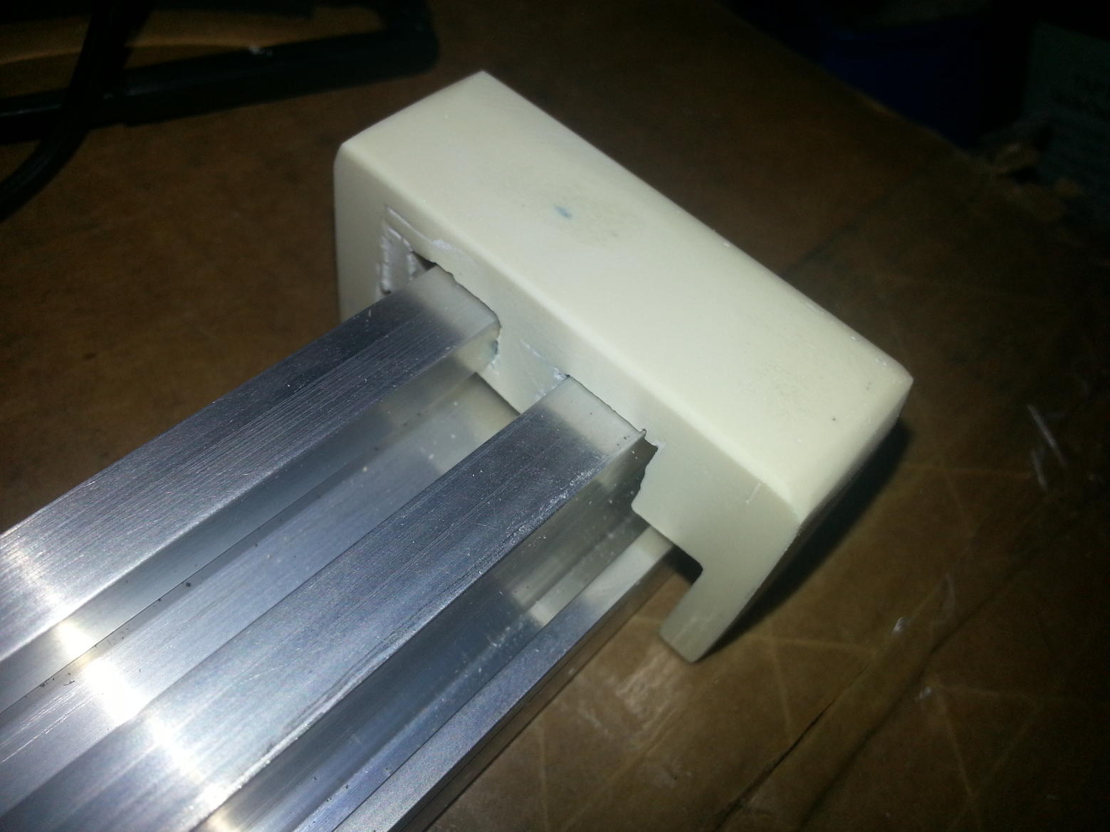

It's been slow going since I've been busy at the full time job, but I finally got a few more hours to work on it this week. I've taken a couple of 2ft long sections, drilled them out and filed them down to do a demo on monday (more photos and hopefully a video) to follow.

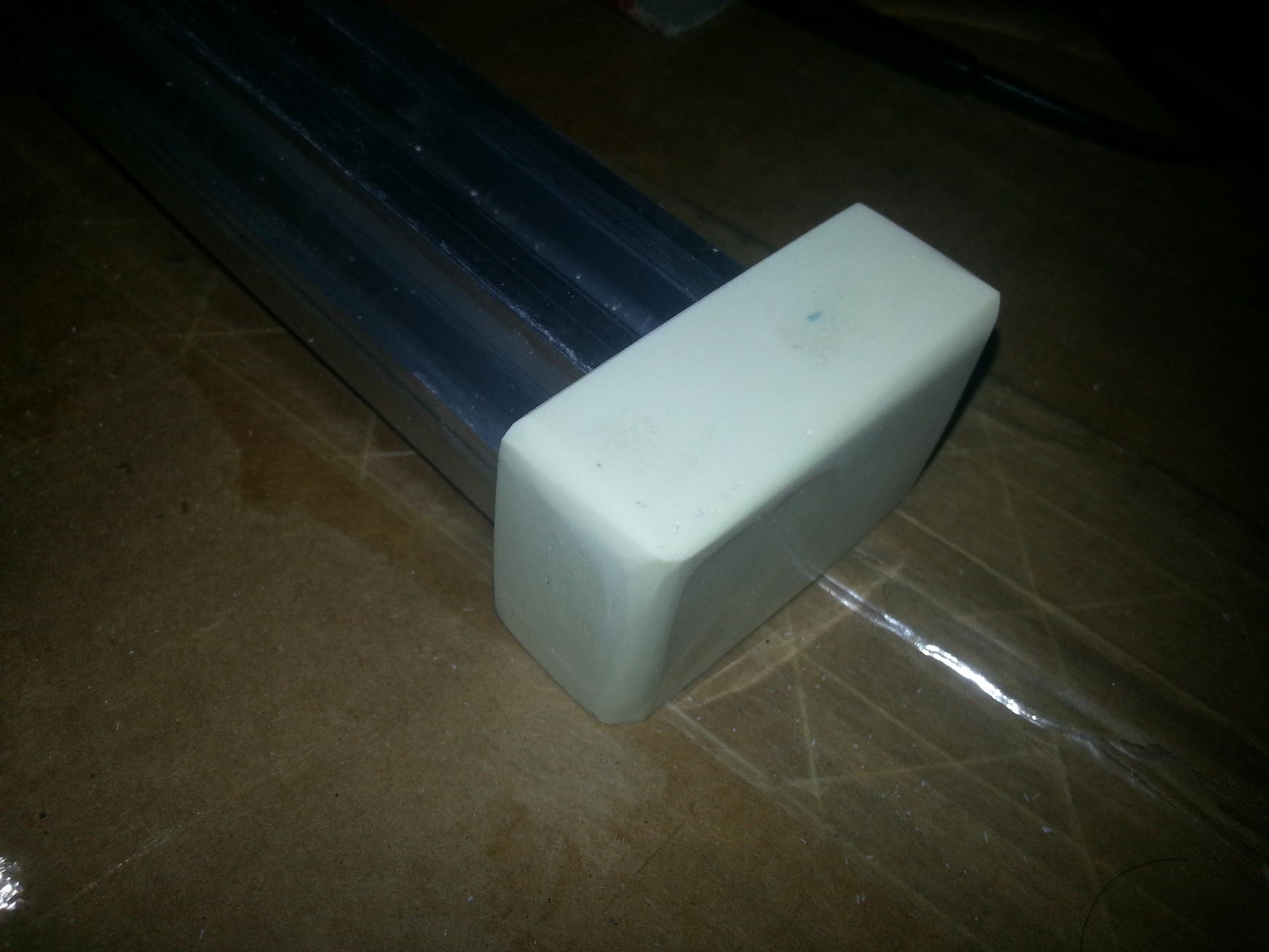

In the mean time I made an end cap out balsa wood, made a silicon mold and have made a few to give it a more finished look. Pretty excited about getting this rolling, but again I'm looking for any feedback I can get while I'm piecing this together.

I was thinking it was like 8020 too (my company gets it from McMaster). Though what's nice about what he has is it's extruded in only one direction, not on all four faces like 8020. Makes it a bit simpler and nicer looking in my opinion.

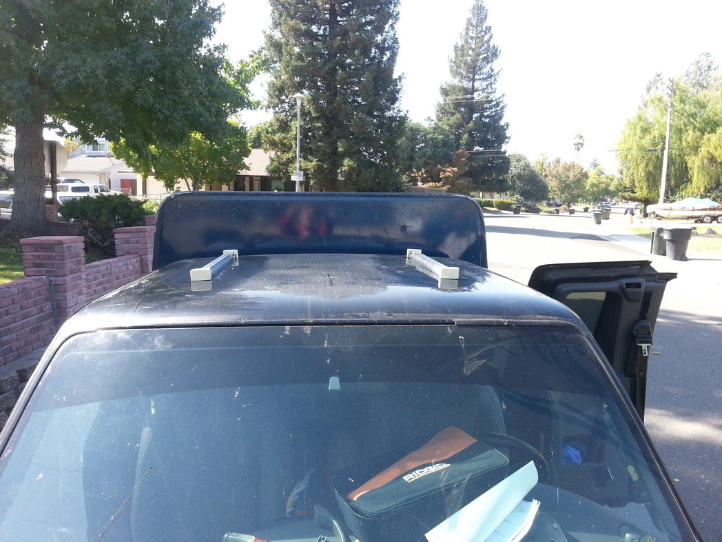

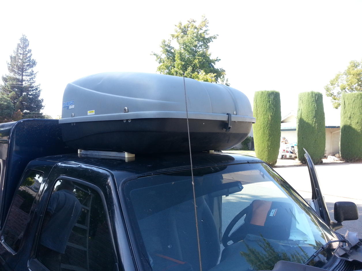

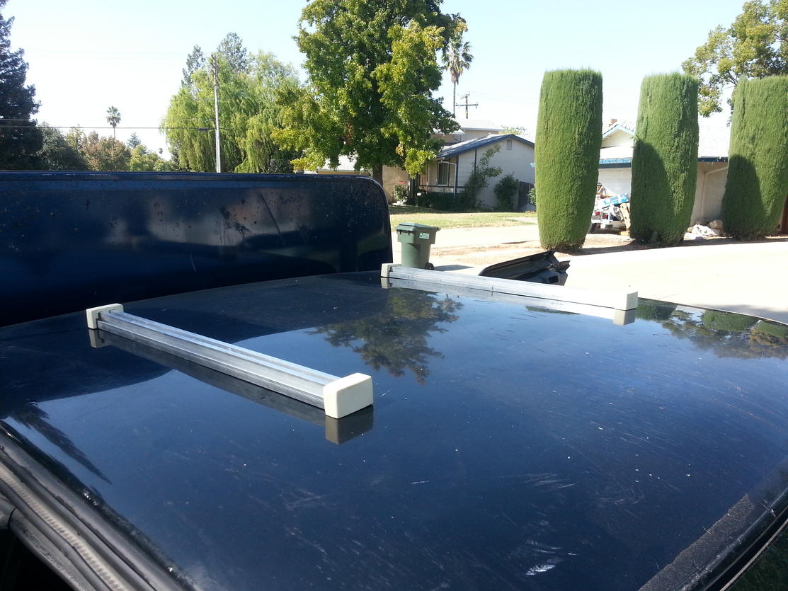

Well it's getting a slow start, but had my first buyer (other than myself of course). Here's some pictures.
