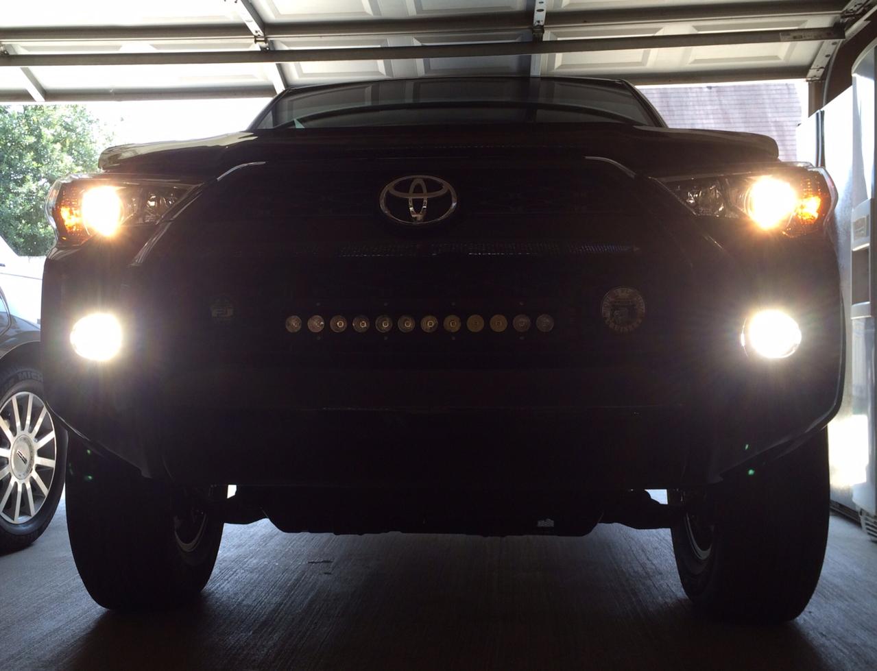

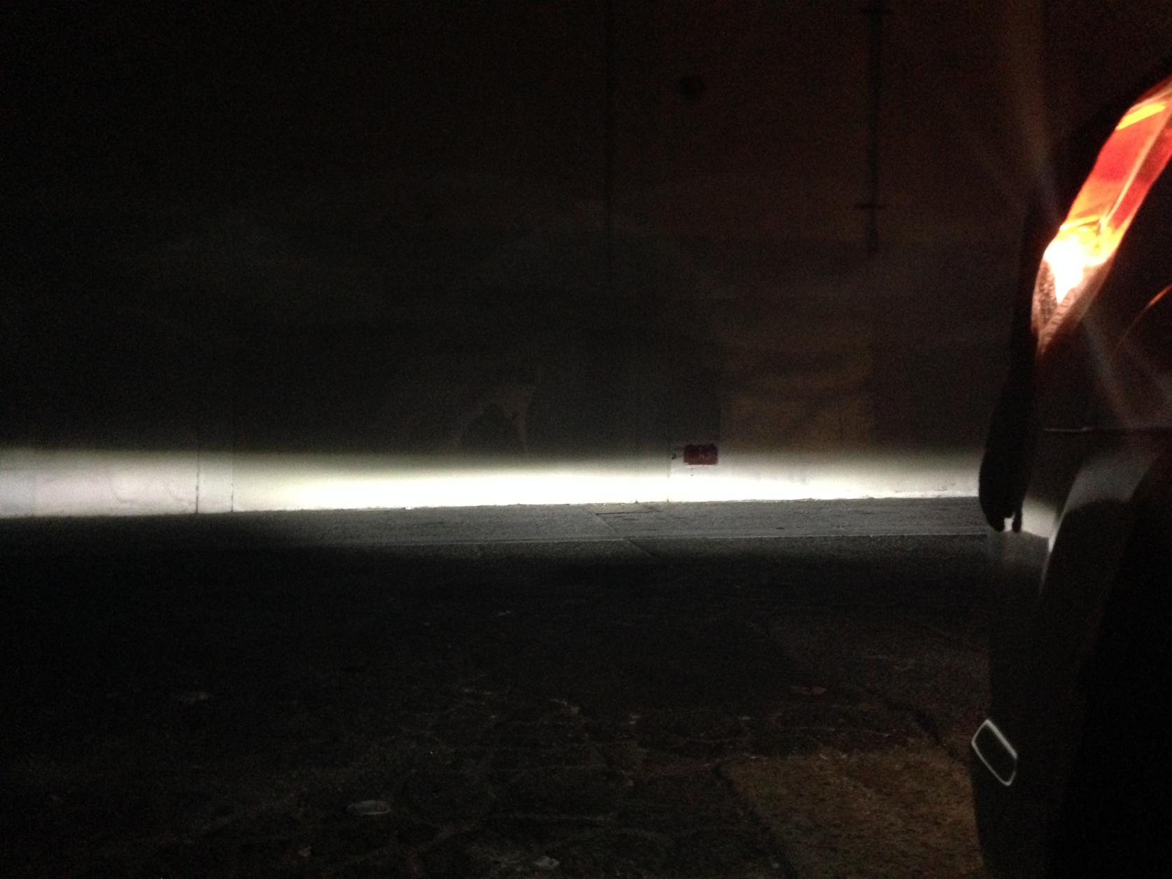

Installed my Morimoto XB LED Fog Lights and adjusted!

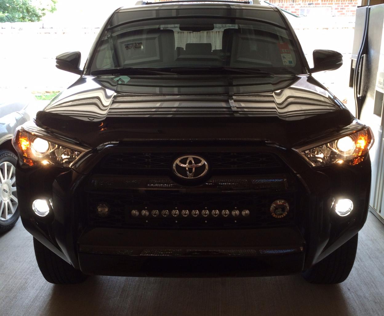

Sorry about not taking pics during my swap / install as I was installing them over my lunch hour and was in a rush. The adjustment screw needs to be removed from the stock unit to swap the mounts and then installed again so there was some adjustment after installation. I was able to adjust them slightly to my liking using both a 9ft and 25ft distance to verify the adjustment (I went with 4 inches below horizontal on the drivers side and about 2 inches down on the passenger side). I'll see about getting some pics of the post install showing how they look in the openings during the day tomorrow. On my 4Runner trail there is less of a gap but still a gap when compared to the stock lights. I'm happy with the install now though.
I took a video tonight using my dash cam and uploaded to youtube to show the difference between stock headlights only and then turning these on. The dash cam doesn't have the best night time video but you can see the difference when the just the stock headlights are on and then when having both the stock headlights and the Morimoto LEDs on. The video doesn't really do the brightness of these justice but it does show the difference.
