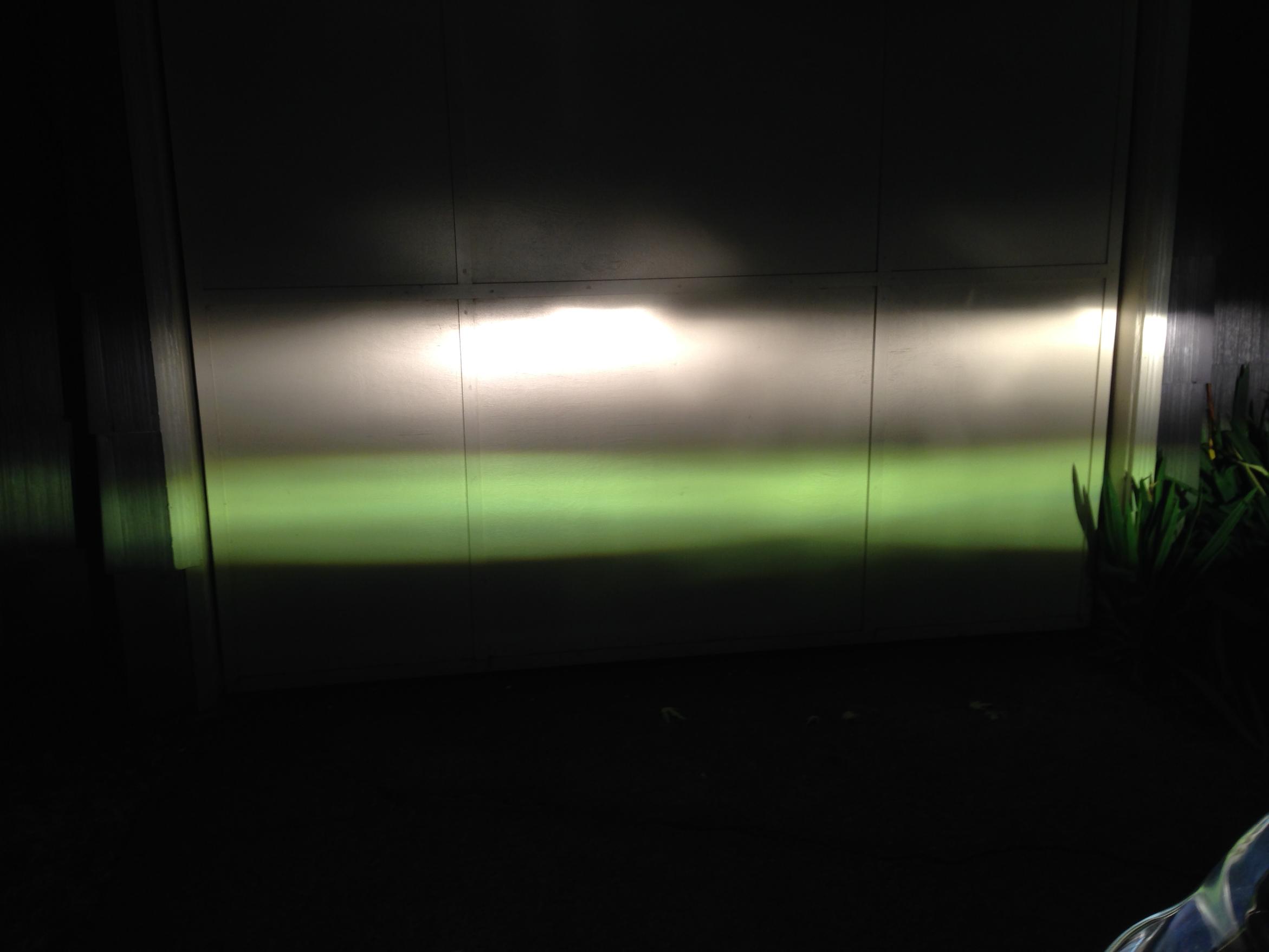

When I installed my LED fogs, projected illumination was at level with the headlight level of illumination. That's a bit high, the illumination for the fogs should be below the headlight. With the level below the headlight, you get better illumination of the area, where the headlight illumination kinda crates a dead spot.

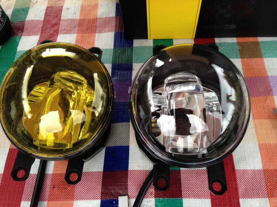

Also decided to order the yellow film directly from Lamin-x.

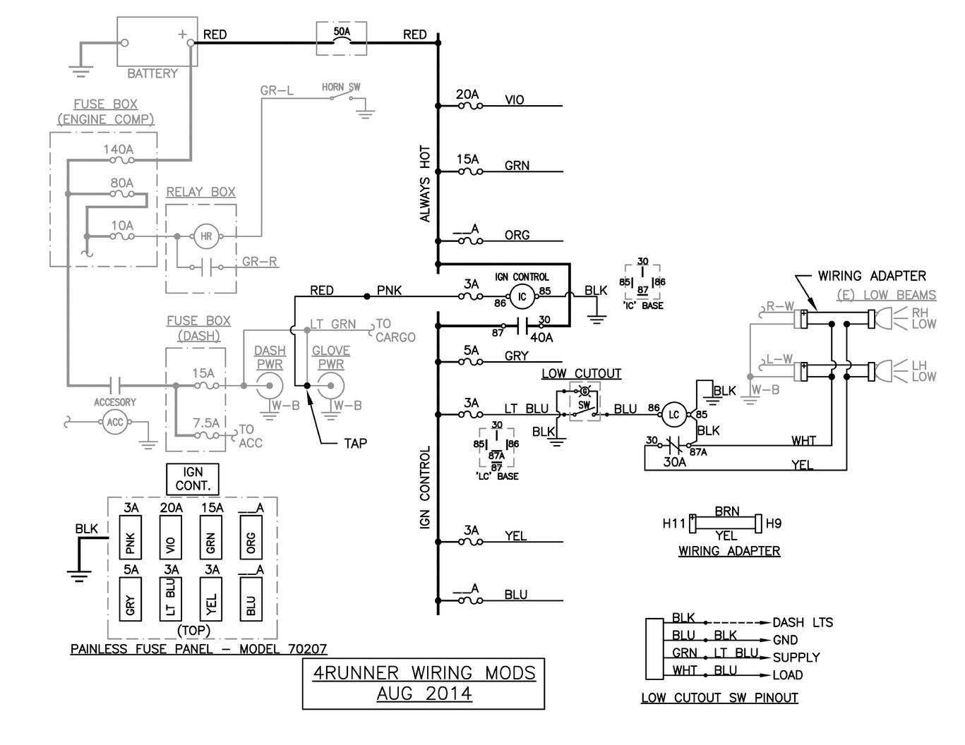

Here is my Wiring Diagram for running fogs without the headlights.
Note that it involves reverse logic...you have to turn "on" the relay which in turn, turns 'off" the headlights.

1st the Wiring Diagram:

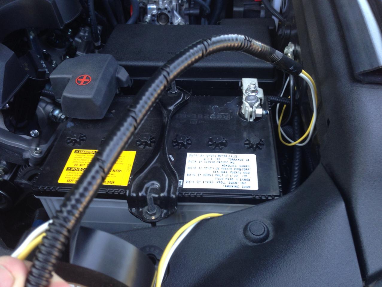

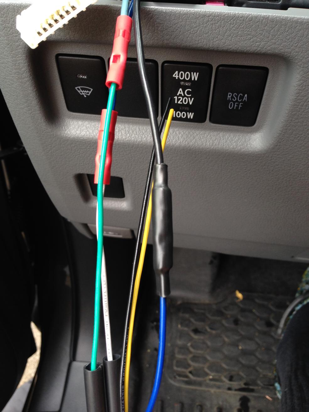

Digging out the trigger wire from Power Source:

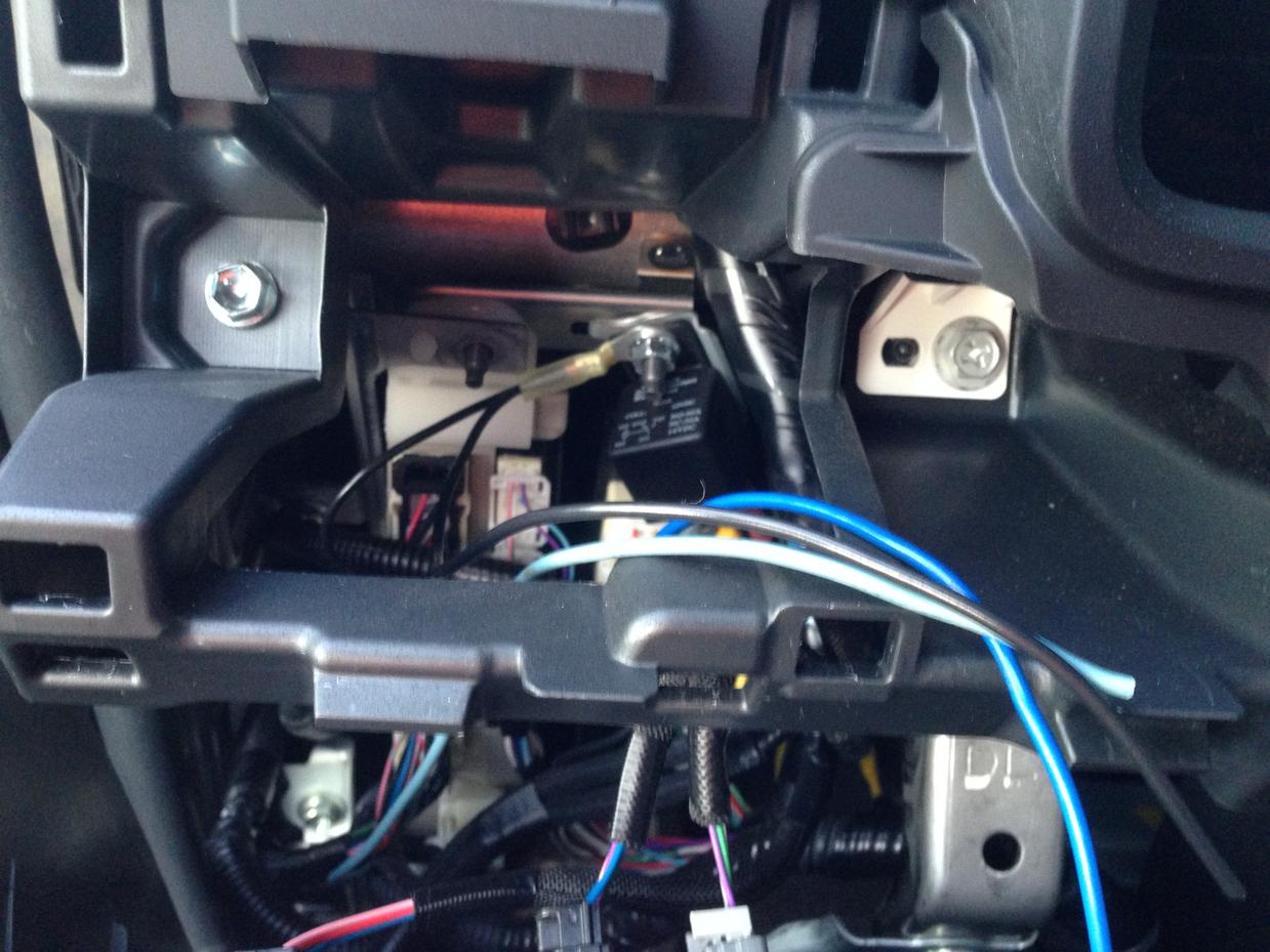

Relay Installed and wires ready for switch:

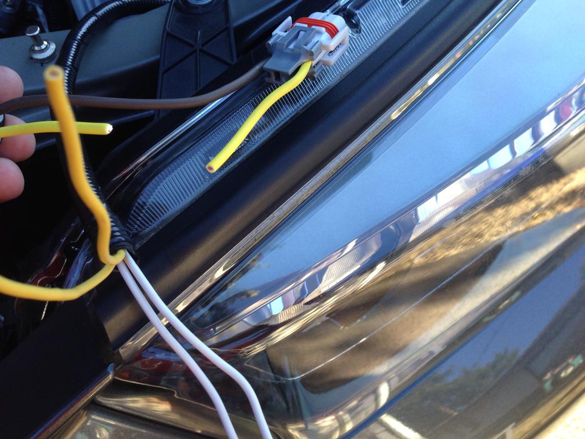

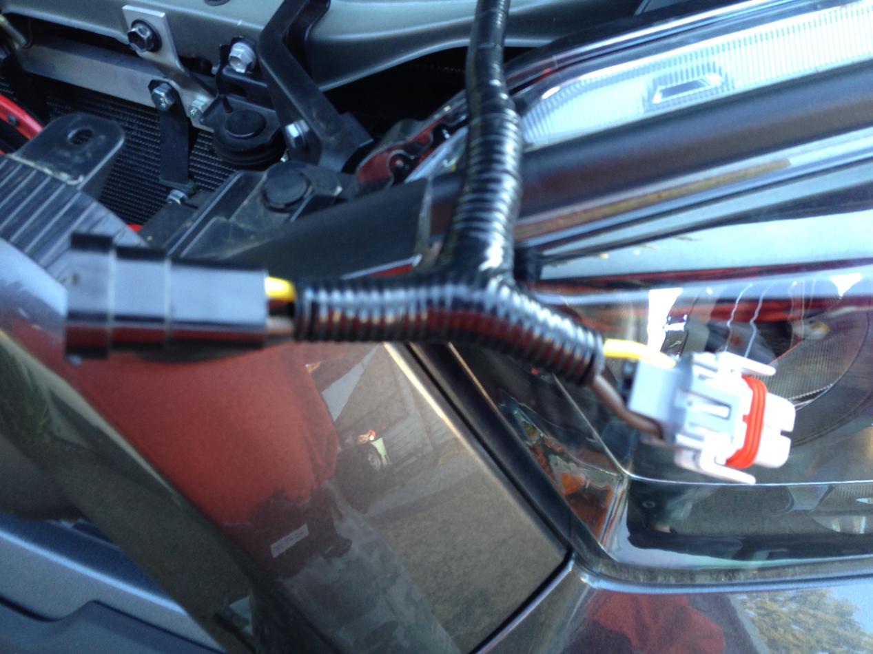

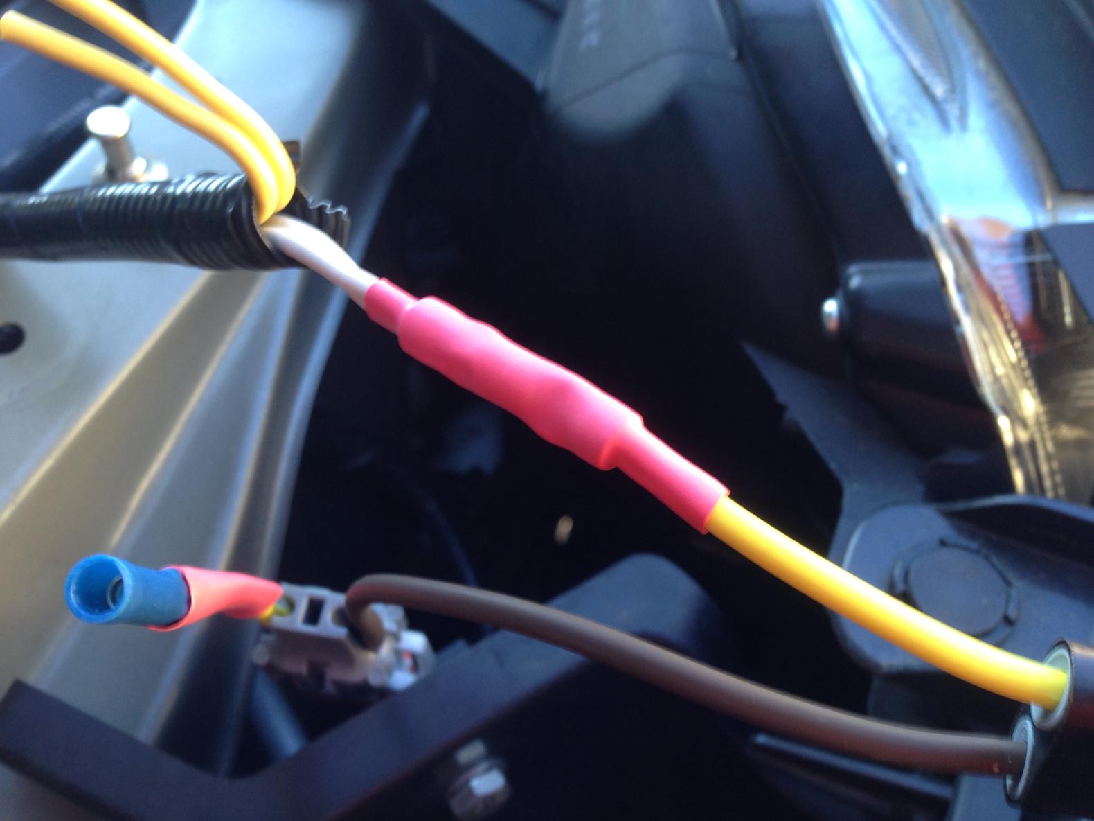

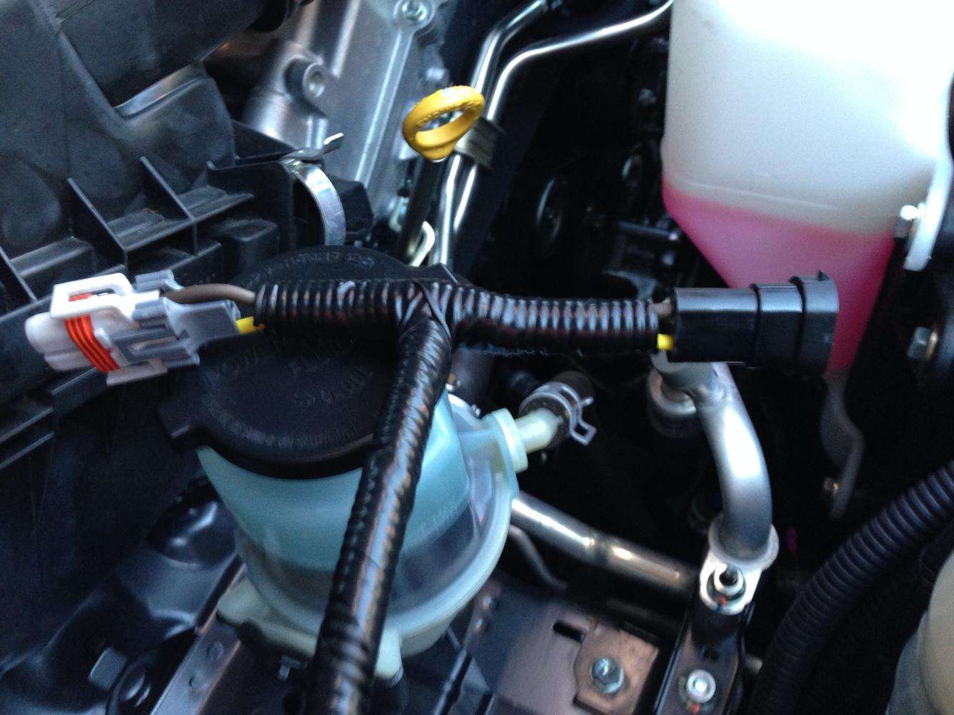

Cutting wiring adapter on Drivers side:
Driver side splicing:
Driver side harness complete:

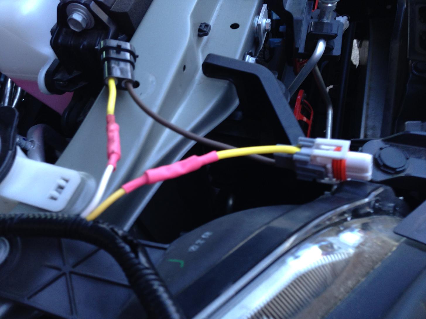

Pass side splicing:
Pass side harness complete:

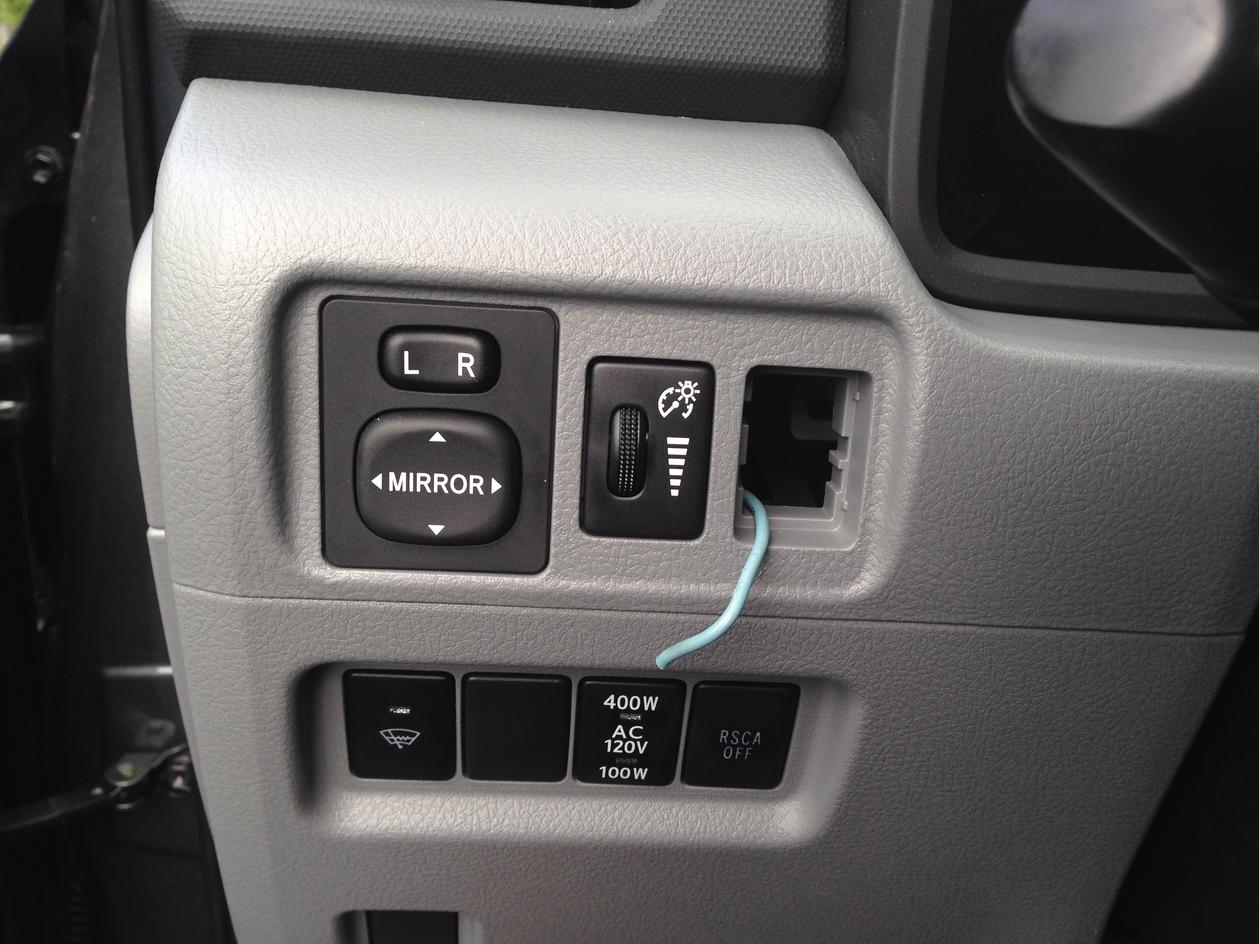

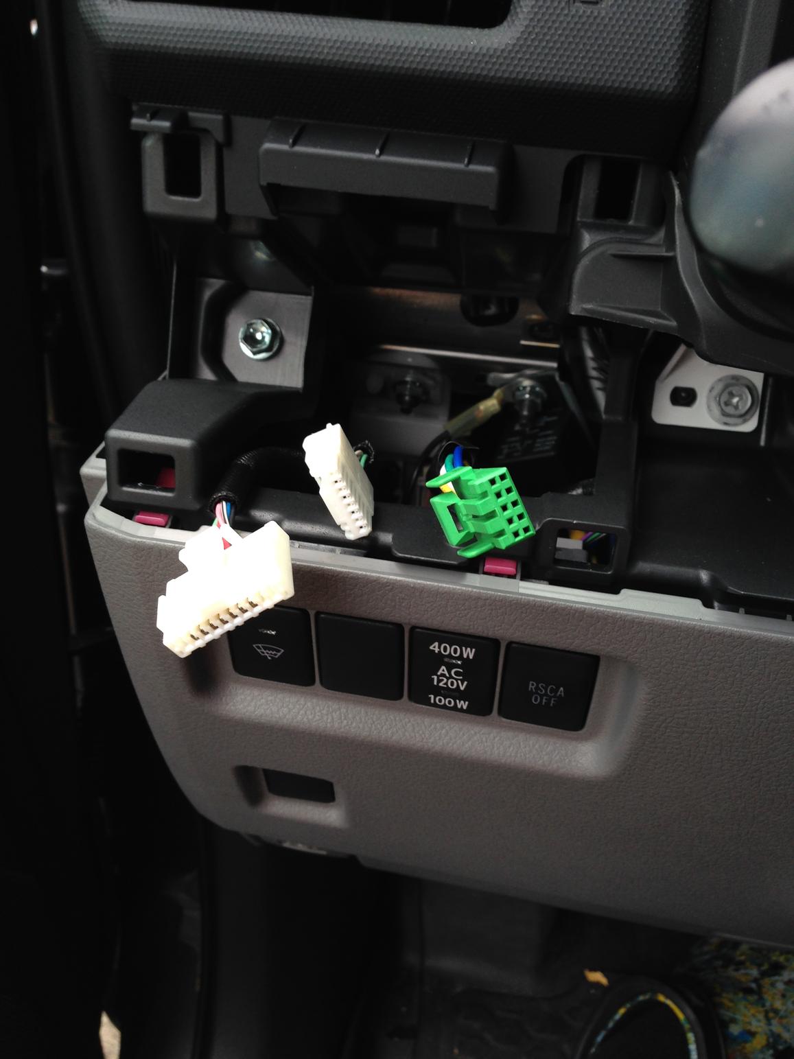

Dash wiring ready for switch:
Dash panel ready for install:

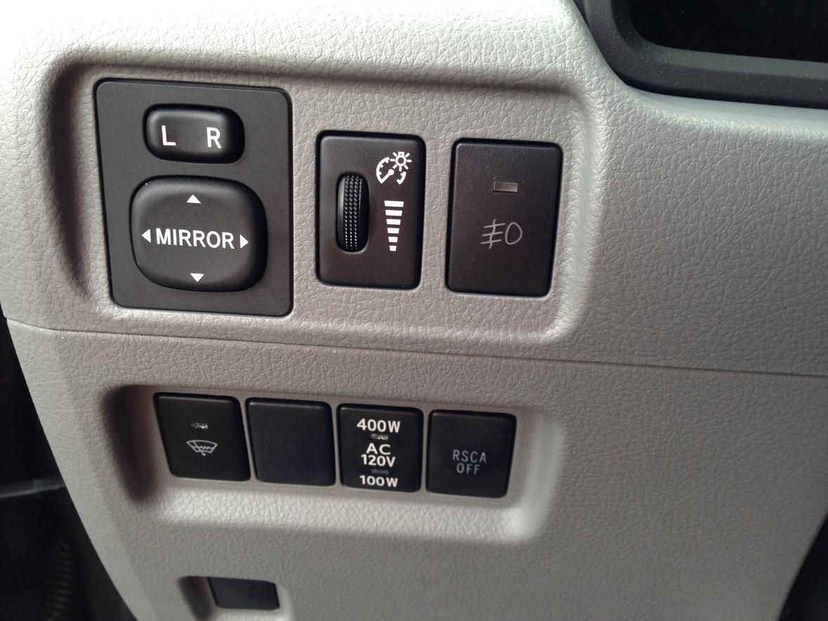

Slee Offroad switch installed:
LED Fogs yellow film application:

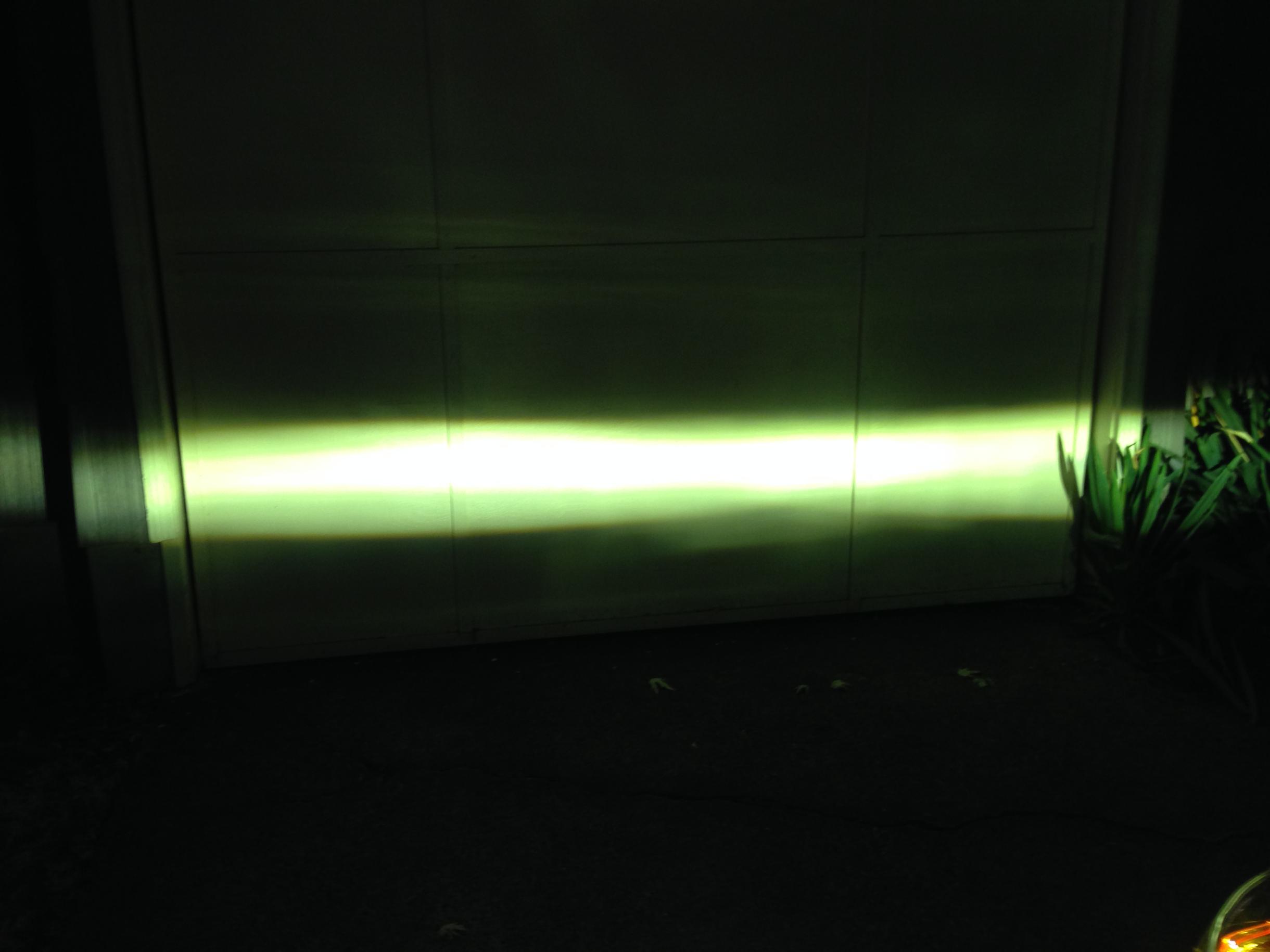

Later that night, Fogs & Low Beams:
Now, switch activated and Fogs only:

Yes, you still have to turn the stalk to the Headlight position to get Fogs...and then yes, you activate
the Slee Switch which in turn energizes the relay. When the relay is energized the "Normally Closed"
contact that is in series with the Ground return path of the Low Beams, opens up...thus turning the Low Beams off.
As I mentioned in an earlier post, it occurred to me that you could get the "trigger" voltage from the "Hot"
(Positive) side of the intermediate Wiring Adapter between the Factory Wiring Harness and the Low Beams.
Since I already had the Painless Fuse panel, I opted to use the "Ignition Controlled" side of it so when key is shutoff,
the "Cutout Relay" is de-energized. I guess you could always use the "double-push" of the key fob to turn the Low
Beams off too. That would also de-energize the relay.
As [MENTION=65614]Antman[/MENTION] experienced....when you use relays, the dash indicators still think that
things are still on. Just ignore that. I'm not about to tear into my Gauge Panel to fix it.

The pics are not very color compliant....iPhone. They actually look yellow on the road.
