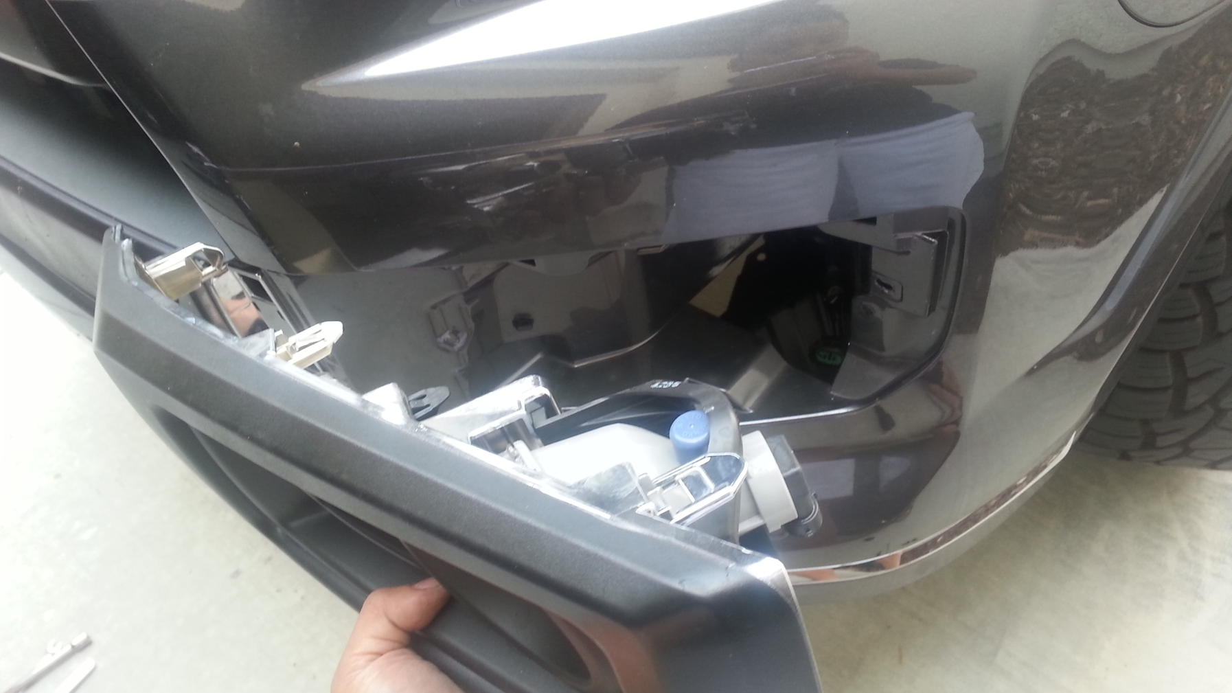

Does anyone know if there another way to install without removing the entire front bumper? I know the OP says you have to remove the front bumper for the 14 limited. thx.
^ TY sir! I feel better that no bumper removal is required but
I'm a lil embarrass to overlooked that and didn't pay attention. lol.
^Is the cover you describe on the passenger side? Need to pop if off. There are locking tabs in each side. PITA to remove but doable. The good news is that the driver side don't have one.
On the limited, the cover is part of the bumper. I follow barry's removal of the fender liner and reached in to the 3 clips and 1 screws each side. Once successful you can pop the bumper/fog light cover from the outside.

Thanks for posting a picture, unlike someone else whom I won't mention............................................... [MENTION=103267]Saker[/MENTION] :hiding:

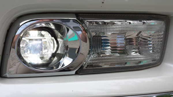

I am considering a set of these Morimoto LED fogs. Several posts have referenced a gap that is "acceptable". I have searched, but have not found any close up after install pics. Would someone mind posting a few pictures of the LED fogs installed, so I can see what the gap looks like in comparison to the stock fog lights? Thanks for any assistance.

Thanks HarryHiram- Not the same fit as factory, but looks okay.

But I disagree, what the picture doesn't show is that the fog light lens actually is almost touch chrome trim, there are no gaps. They look and fit exactly like factory...........at least on 2012, can't speak about 14's, I defer to [MENTION=103267]Saker[/MENTION]

Thanks for the clarification. I am all over them now. If you hadn't taken the time to square me away on the details of the fit, I would have skipped the mod thinking there was too much gap-osis for me. Now it is go time....Appreciate it.
