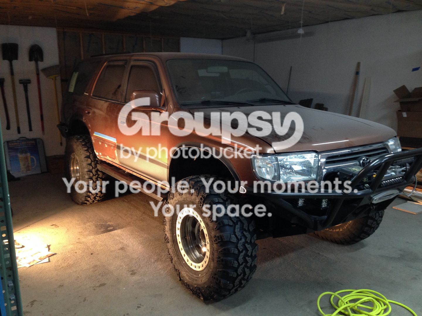

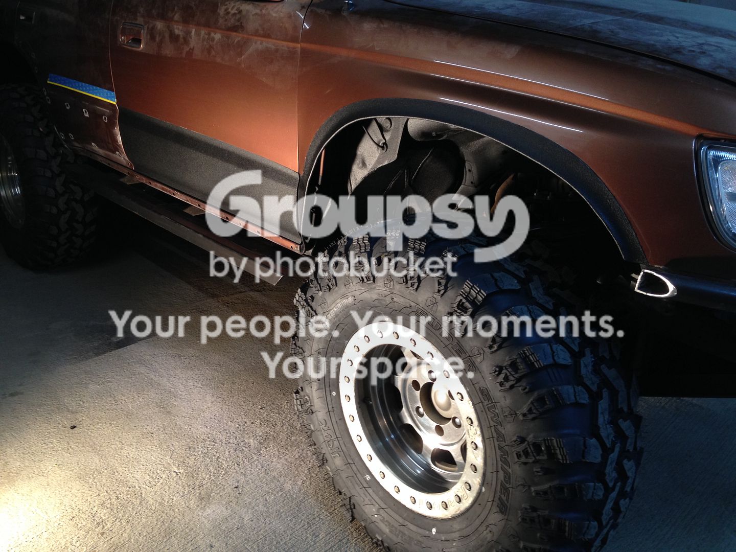

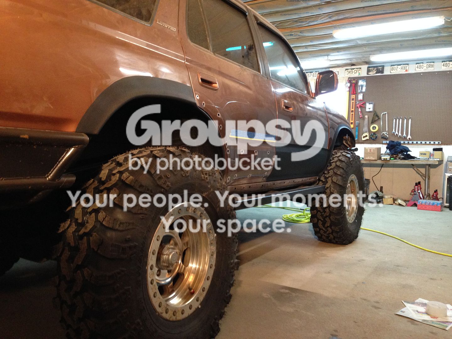

That looks super!! I really like how the door and fenders color contrast to the body. Makes the clearance look even greater.
Not gonna lie, this looks great! I think you showed all the doubters, and obviously have some very good fab skills. Keep it up! It should look super aggressive once it's all done.
Man that's mean lookin!! Well done Dirtco. Very solid work.
Looks good.
Excellent work up to this point. So clean!
Looks great Jeremiah!!!! Top notch job on the front fender.
This is insanely awesome. In case nobody had pointed it out. :thumb3:
Thanks guys! It's been a lot of work, but I'm really happy with how it's turning out.
I really like how the black contrasts the body color. I can't wait to get it all cleaned up and out in the sunlight!

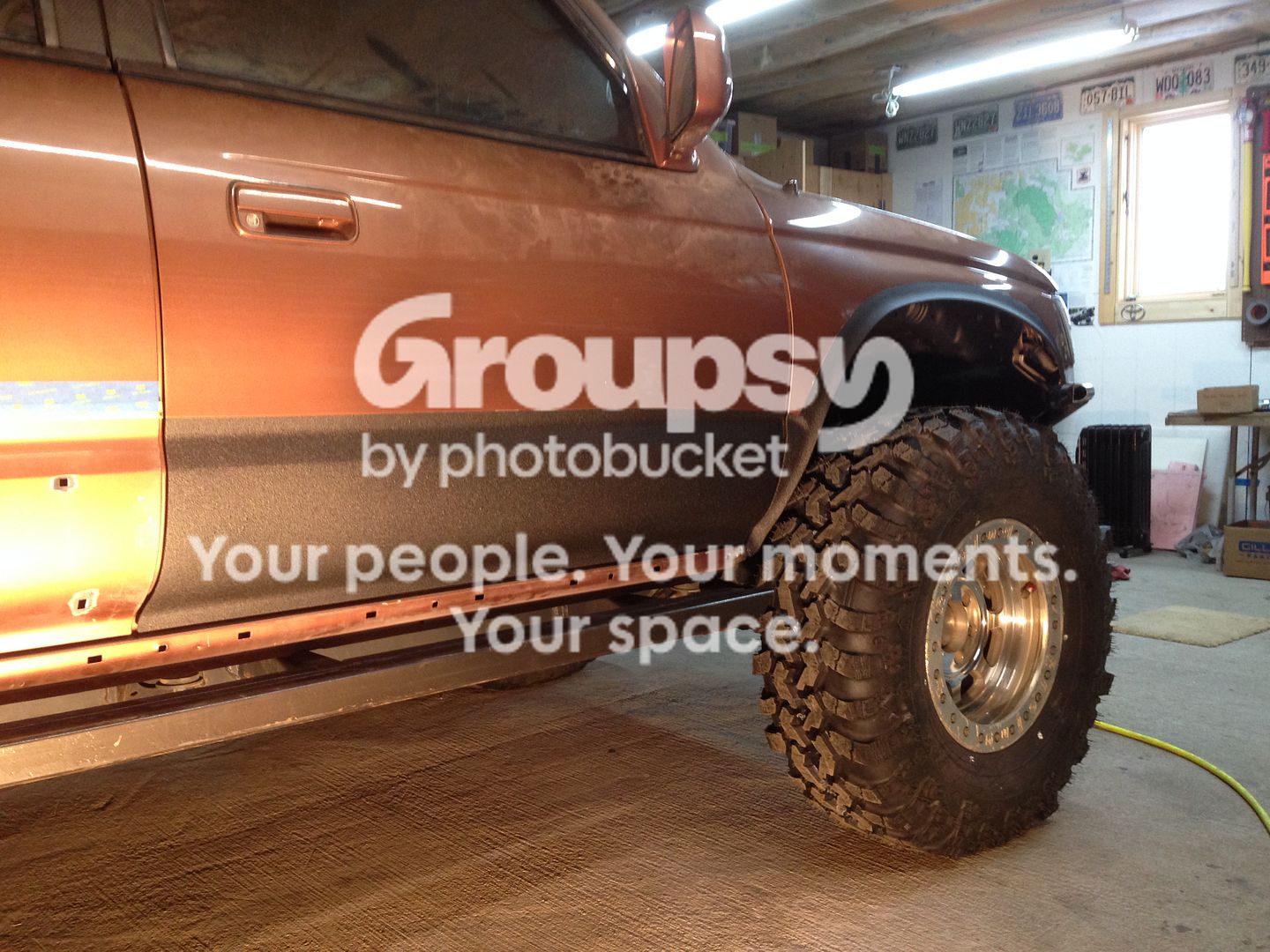

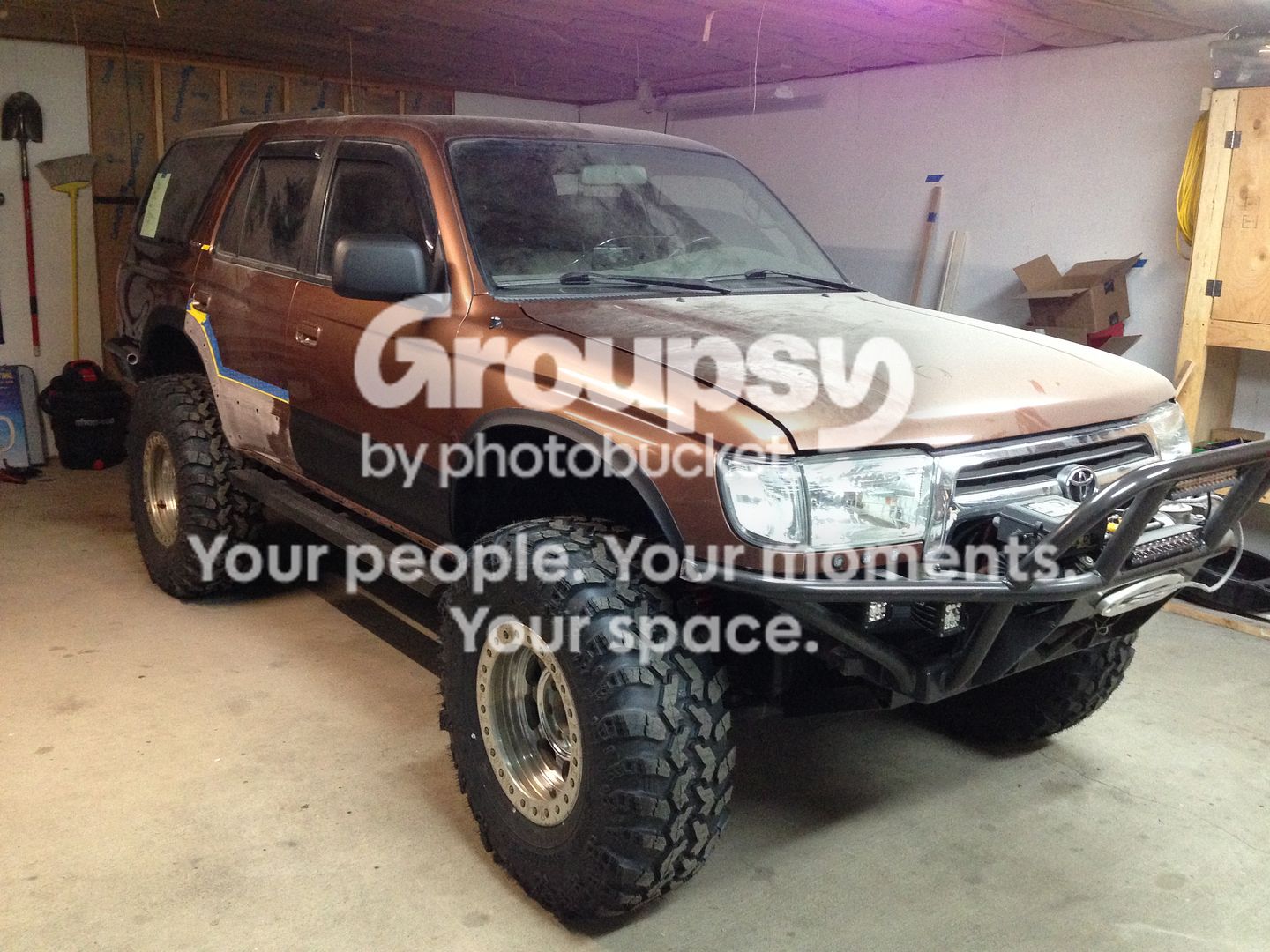

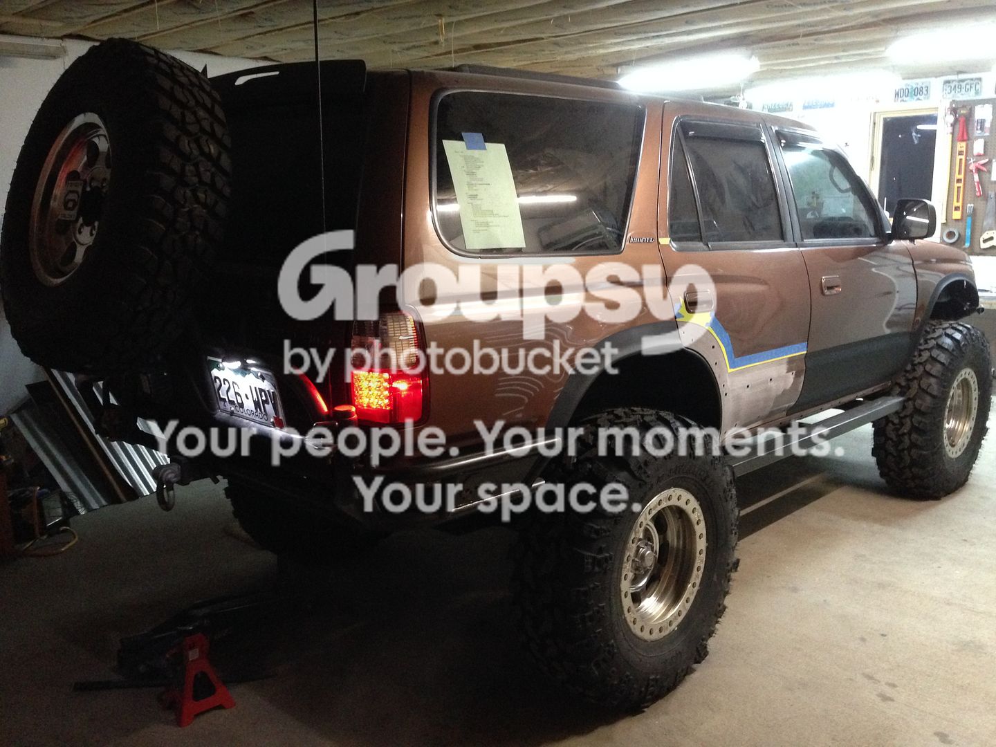

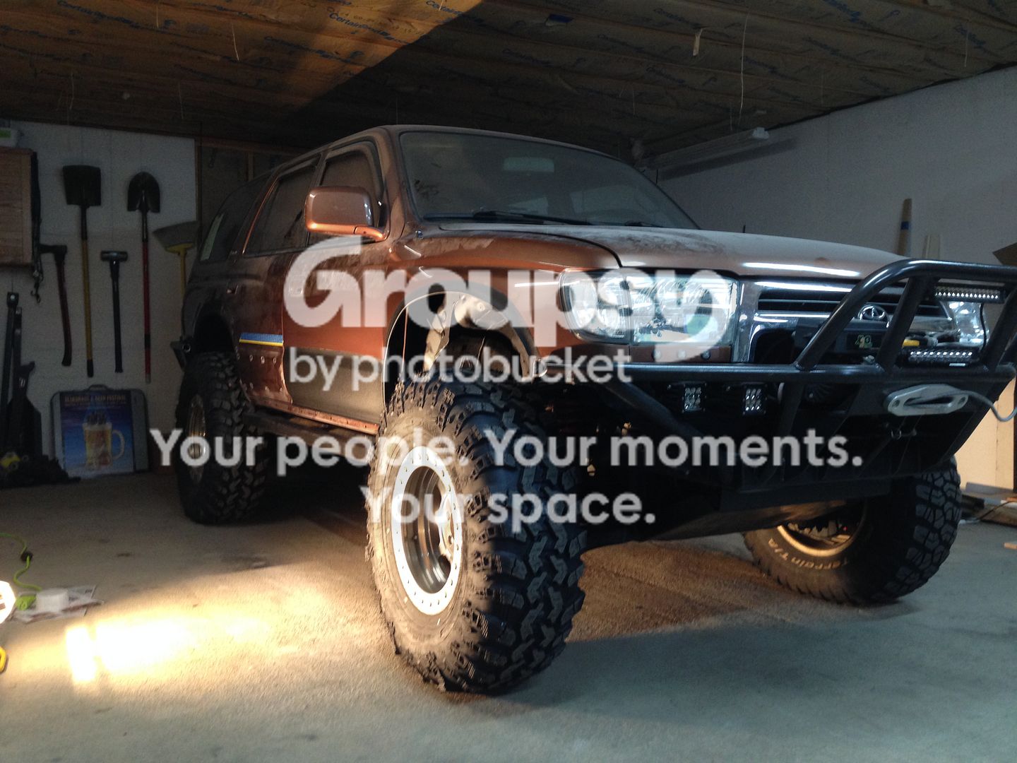

I started tearing into the driver side of the 4Runner (I'm not going to bother posting a whole lot of pictures since it's pretty much the same as what I have already posted).
On a positive note I did manage to get the rest of the tires mounted, I just need to balance them.

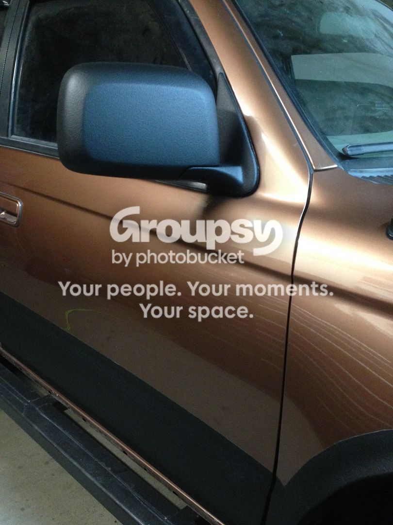

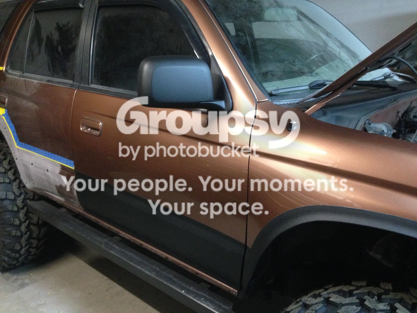

And, I continued on with some smaller projects on the passenger side. As you guys know I broke the side mirror off the driver side door. I ordered a TYC replacement and it came in black primer, so I decided to paint and bed line the passenger mirror to match.

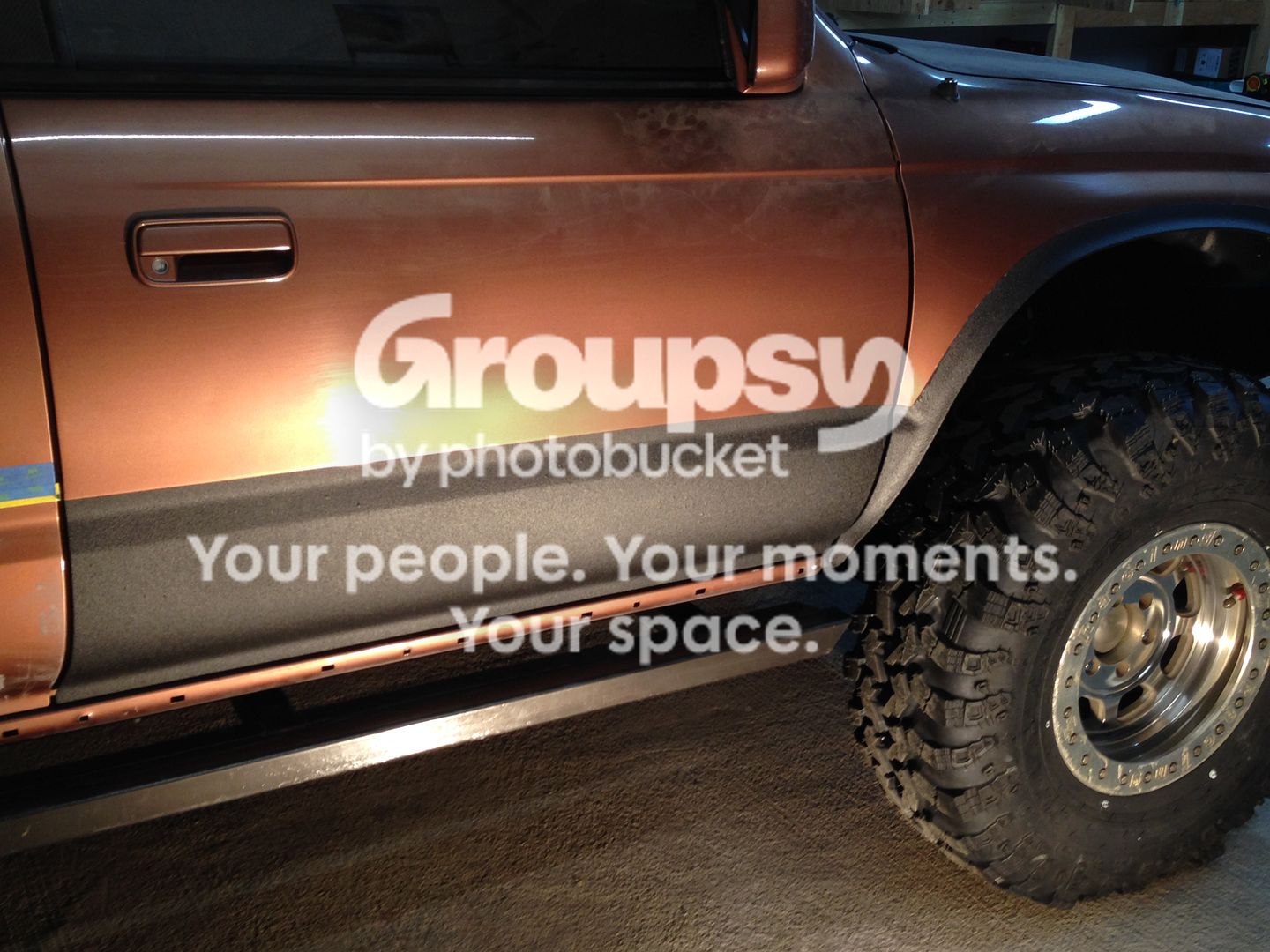

All of the paint on the 4Runner was looking a little rough after last summer, so I buffed out all the passenger side panels (except the rear door that I'm still working on).

Looking great so far...one thing i'd do though, is even out the width of the bedlined portion on the front fenders with the rear door/quarter panel. But that's me.:pop2: always an inspiration!
Thanks man! That's why I'm taking so many pictures and documenting everything, I figure it will be useful to someone out there. It's not for the faint of heart, but I now will be able to run up to a 37" tall tire with zero rubbing.
I agree with your comment about the bedlined front fenders, and rear fenders. It's tricky because the front fenders have been opened up more that the rear, I followed the body lines and that led to the front having a smaller section width. I couldn't drop the rear fender down anymore because that's where the flair was and the paint is in rough shape from it rubbing around on it.
It's easy to add more bedliner to the front fender and bring the line up a bit, but I want to get it outside in the sun shine and look at if from a distance before I make up my mind.
