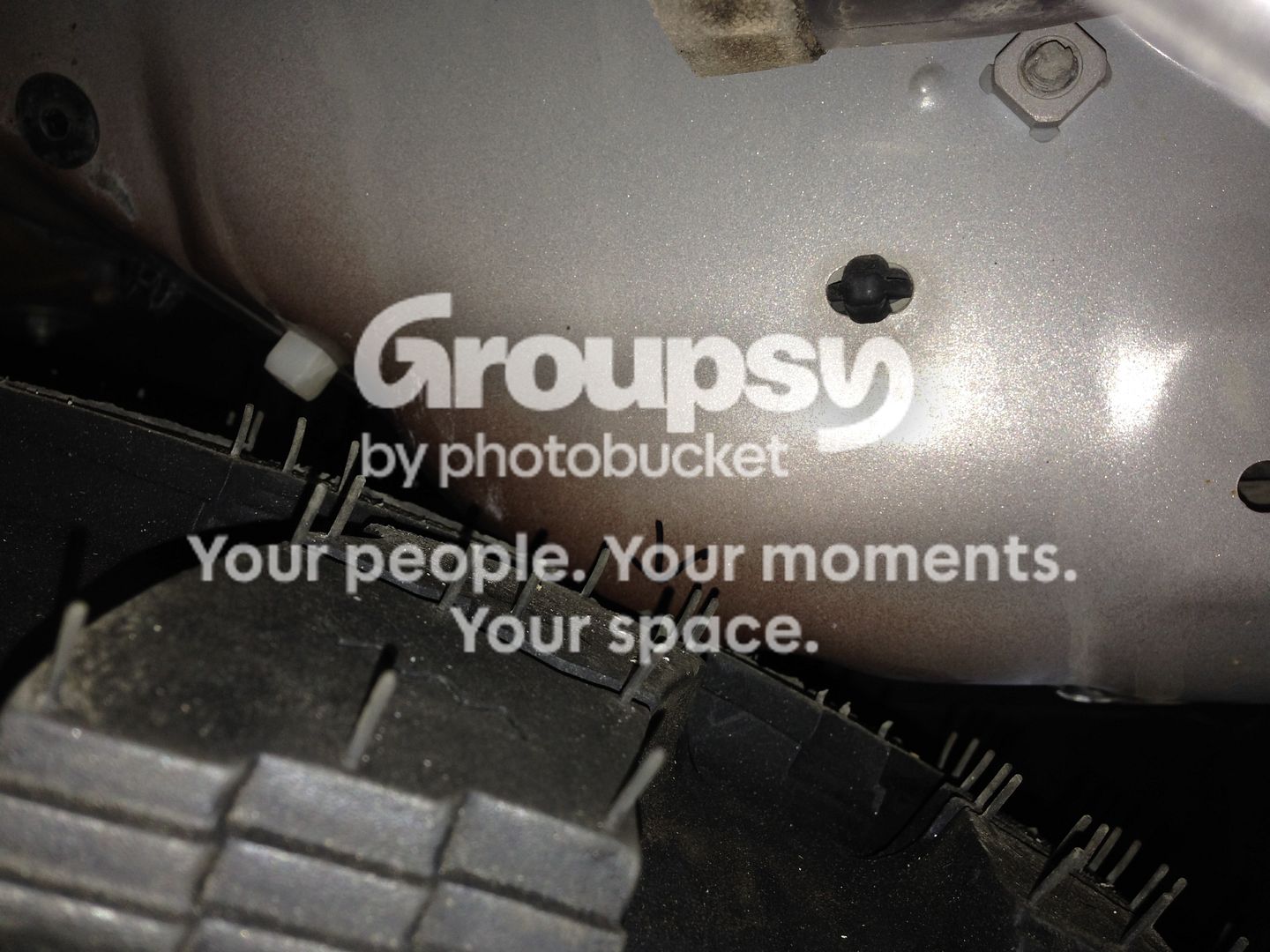

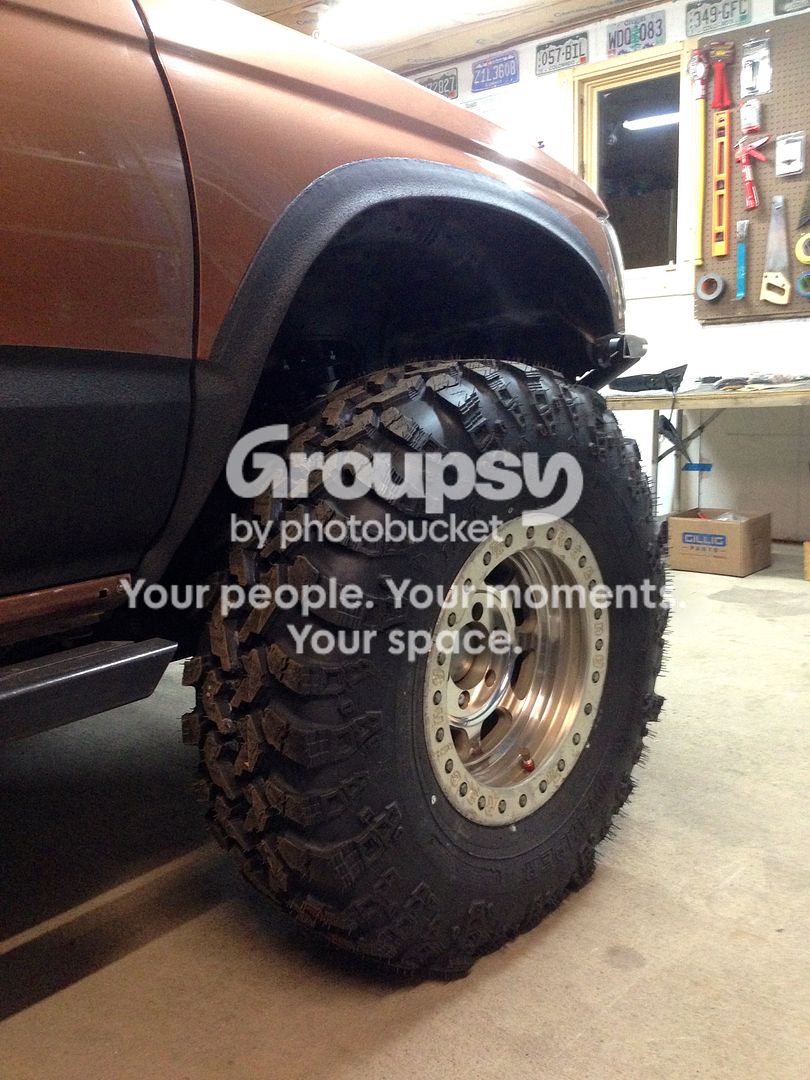

It depends on what size tire you run. My 35's rubbed the inner fender even with the 1" body lift. I now have Timbren bumpstops that should help a little, but it's still going to rub. Without the 1" body lift you would have to limit your up travel another inch, or deal with more rubbing. I trimmed the support out and made it smooth so I wouldn't tear up a tire.
Like Mr.Rick said, I had to ditch the wiper fluid tank to fit the 35's.

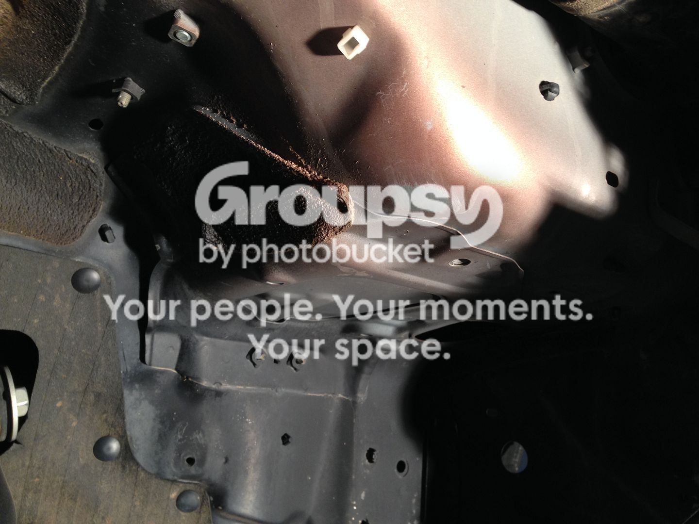

I got most of the driver side cut (except the firewall), I just need to start welding in the round rod and tubing.

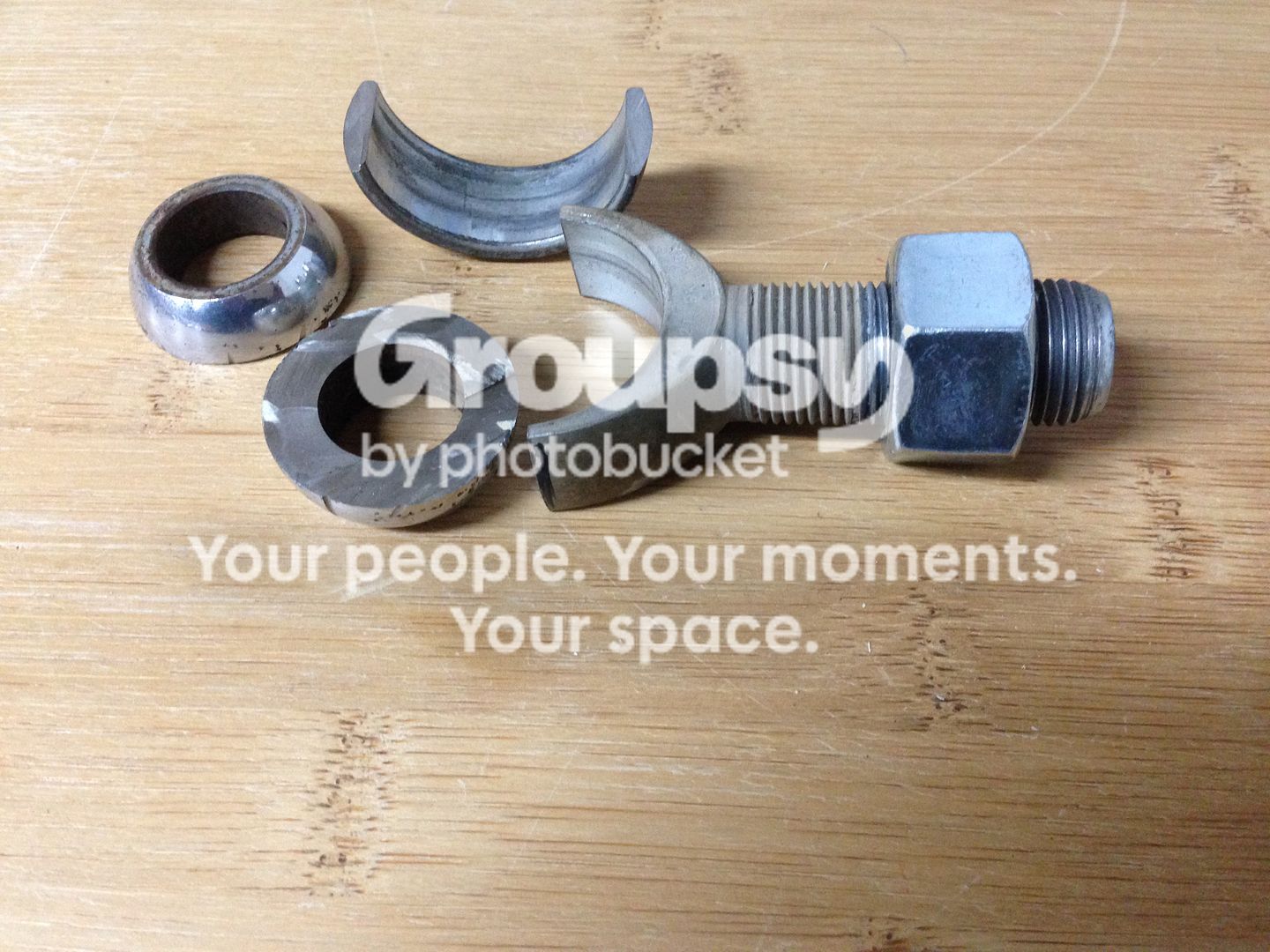

I installed the new hiem joints for the Toytec UCA’s. The old joints were shot; I can’t believe how loose they were. Hopefully they won’t wear so fast now that the 4Runner isn’t my daily driver, but it wouldn’t surprise me if it’s a yearly maintenance item.
And to anyone running these; make sure you use a good amount of anti-seize on the threads and the misalignment spacers. My spacers wouldn’t come out, I had to cut the joint apart and use a press to remove them.

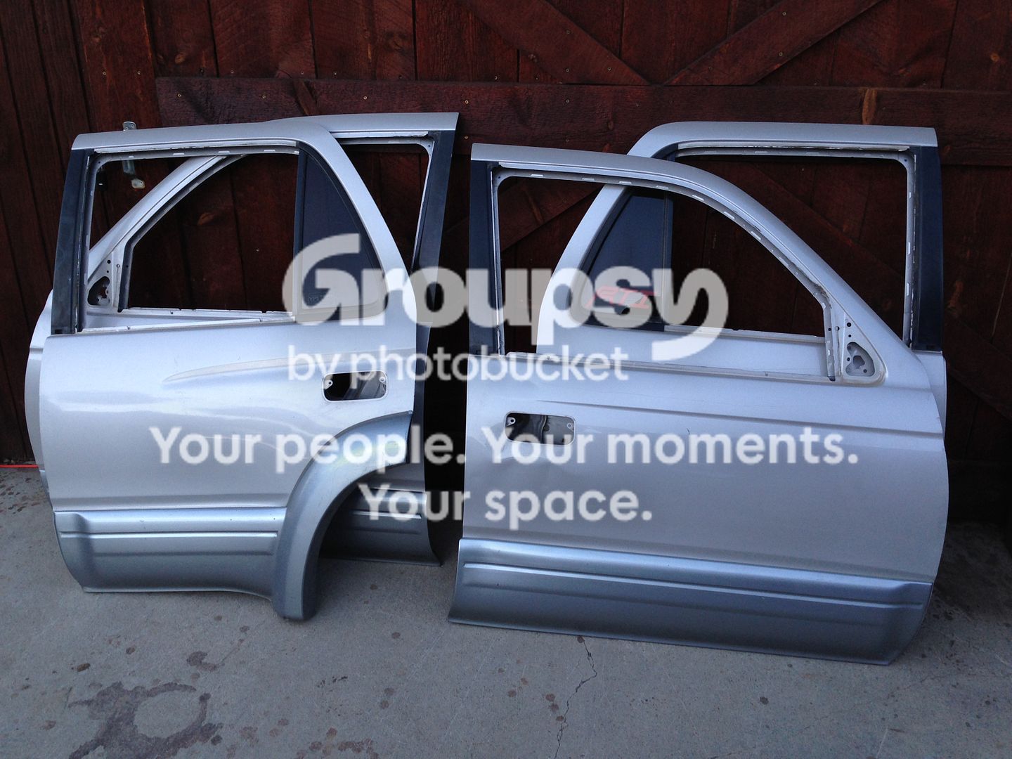

And thanks to Jeff ( [MENTION=21950]sn0wrunner[/MENTION] ) I have another set of doors. He gave me a killer deal, and even delivered them to me! I won’t have time to paint and install them this season, but at least I have them for down the road.

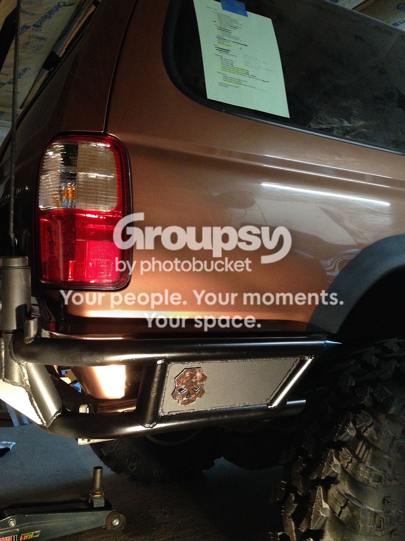

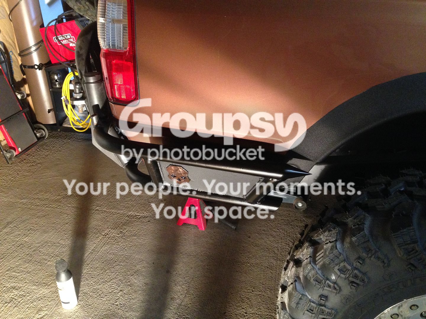

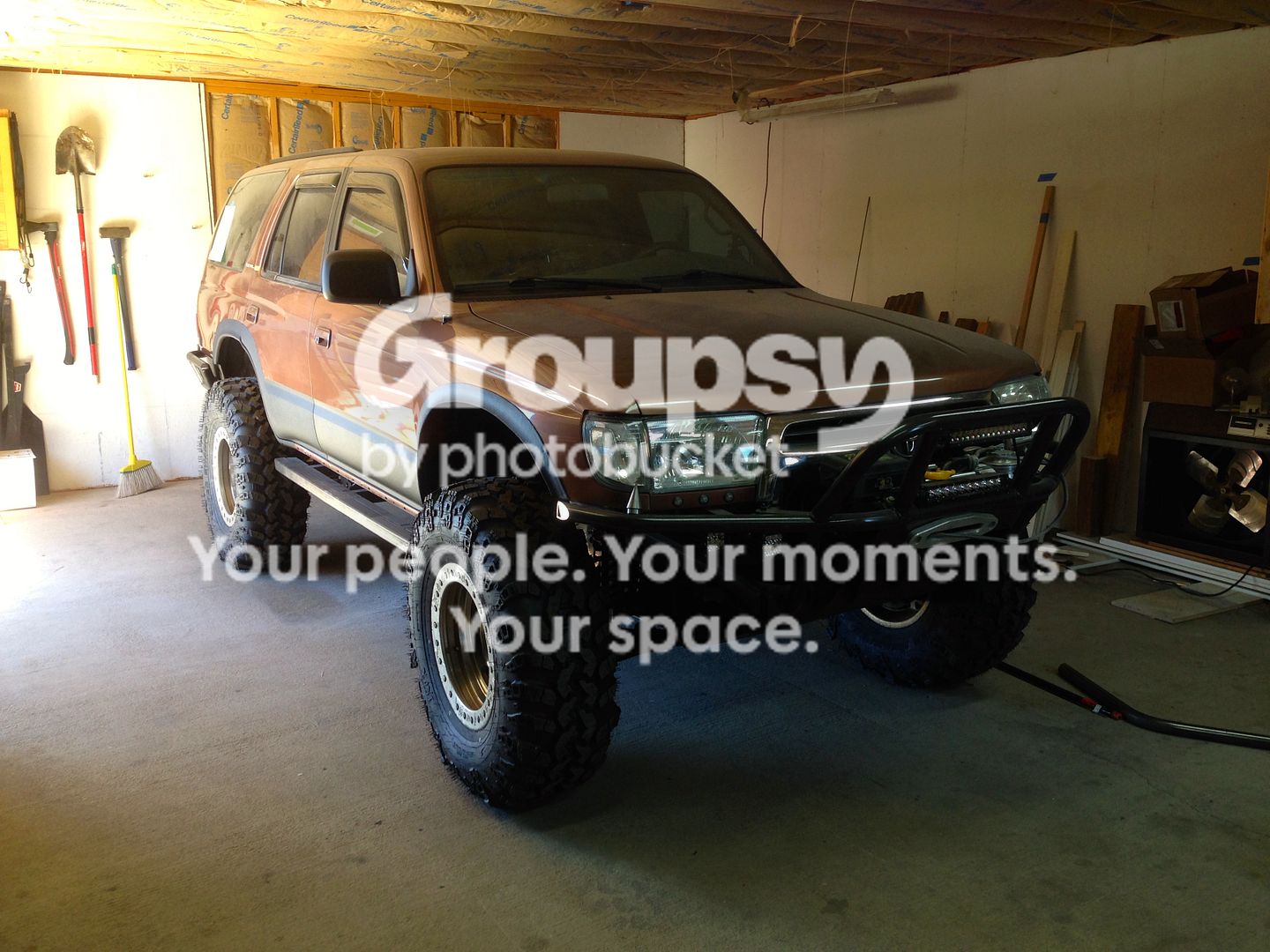

The rear bumper was clearanced for the flairs, so I trimmed the end off and installed a spike to match the spare tire carrier. All the armor will be getting painted satin black to match the bedliner, as the hammered black paint I used before was more of a dark grey color.
I also brought up the bodyline on the front fender, it was bugging me and I figured now was the time to do it.

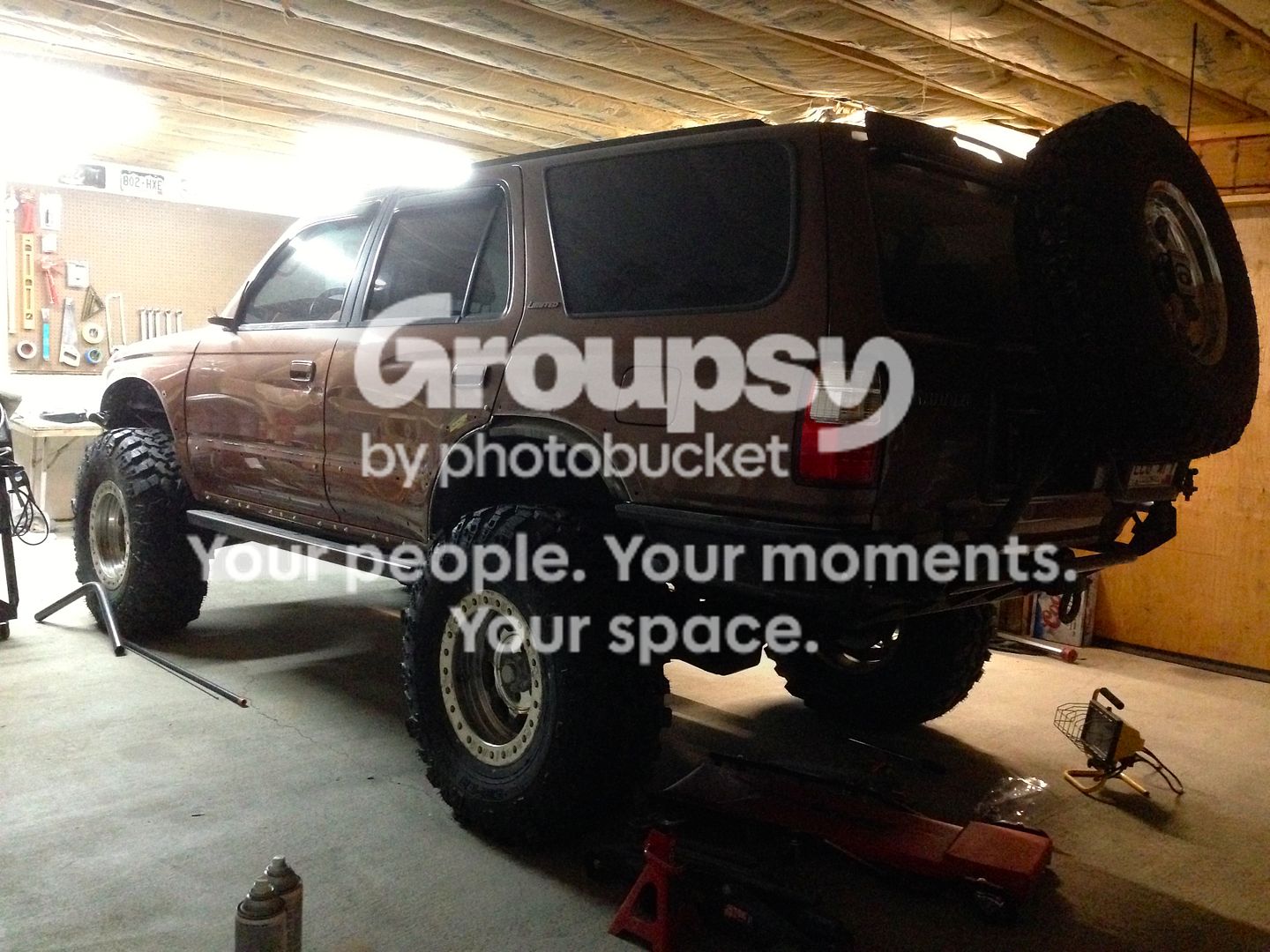

And I finally got the rear door holes filled and painted. So the whole passenger side is now painted (except the rocker panel). I'm really happy with how it's turning out! :D
