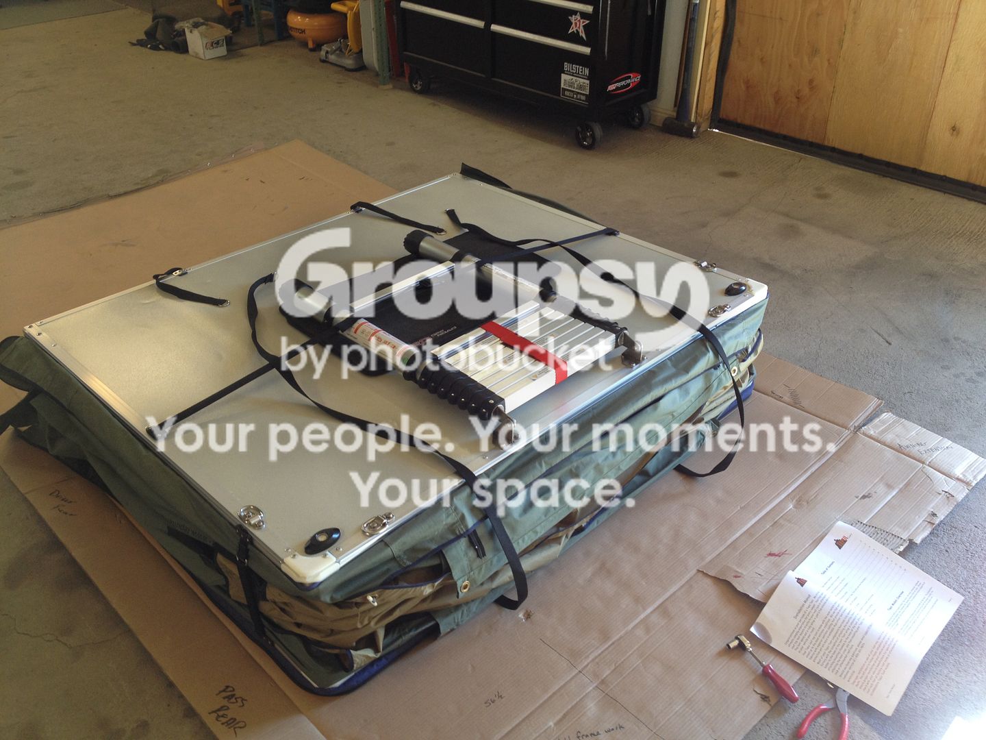

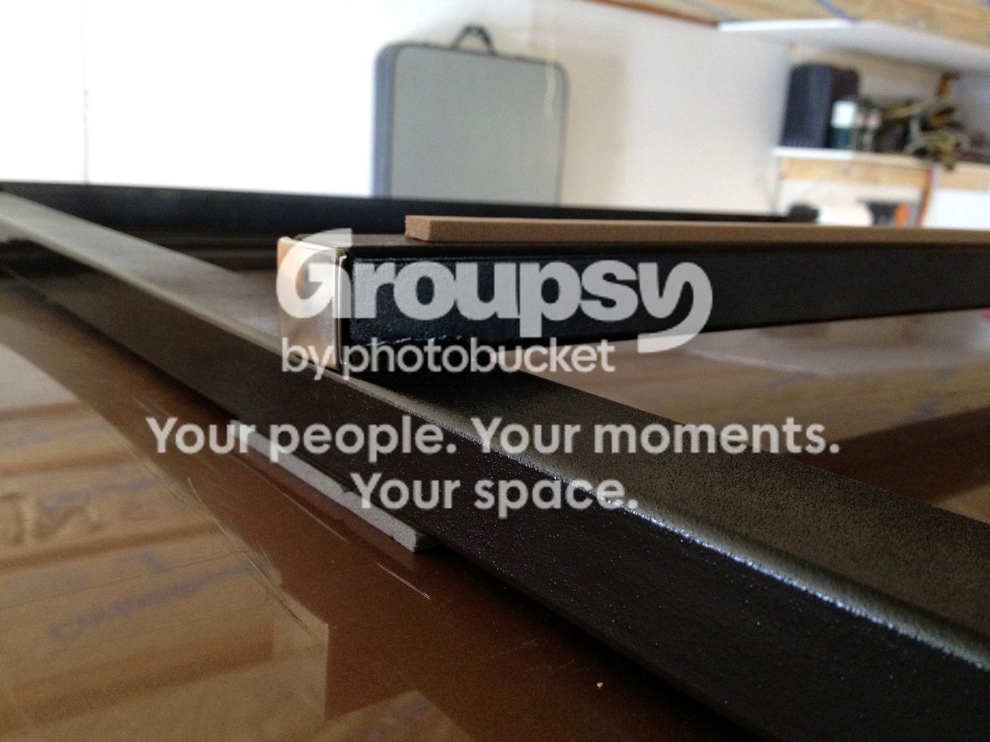

So I have the tent, but I needed a way to attach it to the roof. I looked at a ton of rack options, but none of them really fit my needs. I don't plan on running a rack unless the tent is on the 4Runner, so they just added extra weight. I almost ordered the small Baja Rack, but it was super expensive for what your getting (especially when you figure in shipping). The next option was a Thule rack, I actually ordered the system but once I got it I realized it sat way too tall for my liking, and the attachment of the feet to the rails wasn't very robust. So I returned it and decided to build my own.
My needs were simple; I needed a way to attach the tent (and my awning) to the roof, it had to be removable, strong, low profile, light, and cheap. Okay, maybe my list wasn't all that simple!

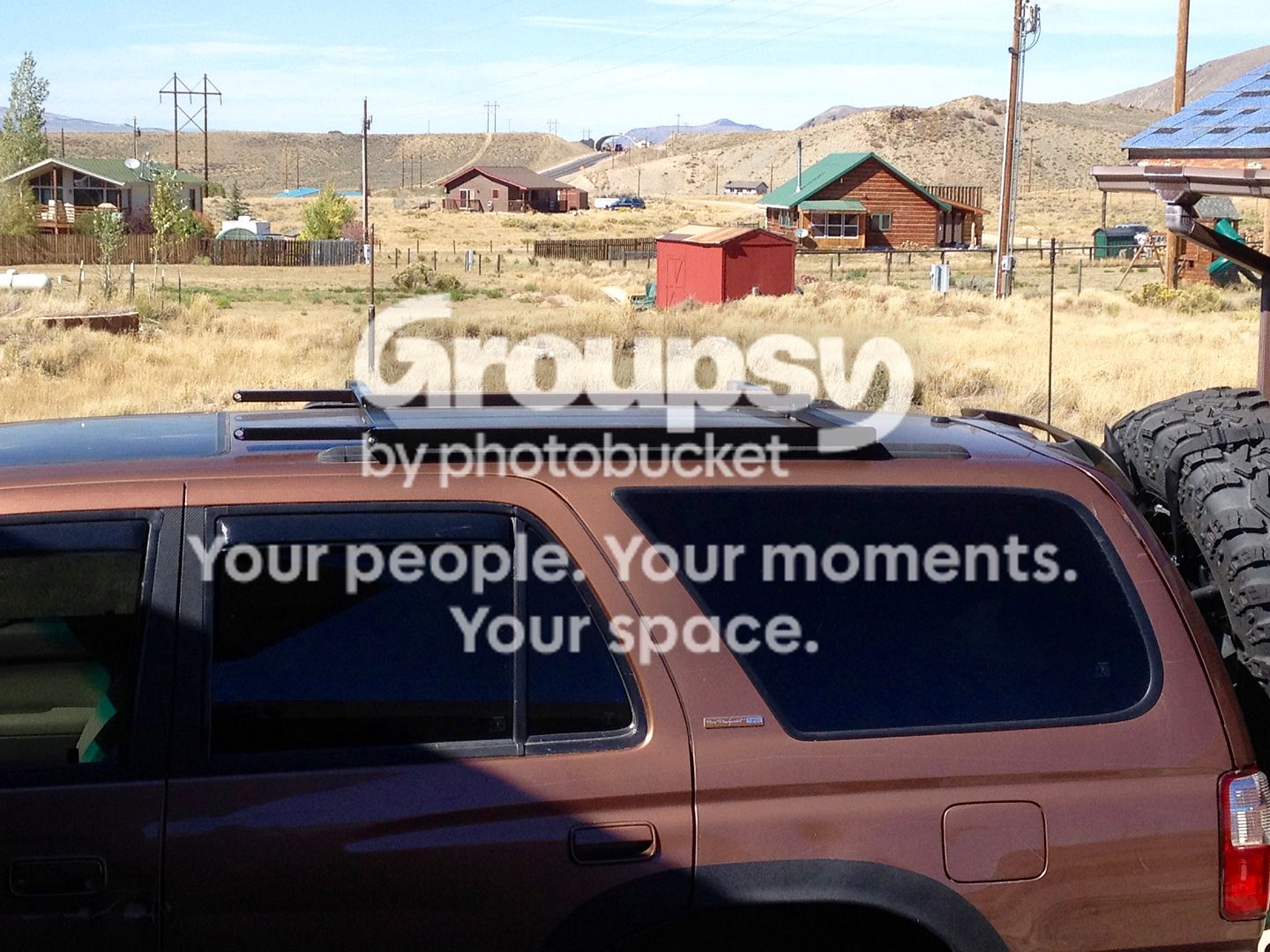

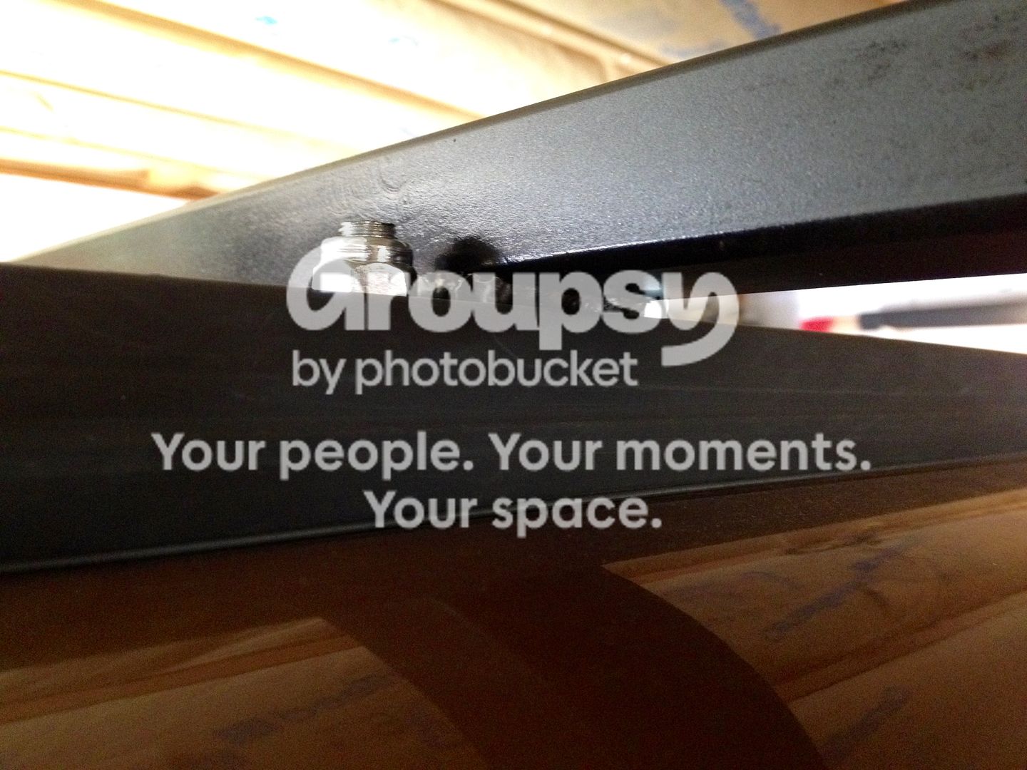

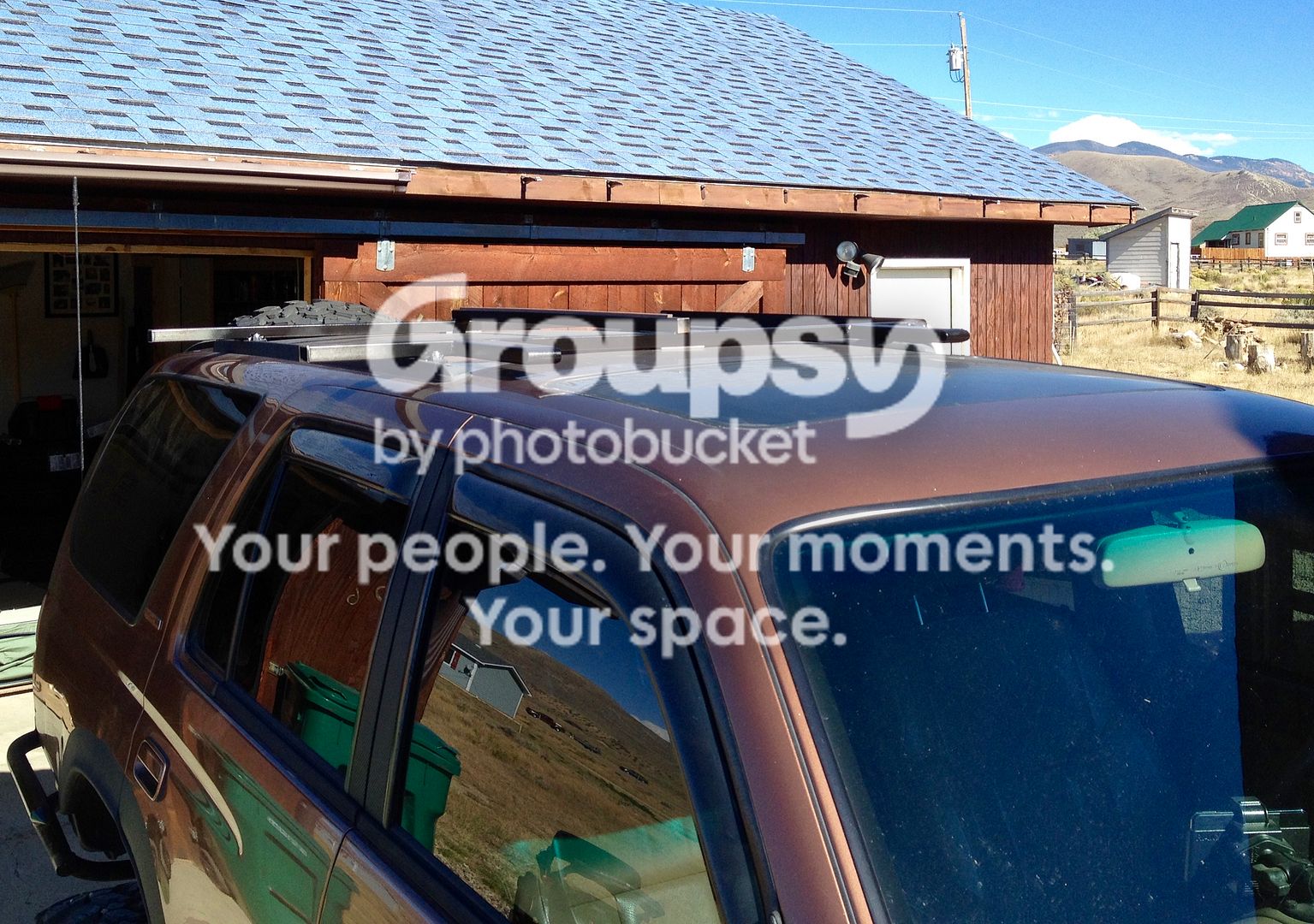

I started with some 1x1.5" tubing I had in the garage, this acted as the rails for the rack. Then I built the "feet" that connect it to the factory rails. The lower plates have bolts welded to the under side and the rack drops on top of them.
I added another 1x1" piece of tubing front to back that acts as a 3rd rail for the tent, this adds extra strength to both the tent and the rack. Being that I have the "Sky" model I should be able to open the top and stand up in the tent without the floor bowing.
On the driver side I welded a piece of angle steel to tie the rails together and fill the gap between the tent and factory rails. On the passenger side the rails extend out, and thats where the awning will attach. The forward bars line up with the tent rails for extra support, and have another purpose that I'll get into later. I was able to use steel I had laying around, so my out of pocket expensive was around $20, not bad!

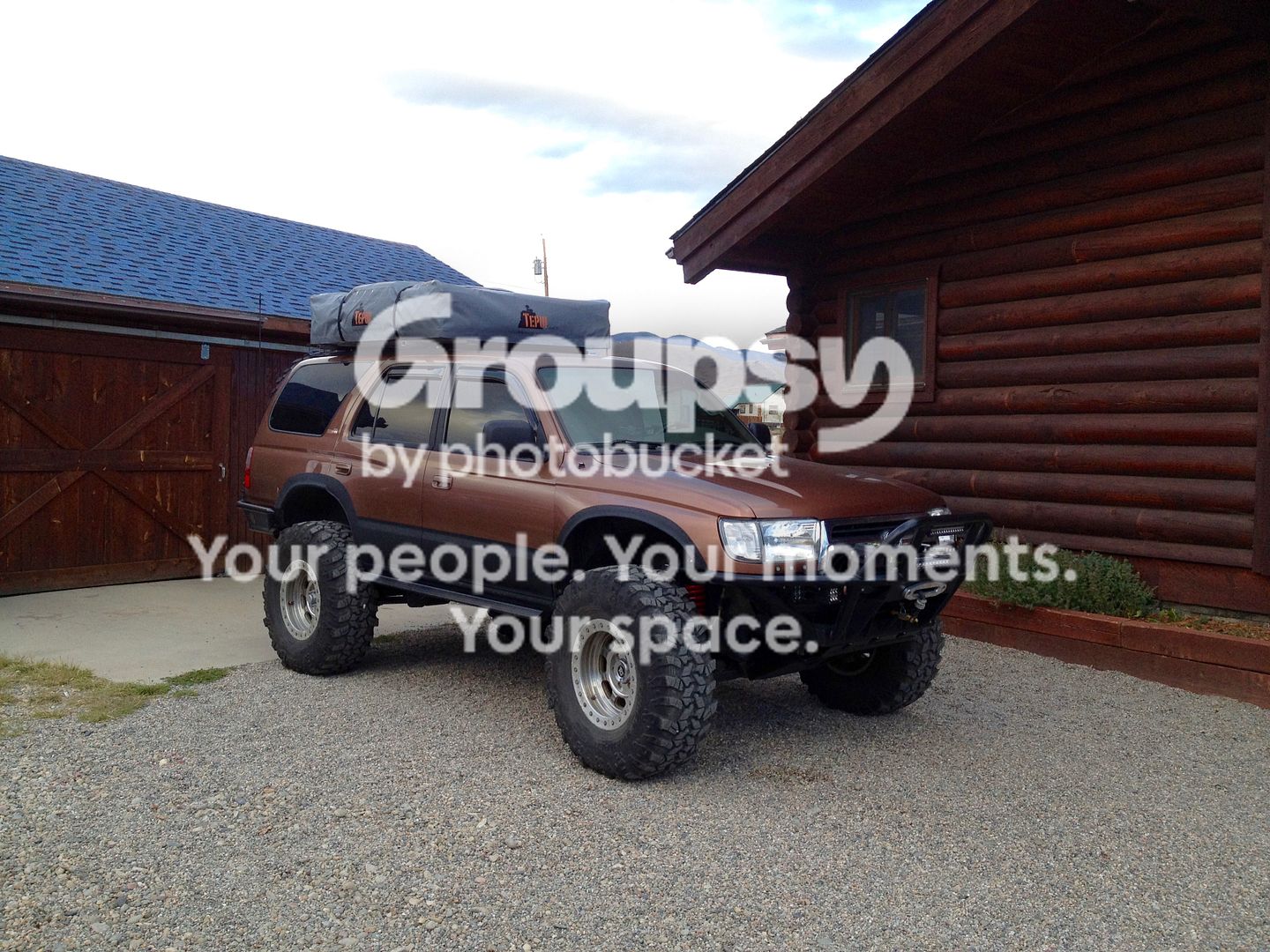

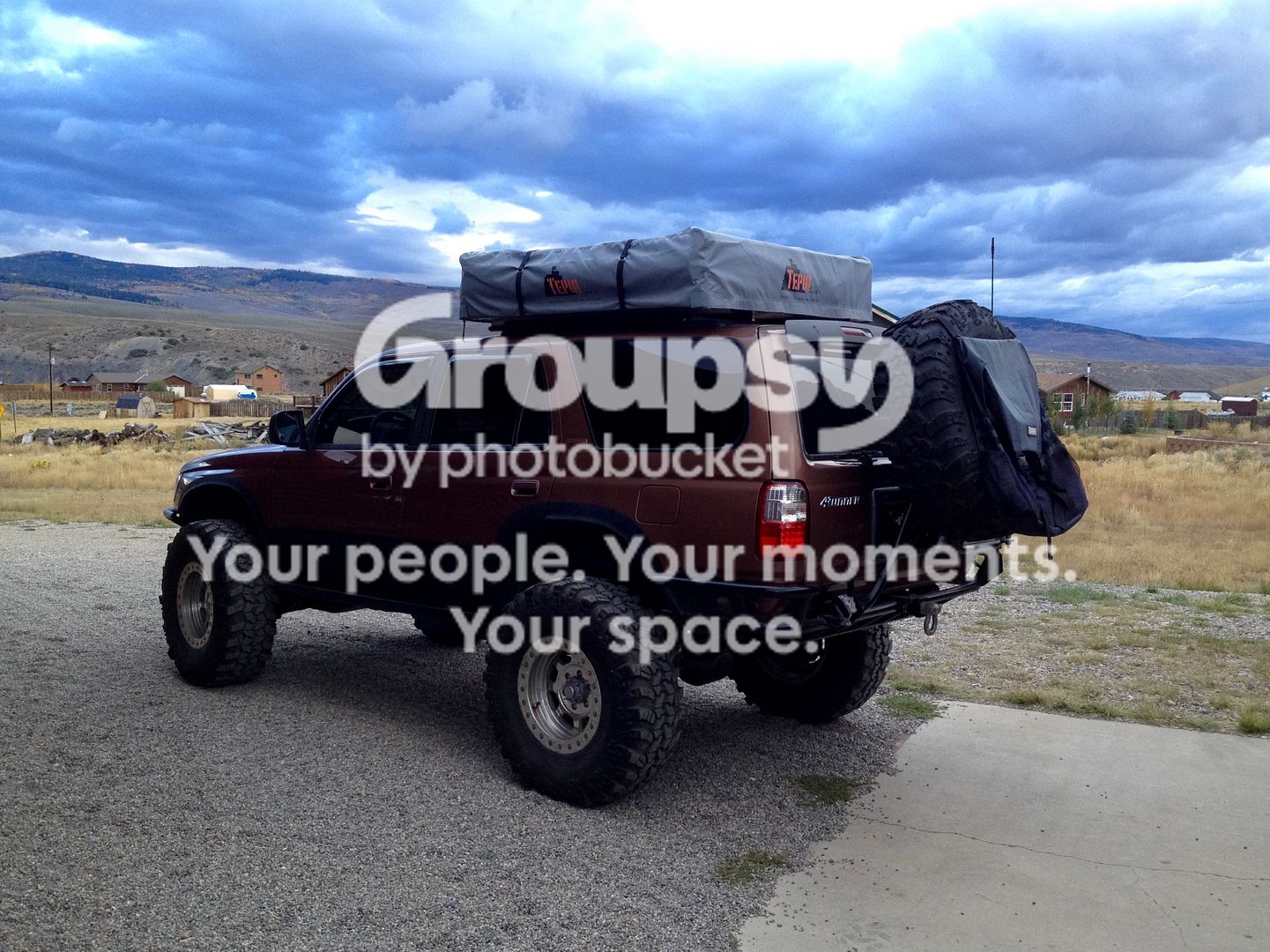

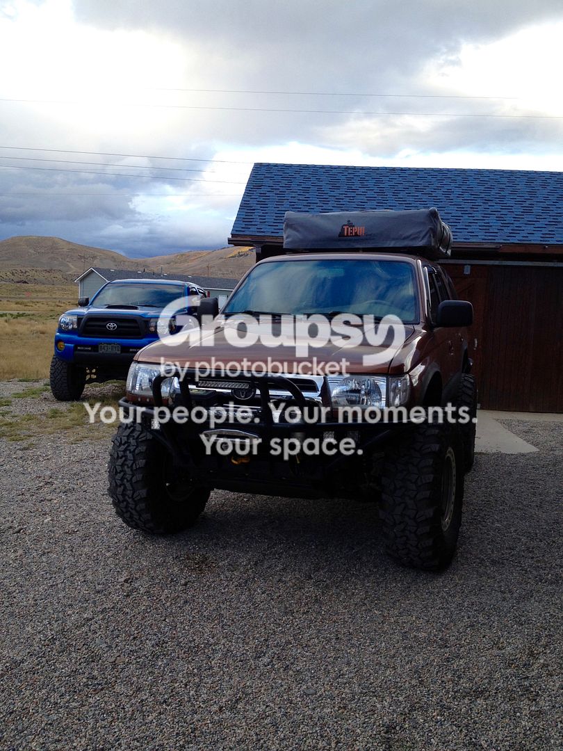

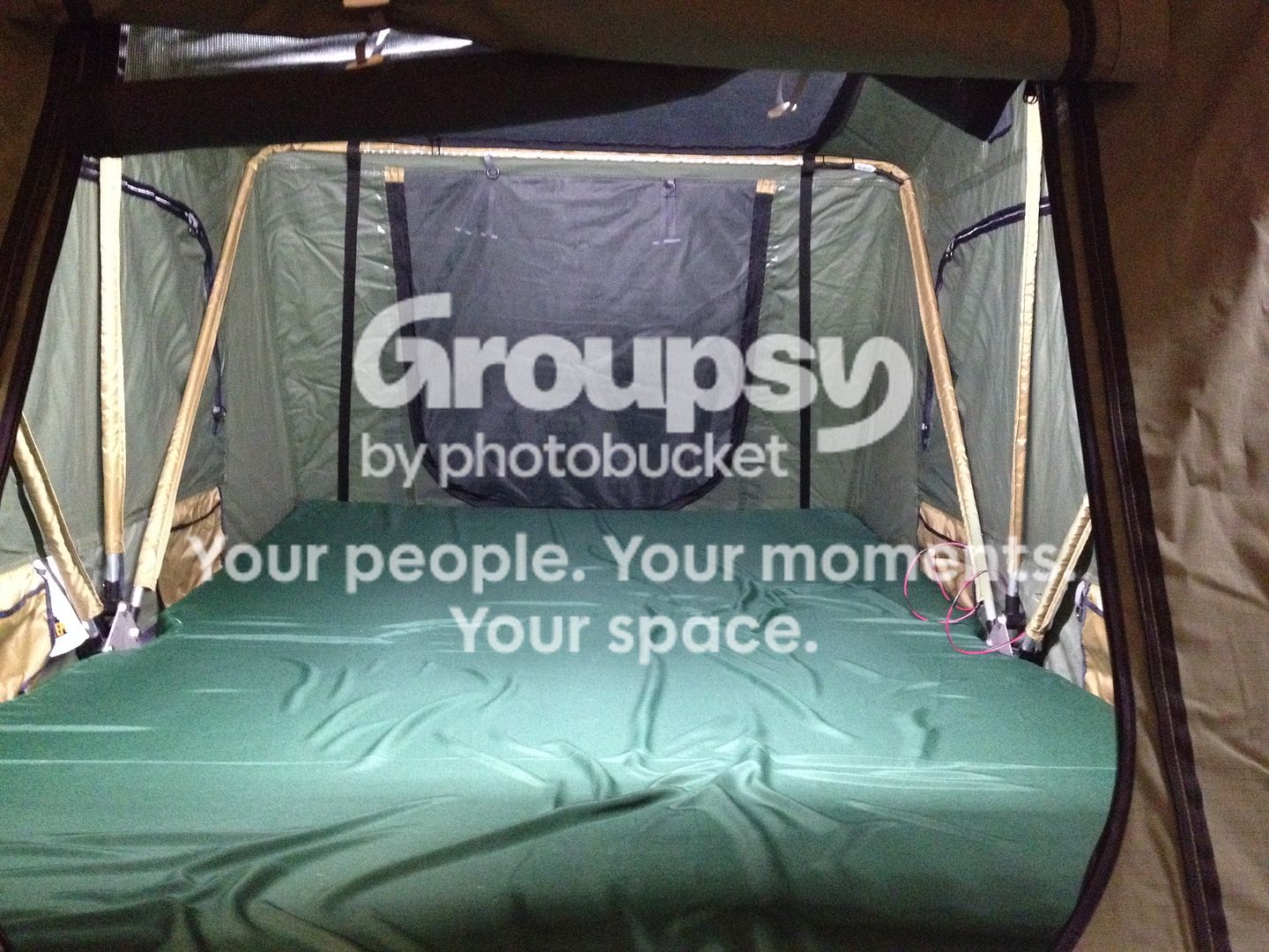

And here it is with the tent installed, it's taking a little time to get used to, but after driving it for a couple days it handles better than I expected it to. We'll see how it does once I get some dirt under the tires!

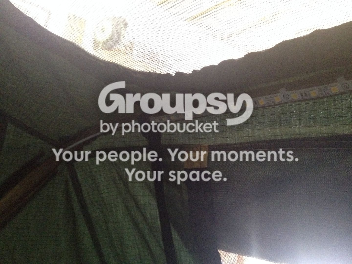

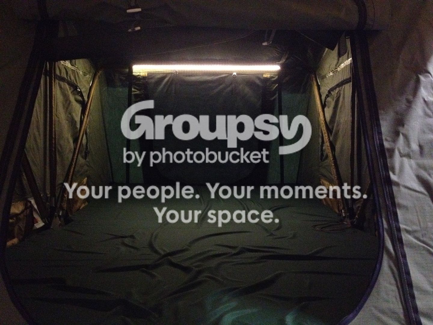

And here are some of the modifications I've started on the tent. I started by installing LED strip lighting, the first side (where my pillows are) is soft white and has a dimmer switch. This makes for a nice soft light and there will be a switch in the tent to turn it on.
On the other side of the tent, above the ladder, is another light strip. This one is natural white and does not have a dimmer. This is for setting up camp, getting unpacked, etc. This will be controlled via a remote key fob, that way I can turn it on from anywhere around the truck.

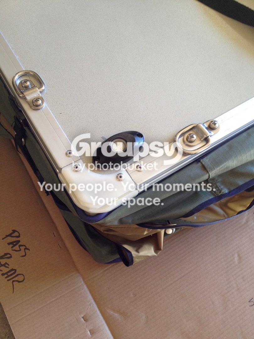

In addition to the above lights I have led light pods mounted under the base of the tent, these light up the ladder area and are on the same circuit as the above lights.

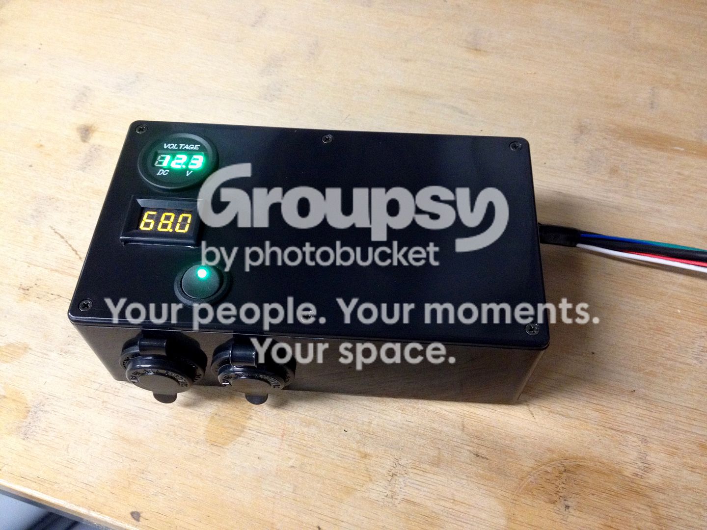

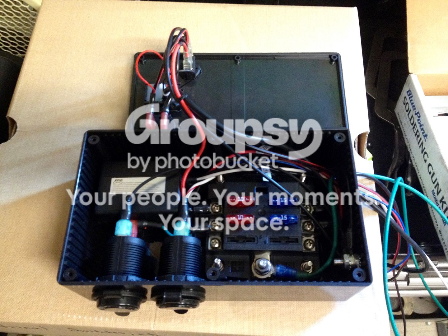

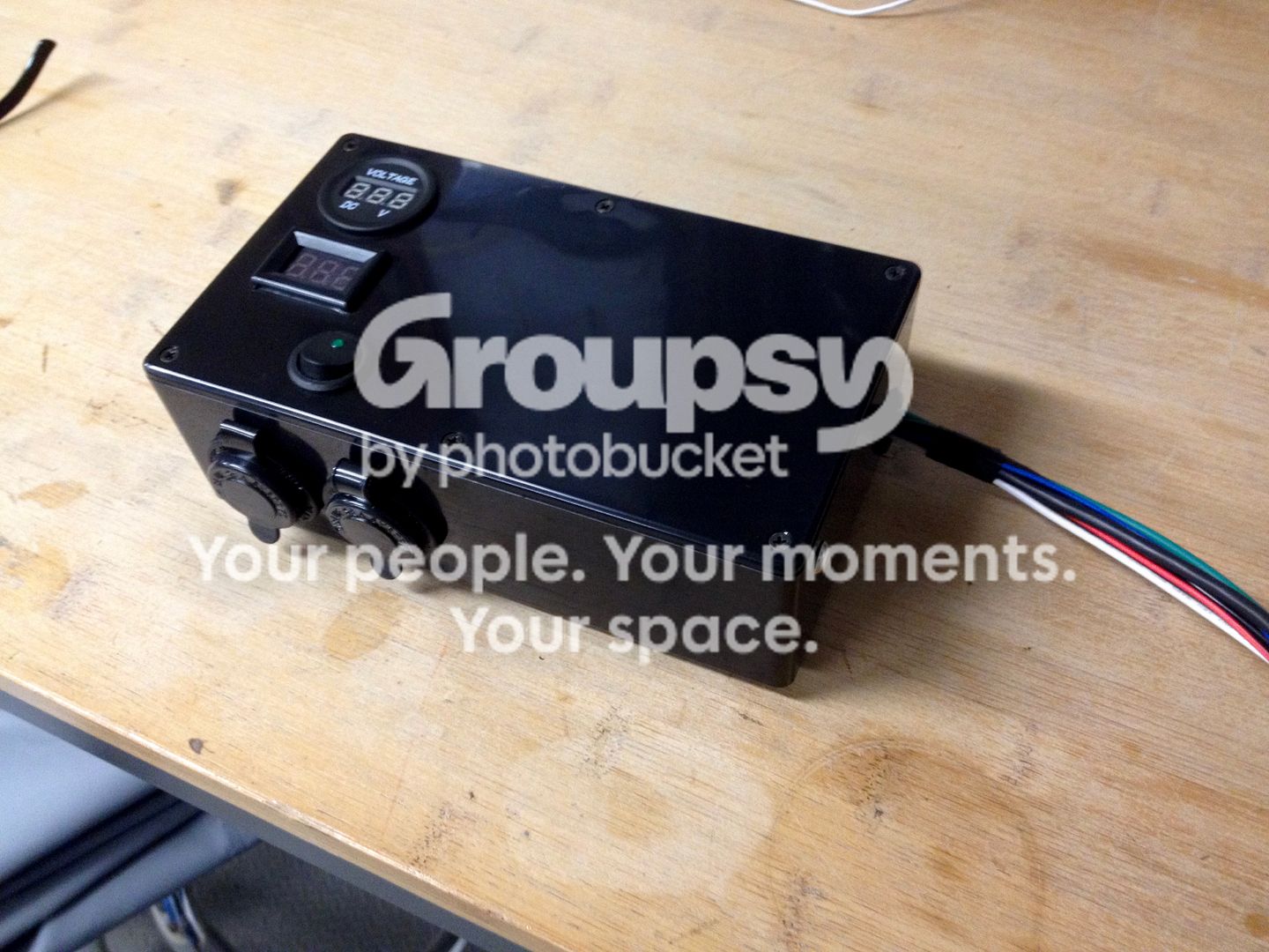

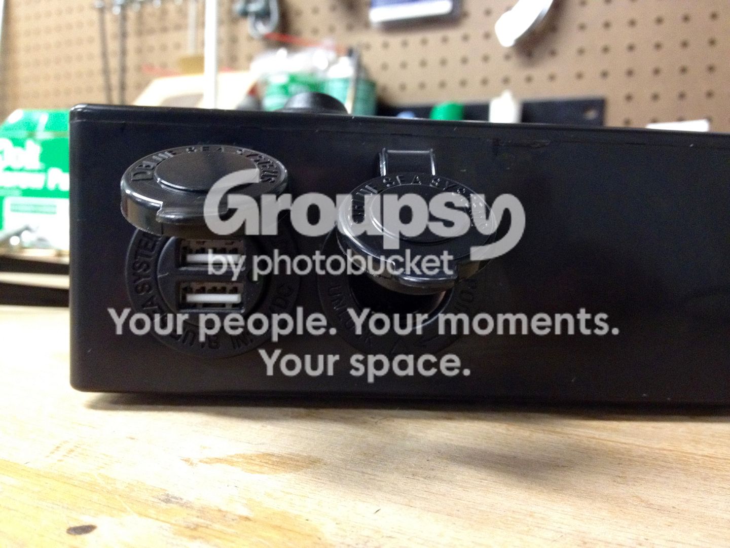

I also wanted 12 volt power in the tent for charging my phone and plugging in my 12 volt electric blanket. I bought a small project box to use as a "control panel", I installed a Blue Sea 12 volt port, along with a dual USB outlet, it also houses the control box for the remote lights. In addition to the above items I added a digital voltage meter and outside temperature that come on with the interior tent lights.

i like the remote box with temp gauge.
I have a few similar LED light pods installed in the back and as front door lights in my 94. Outstanding light output and semi cheap to purchase.
