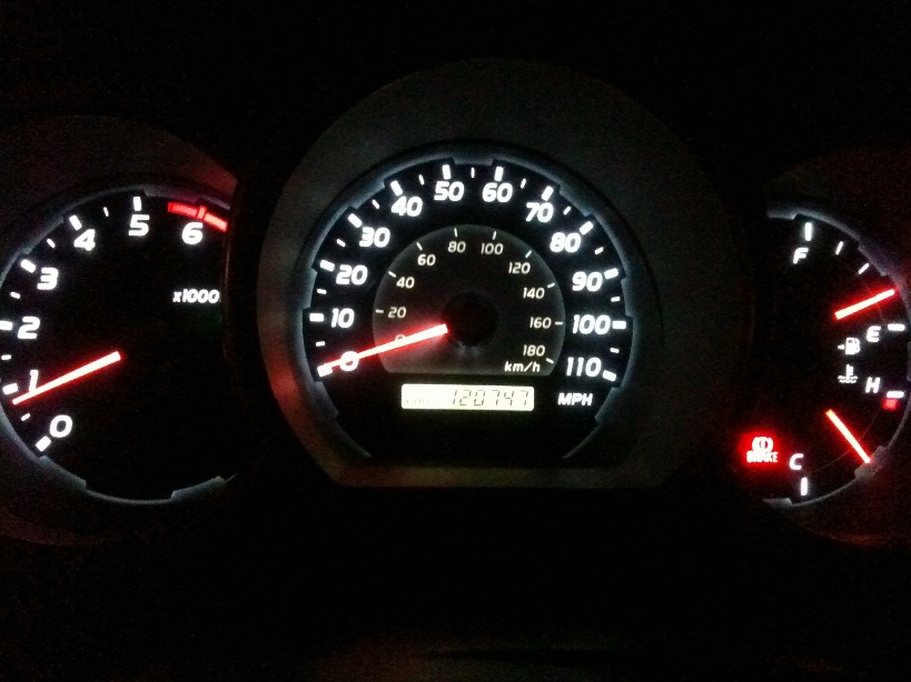

this weekend had done with mine
just changed yellow LED's for whites
