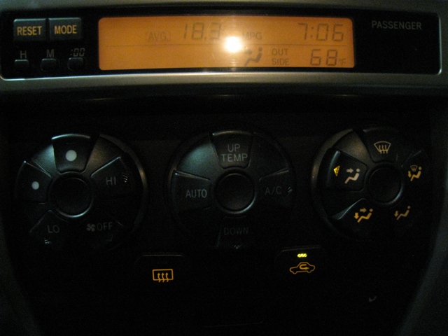

Sorry, I dont have a photo but it's the HVAC control for Fan speed and Thermostat control.

oh sorry, i thought i could not post the photo but fortunately i miraculously made it. hehehe.
