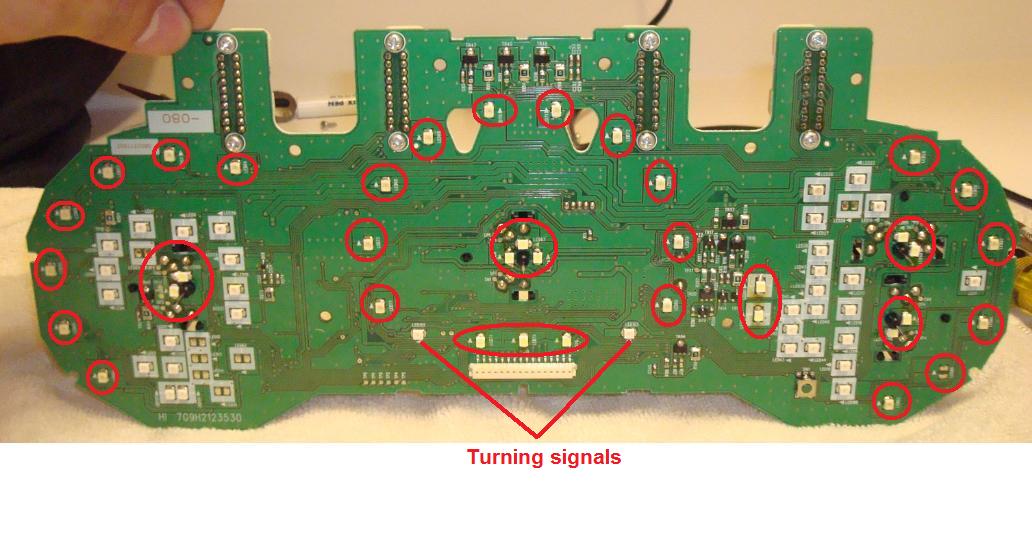

jerrysc99, no problem. can you take a pics of the board? like to see the difference between the sport/SR5 and the limited.

Sure no problem, i'll take a pic when I receive the leds and re-open the gauge. Oh and by the way, there is another way to get to the leds instead of removing the black face gauge. I had the hardest time trying to remove the black face gauge and was afraid of damaging it so I did it this way. I'm curios to know how you successfully remove the black face gauage without bending it getting it damage. First you have to remove the needles off course. Than flip it over, remove two screws, than seperate the board from the face.

Darkie per your request, here is the picture of the 4runner limited board and I finally got it done! Thanks for all your quick responses. The picture is grainy but looks a lot better in the car.
Thanks!! Great job! looks really good! Let me know how the switches and HVAC goes.

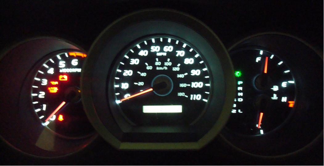

Thanks for putting together the guide. I used it a couple of days ago to change out my instrument lights. The whole process went pretty smoothly, and I am very happy with the results. I still can't find a good reason why Toyota went with the amber/orange lights originally. The white dash lights look 10x better, in my opinion.
For anyone else thinking about performing this mod, I would definitely recommend it.
