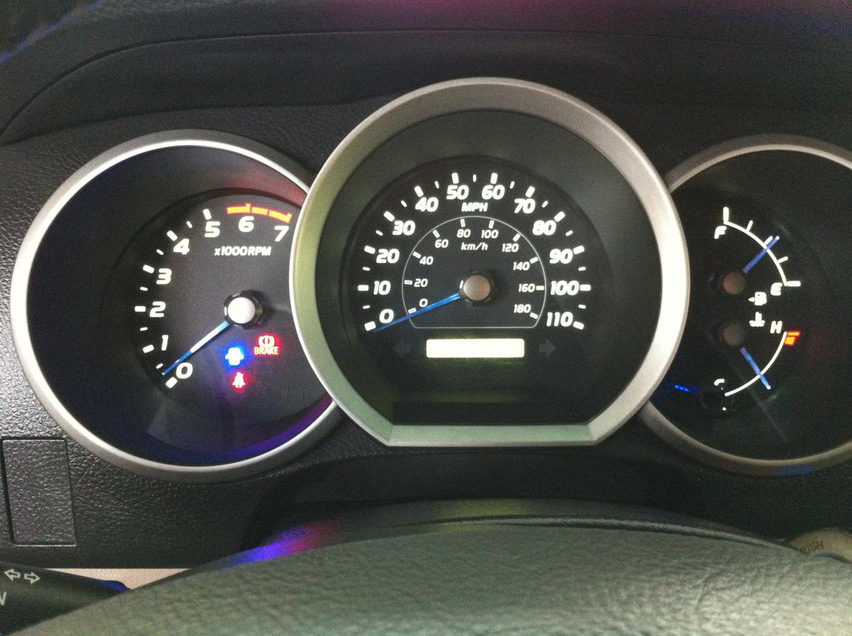

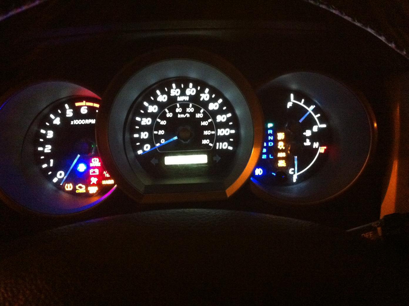

NOW for what you've all been waiting for (or at least CookieRoe and snowbrdr033 have been waiting for); White and blue Limited gauges!
Decided to go from the blue lights on my gauges to white then went with blue needles, still working on the HAVC (need more LEDs). I also changed the color of a few of the icons (door/fogs/gear selection in blue)
The needles look a darker blue than the pic's show.

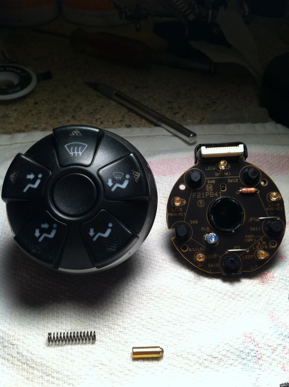

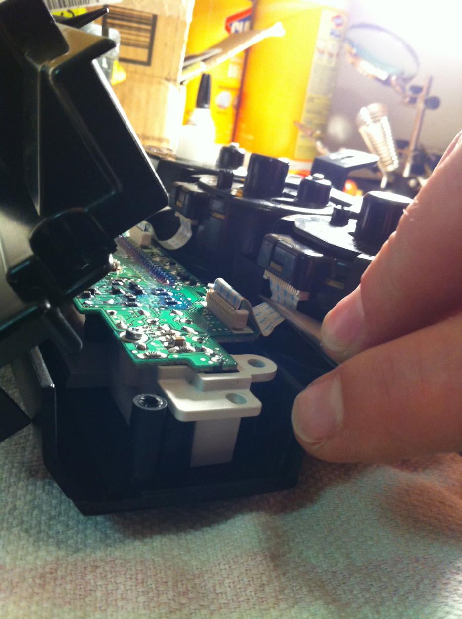

I included a few pictures for anybody that wants to know what the board of the HVAC controls looks like. You will need to solder 3mm for each button the back light is just the screw in type Neo-4. When taking it apart be careful the small spring and pin could pop out (pic 3). Use caution to pull out the wire harness on each one, You pull the small tabs on the ends then pull it out the white plastic clip stays in the harness slides out of that you can see how I removed and installed in pic 4.
