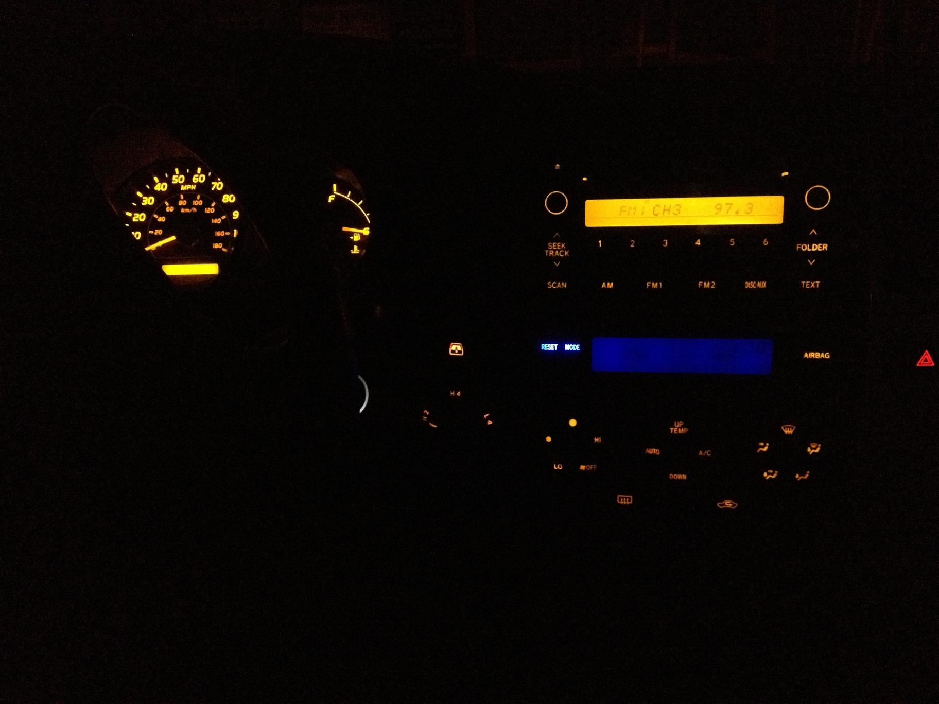

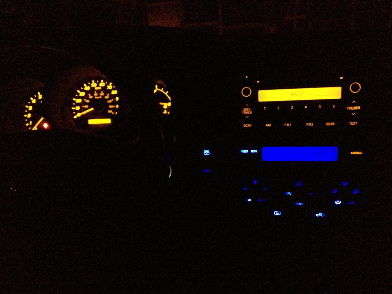

Just started this tonight. Need to change the clock out for white or something. Way too dark and can't read it at night. Pretty nervous about doin the guage clusters. Instead of using solid core wire, I cut only the positive wire on the LEDs short and used the longer negative wire to wrap around. Way faster and cleaner, one spot to solder.
How did you do the gear box and cupholder? Different type of bulb. Not sure how to solder in the flat top LED. Thanks by the way. Super helpful post.

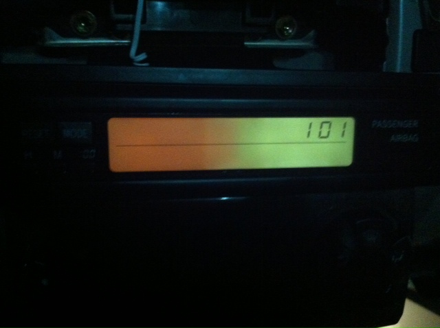

UPDATE: SMDs for Info Center
Update: I have work with the manufacture and we have found a combination of SMD-LED that works in the T4.2 (Neo4) socket and lights up on the LCD information center. The bulb consists of 2 SMD1210 LEDs. I do have more bulbs to order an I would like to gauge everyones color interest, what color request do you have or would like to see?
The first shipment I received was the “Pure/5K white” color. Here is a preview, The “brown color” is the stock bulb with the Pure-5K white bulb.

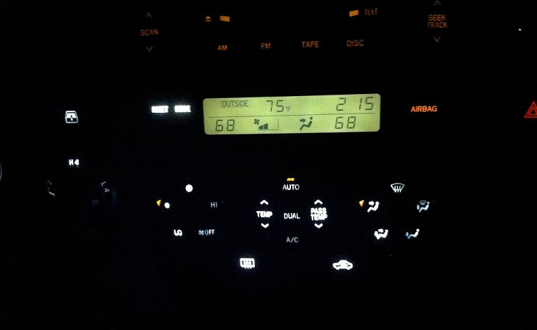

Did a bunch more work tonight. Fixed the LCD screen. Replaced the 1.2k ohm resistors with 100 ohm. Sssoooo much better. I have the hot spots on my HVAC knobs and 4x4, but still looks really good.

would you mind doing a few resistor change so i can try it out? are u using neo 4 hp leds? or the regular cheap stuff?
