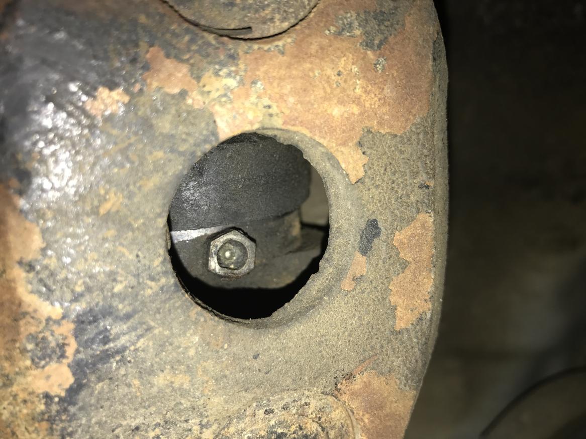

Quick question guys i was greasing my driveterrain the other day and i noticed that one of them had a Hex connection at the u-joint zerk,
is it a broken zerk or is there some type of connection i have to buy for my grease gun?
As well No.7 u-joint zerk at the end of the rear drive shaft.. I kept pumping it but no "crackling noise" or any signs telling me it was good..
is there a recommended number of pumps for that zerk and how would i know.
Please let me know guys, new to this driveshaft thing and im still having a hard time trying to lube the No.8 Slip yoke
since my grease gun tip does not seem to want to attach itself to the zerk..

Looks like a broken zerk to me. Drive over any rocks lately?
Unscrew it and take it to an auto parts store to match thread.
Don't keep pumping that #7 zerk. Three or four should be enough. Watch carefully. If the joint starts to expand, stop. You can damage the components the shaft is connected to.
If a zerk just won't work, change it. But you have to come right at it from the exact vertical angle. Those U-joint zerks are tricky to get to.
BTW, #7 is the slip joint. #8 is the U-joint.

Thanks! ill take it to a shop that will be able to change that broken zerk, oh ok ill keep that in mind, i kept pumping it thinking there was no grease thats why it was giving me no noise or indication it was ok. Hopefully everything is ok there, seems to be running smoother since i greased the rest though so i dont think it harmed it to bad.

No need to search I got you bro. Use an appropriate sized socket (Probably 8mm) and turn counter clockwise until it comes out....new one goes in by same process in reverse. Suggest soaking with PB Blaster first.

It's just the slip joints that you need to worry about like that. Unlike all the others, the grease has no natural exit, so it pushes on the rod like oil in a hydraulic cylinder. All the others, pump away. Hear the noise and watch a good hunk of grease come out. If it's a color other than black, keep going until you see the new stuff.
I found a broken zerk today and replaced it. It's the Slip joint one. It's an M6-1.0 thread. I made a video that may help those who aren't mechanically savvy yet.
That zerk on your double cardan probably isn't broken. It looks like a flush zerk which requires an appropriate conical nozzle. You can google for more.
