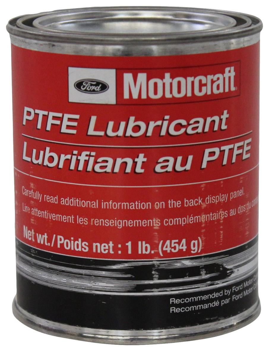

I took my sleeve yoke apart and greased it really well with moly grease and it didn't get rid of my sleeve yoke binding problem. When I cleaned it up and greased it with Ford XG-8 grease, the problem finally went away. Maybe my sleeve yoke is more worn than yours from improper or no greasing over it's life.
The Ford XG-8 was manufactured to directly address the slip yoke and sleeve yoke binding problems with their trucks. And since drive shafts are drive shafts, it works great for our trucks too.
Here's a link for anyone wanting to try out the Ford XG-8 grease themselves.
http://www.amazon.com/Genuine-Ford-...d=1458136974&sr=8-1&keywords=Ford+XG-8+Grease
