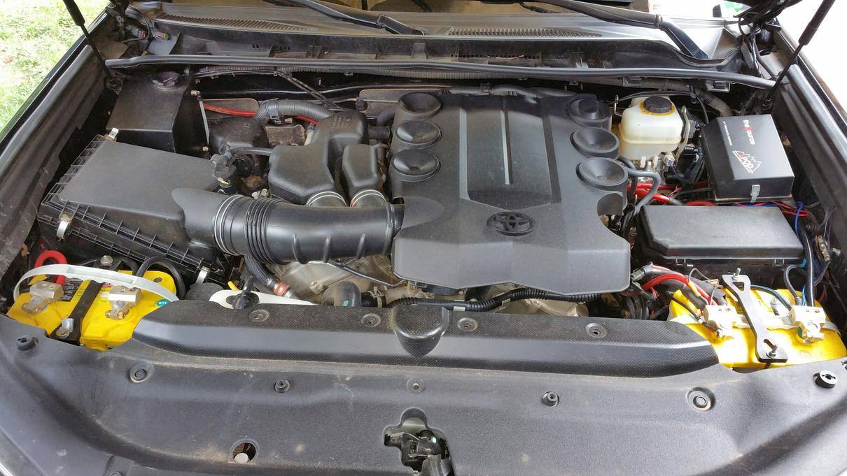

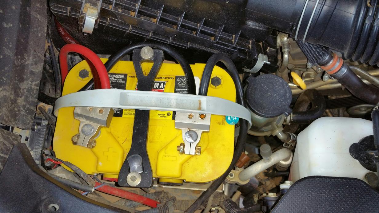

Did you happen to take pics of the battery locations? Just curious where the secondary battery sits in a '14, as I thought the plumbing near PS firewall
prevented the placement of a battery there.

Shrockworks has a total relocation set up that moves components to ensure the battery fits

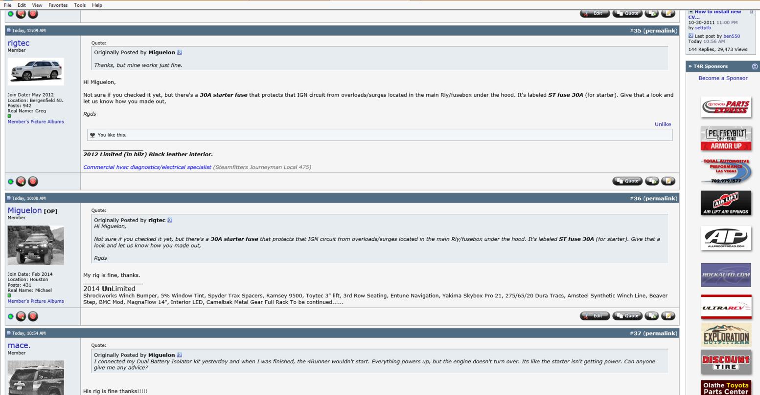

Hi Miguelon,
Not sure if you checked it yet, but there's a 30A starter fuse that protects that IGN circuit from overloads/surges located in the main Rly/fusebox under the hood. It's labeled ST fuse 30A (for starter). Give that a look and let us know how you made out,

My rig is fine, thanks.
I connected my Dual Battery Isolator kit yesterday and when I was finished, the 4Runner wouldn't start. Everything powers up, but the engine doesn't turn over. Its like the starter isn't getting power. Can anyone give me any advice?

I have no idea what is going on here, but it looks like I am not seeing all the messages. On my side this all looks like I am being quoted and offered advice to fix my truck.
