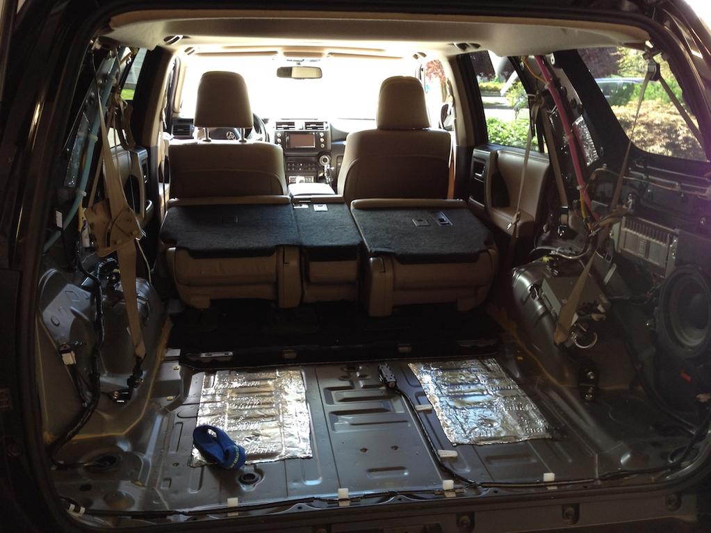

The interior of my truck has been apart for the past couple of weeks. Now that the kids are in school full time, I've got some mod time to myself.
Disclaimer: All of these are done in a 2011 LE with 3rd row. Some of the mods are geared towards that. I really use the 3rd row especially with visitors. The kids are small enough and comfortable in the back back.

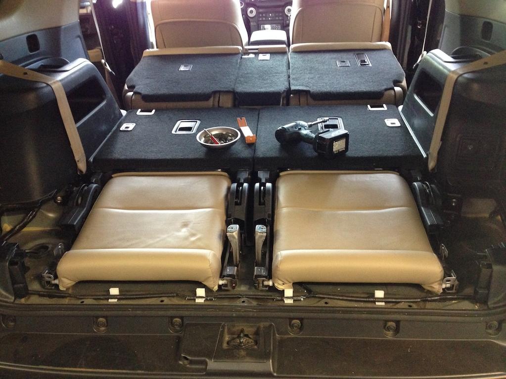

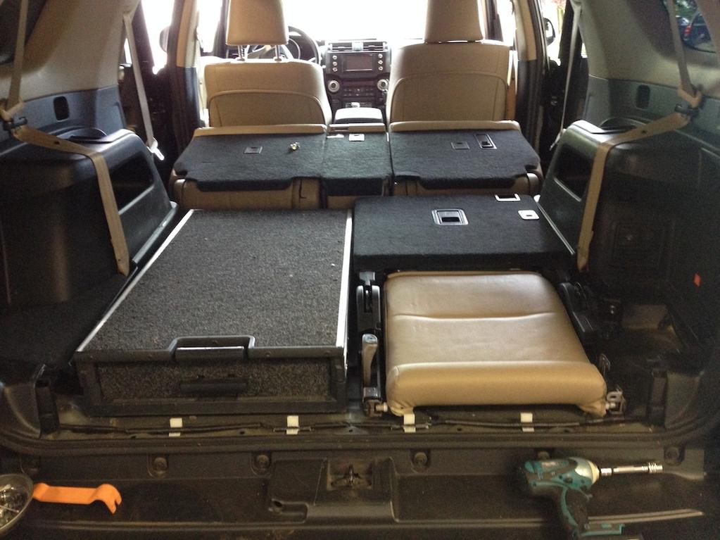

Time to rip it apart!

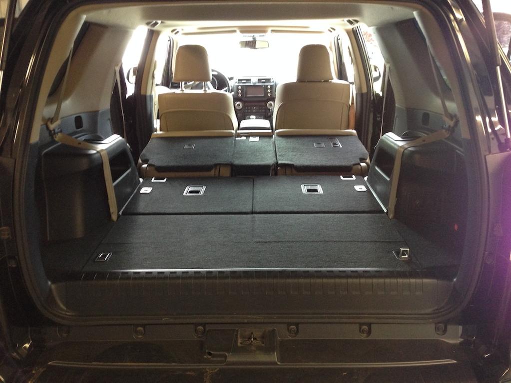

This is what an LE with 3rd row looks like with everything folded down.
Remove a couple of trim pieces
3rd row seats exposed
Ultimately, I will have only one seat in the back and I'll finally bolt down my ARB fridge slide and drawer. Its almost as if it was designed that way. The floor is fairly even with the ARB drawer and the other 3rd row seat.

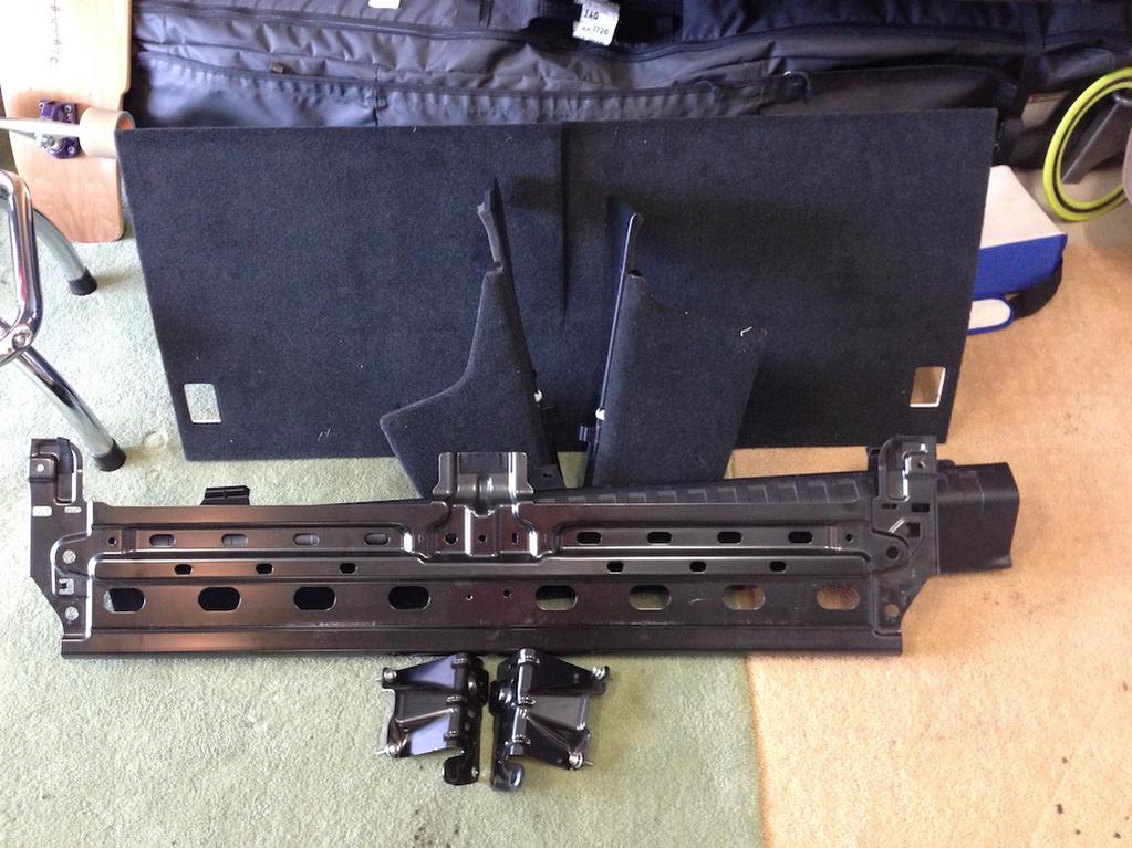

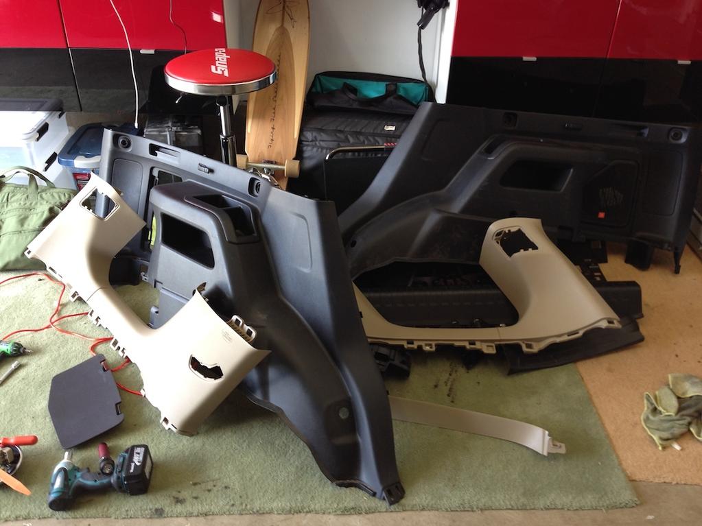

And let's rip apart the rest of the rear interior.

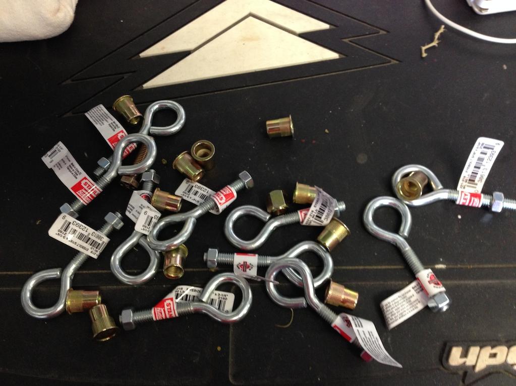

Here's some hardware for my "cargo system" I'll be going over a little later. Still waiting on some parts.
Was it hard to remove the 3rd row completely? Thinking about doing the same to put in sound deadening but it looked risky.
Not sure if "risky" is the way I'd put it. But if you are mechanically inclined, it's relatively easy to take things apart and put them back together. Just don't FORCE anything and use common sense when dismantling and you'll be fine. It's worth the effort for sound deadening. However, if you plan on any other modifications, I'd recommend planning ahead and tackling that at the same time.

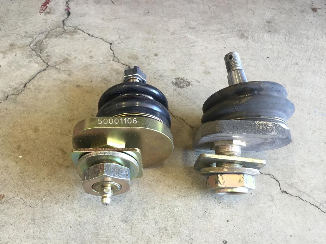

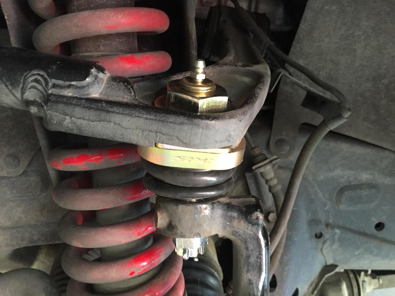

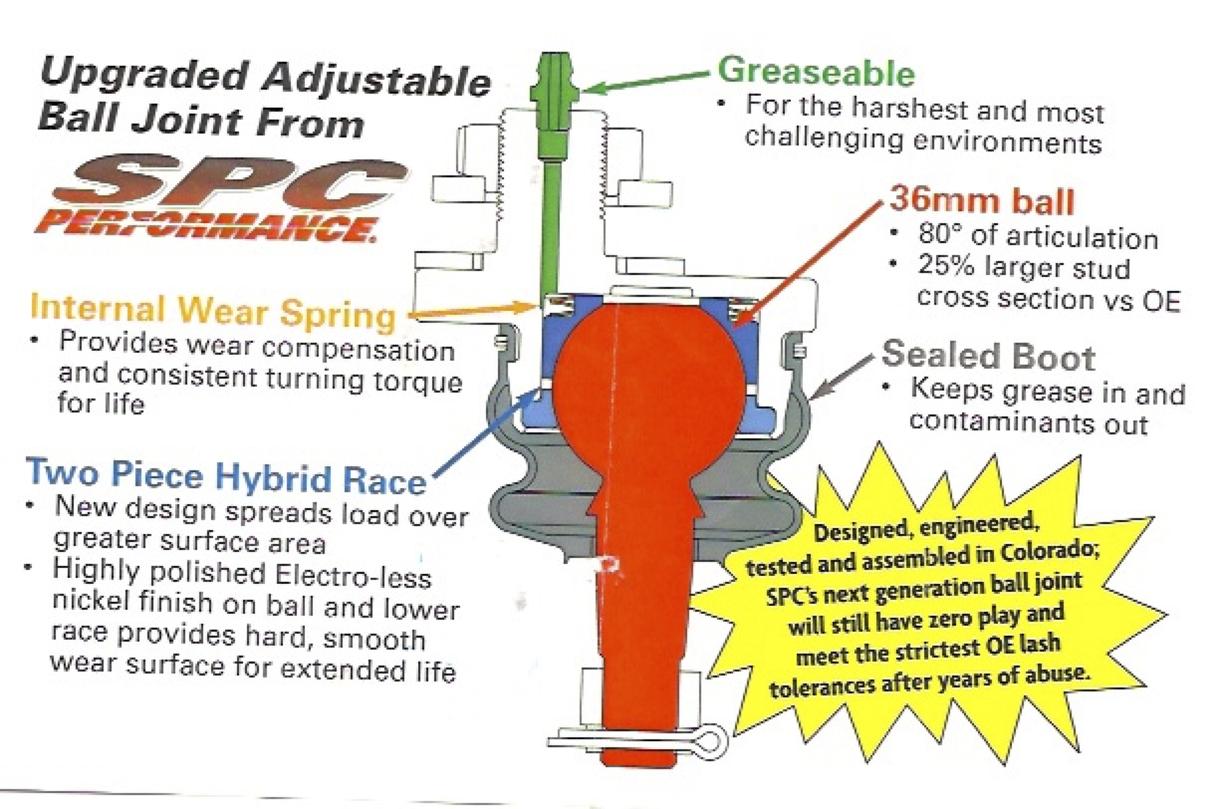

I recently replaced the upper ball joints in my SPC Light Racing control arms. There is a new and improved ball joint system that you can now grease.
I won't bore you with install pics because everyone pretty much knows what an upper control arm ball joint looks like.
I know LR control arms have had a bad rap due to several of their first batches of control arm failure. And while I can't dismiss that reputation, I'm glad to know even after 50k miles of wear and tear, only one of my ball joints had enough play to be concerned with.

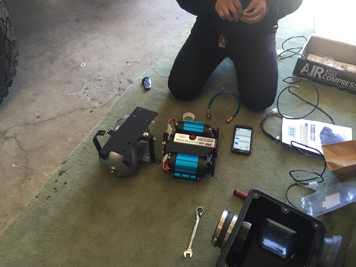

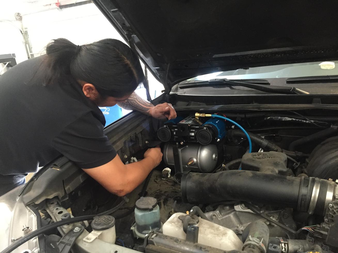

[MENTION=78318]RiDE[/MENTION] came over to the Ducmonsta Garage so we could install his dual ARB compressor and 1 gallon tank by the passenger side firewall. Evidence shows, even Mark can turn a wrench!
He's got more photos of the final install.

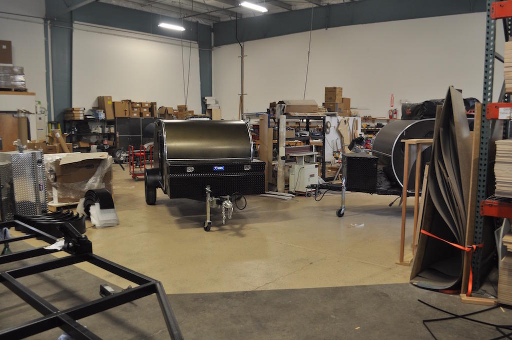

In other Ducmonsta news, I've taken a new turn in my search for the almighty dollar. I was a recruiter for the Consumer Products Industry for the past year or so. And although the money was good, it simply wasn't satisfying.

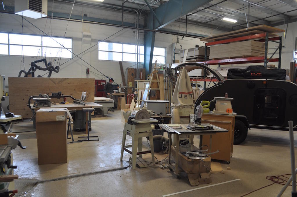

So I turned to the folks who built my teardrop trailer, TeardropsNW. They have brought me on to help with their online community, Facebook and Instagram. Ideally, I will help promote their standard trailer builds but also heavily focus on the 4wd/offroad market with the "Recon". I will be attending trade shows, going to events, and documenting what an teardrop trailer does when it goes off the tarmac. Now, I don't plan on completing the Rubicon by any means, but I want to show the teardrop community that it's not all about the state campgrounds but about the road you take there.
TeardropsNW is located in Salem, Or and build some fantastic little trailers.
I'd love to get my 4Runner community involved with them and possibly sell a couple to you guys :cool:

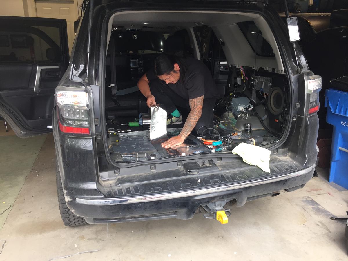

Spent some more garage time with [MENTION=78318]RiDE[/MENTION] working on his ride:bowl: Helped him remove the 3rd row for some sound deadening and put him to work!:whipping2:
I really enjoy helping people learn more about their trucks. So for the record, if you're coming over for help with any install, expect to learn a few things and put them to use while you work on your own truck. :lol:
I'm pretty excited for the next project he wants to tackle. I won't let the cat out of the bag in case Mark wants to keep it a secret. But, this next one is going to be quite a project.
