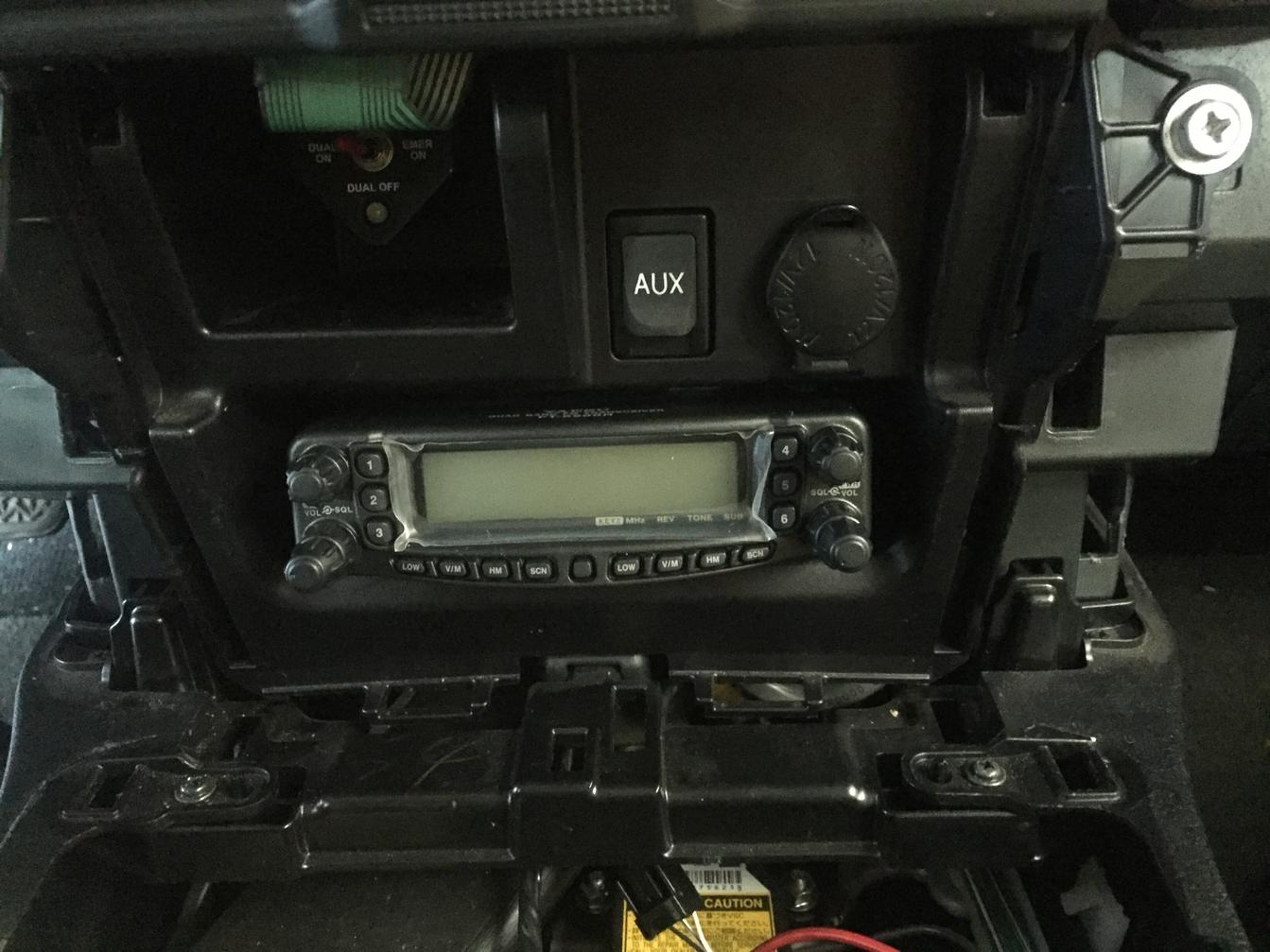

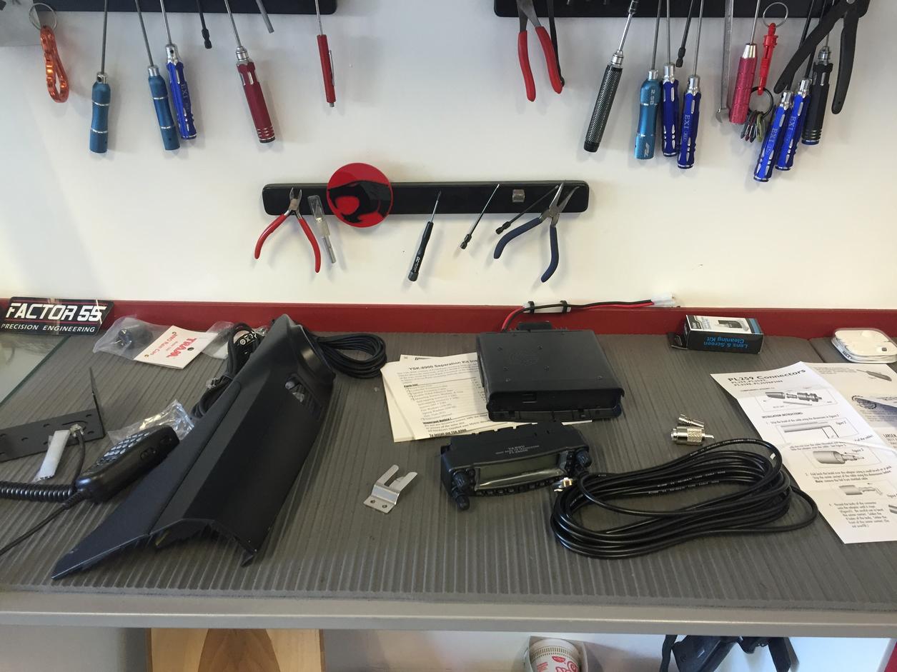

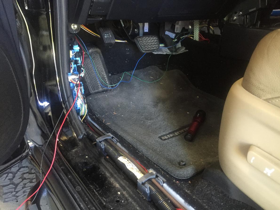

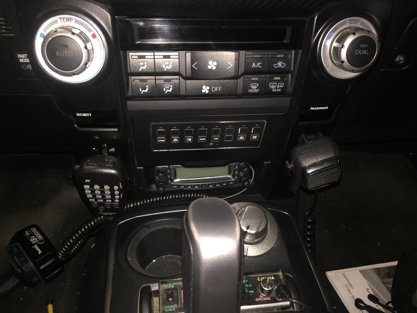

I went with the Yaesu FT8900 because of the consistently great reviews and known reliability of the company.

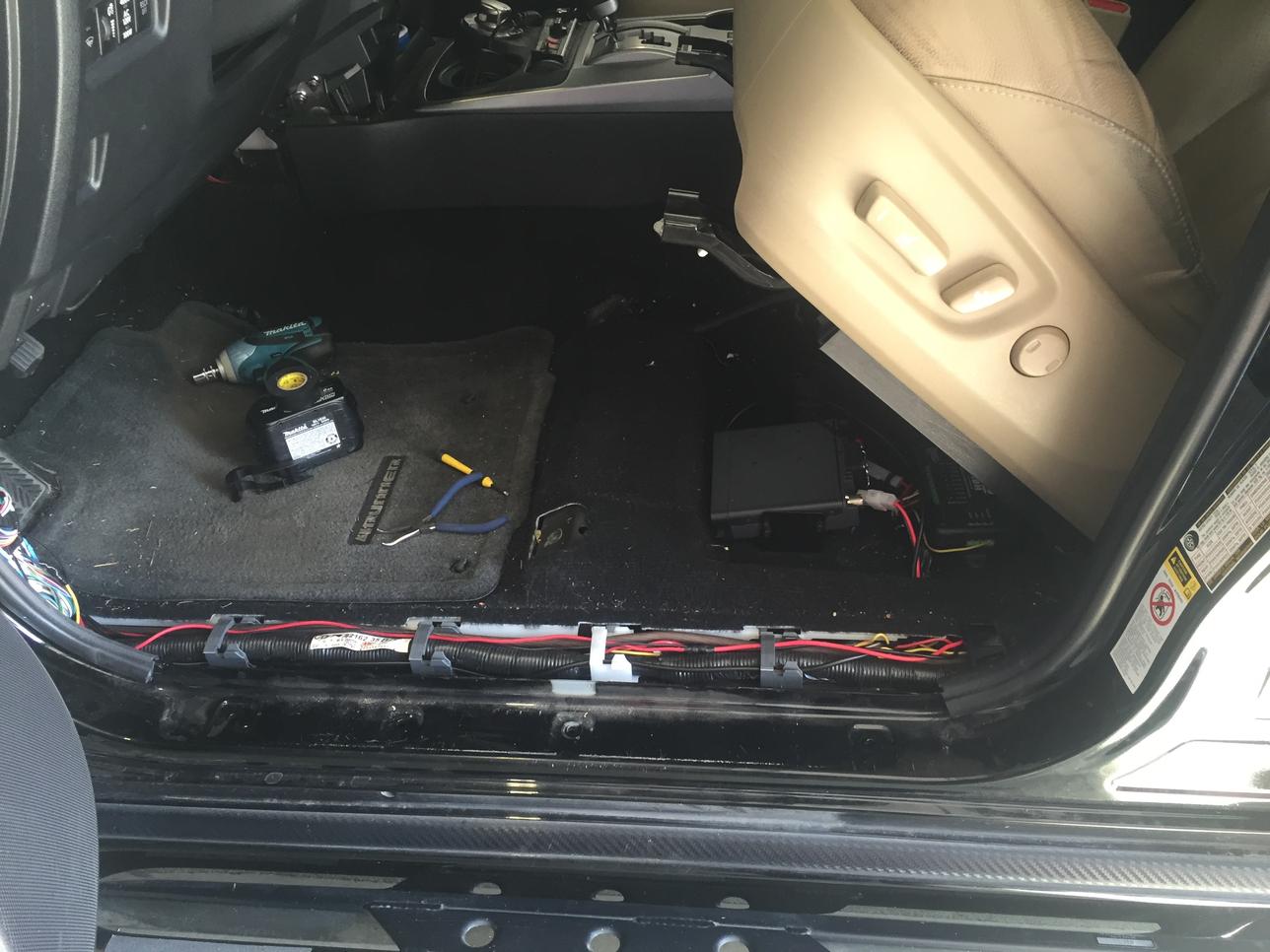

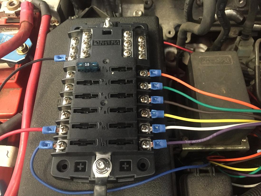

Also cleaned up wiring from previous installs.

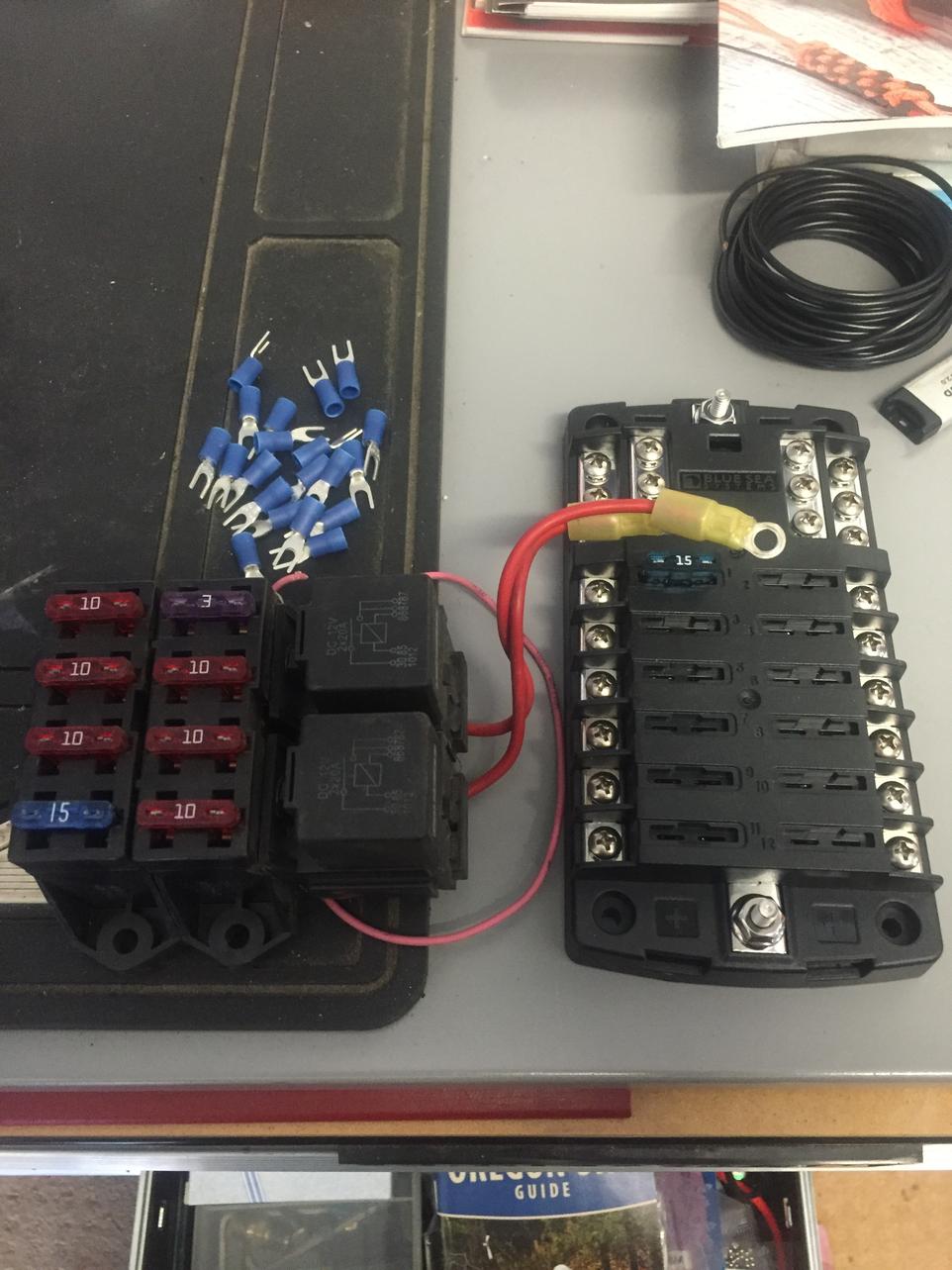

Out with the old Painless Wiring system and in came the cleaner, much nicer Blue Sea Systems 12 bank fuse box.
Found a good place under the drivers seat for the main unit. Plenty of room and it's away from the floor vents.
I'll ultimately get an extension for the mic and route the wiring behind the dash and exit on the left of the console.
So all you'll see is the faceplate.

Yup! I hope you're ready to learn how to take things apart and wire stuff up!
I've taken a fair bit of the cabin apart before, so I'm not scared. But I like how you ran the power and antenna cable down the right trim piece under the dash and along the kick panel/floor board so it popped up under the front seat.
We'll do something like that on mine, just on the right front seat as compared to the driver's side.
Really stoked to get that installed and thank you in advance, Bobby.

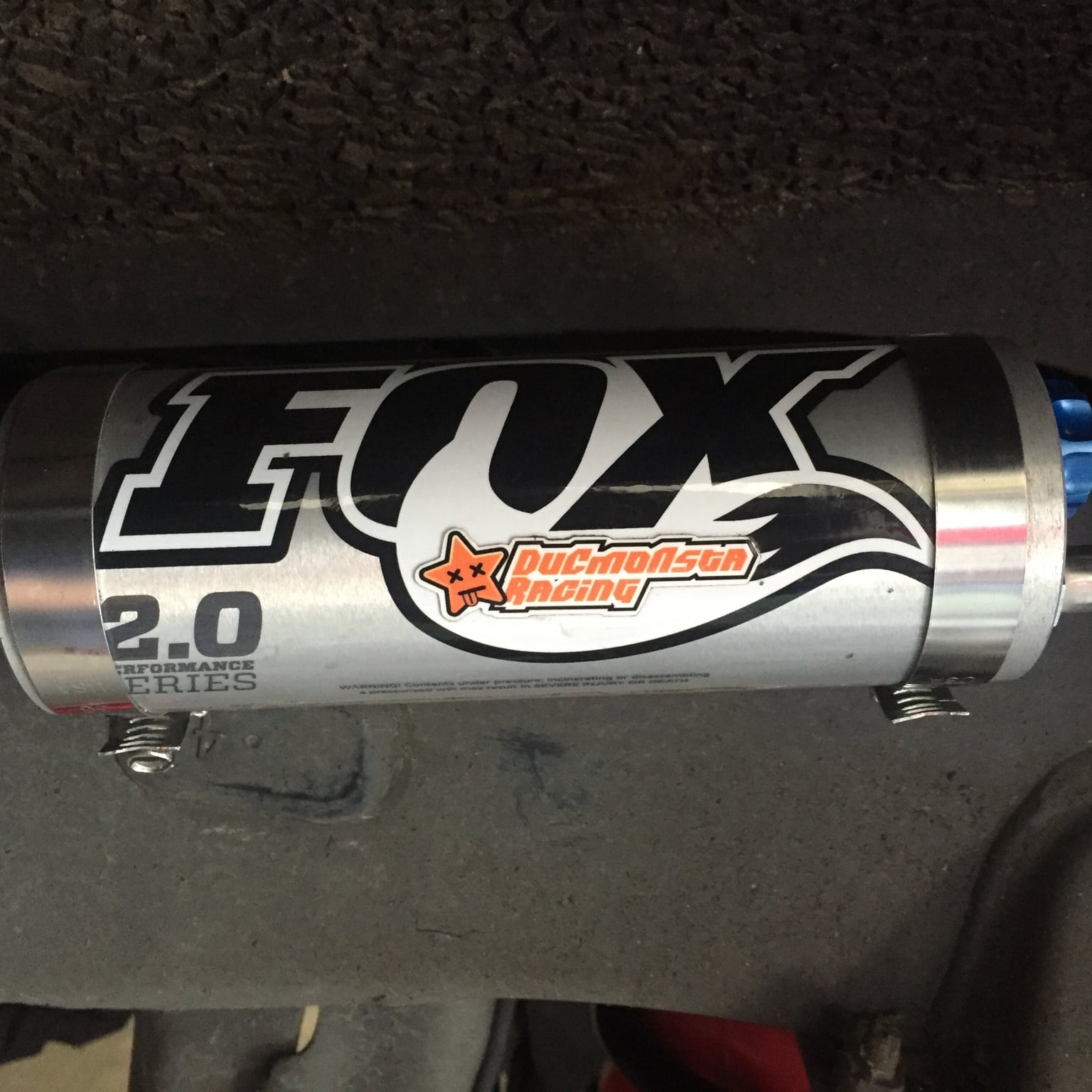

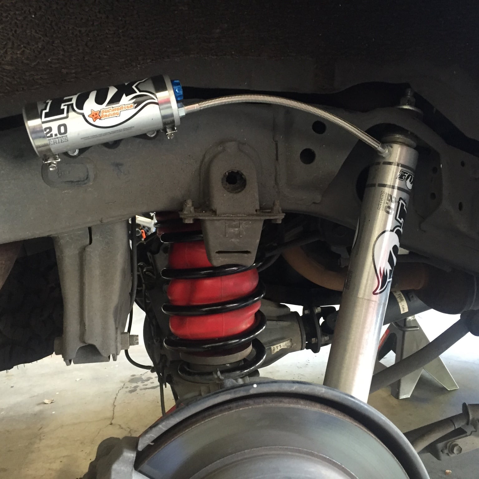

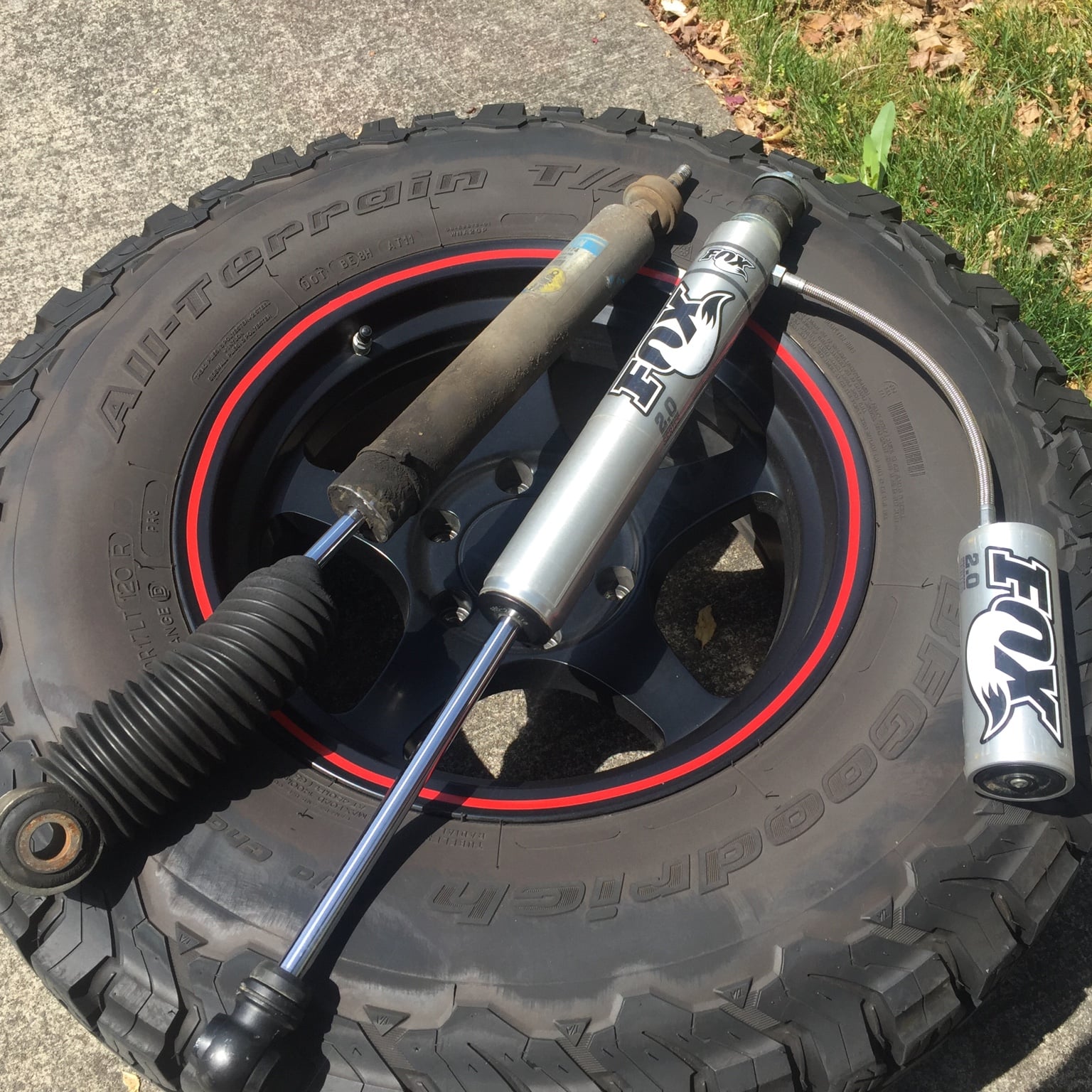

Spent some time today working on the truck. Thanks to [MENTION=64805]SC0TT[/MENTION], I got a great deal on some Fox remote resi rears to replace the leaking Bilstiens.
Out with the old, in with the new. "Custom" valving for the Duc!

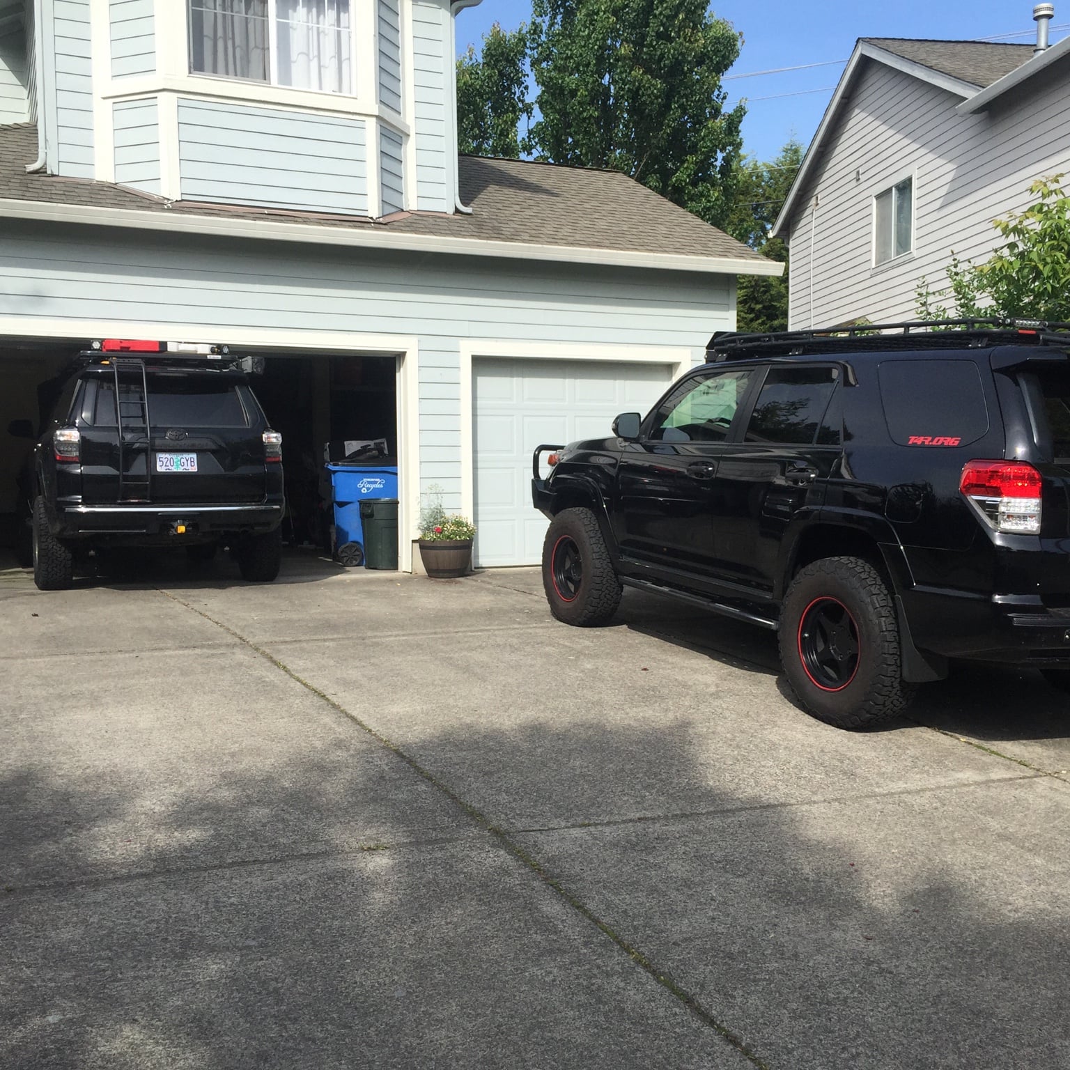

Also had another happy customer at the Ducmonsta Garage!
We replaced @RiDE's rear springs to prepare for the SSS rear bumper install in a couple of weeks.
Also wired up a custom plug for his Renogy solar power set up. Stealth install!

Nice upgrade on the rear. I am trying to decide which Fox shocks I am going to go with in the rear. Leaning towards the DSCs to match the front.
Looking forward to your ride review.
Just did a 1.5hr drive each way to Salem, Or. Honestly, at the lowest valve setting, It didn't feel much different than the 5100s. The test will be while I'm towing the Recon out to the beach this weekend. I didn't have any major complaints about the 5100s to begin with. It was just a deal I couldn't pass up and the 5100s were leaking anyway.

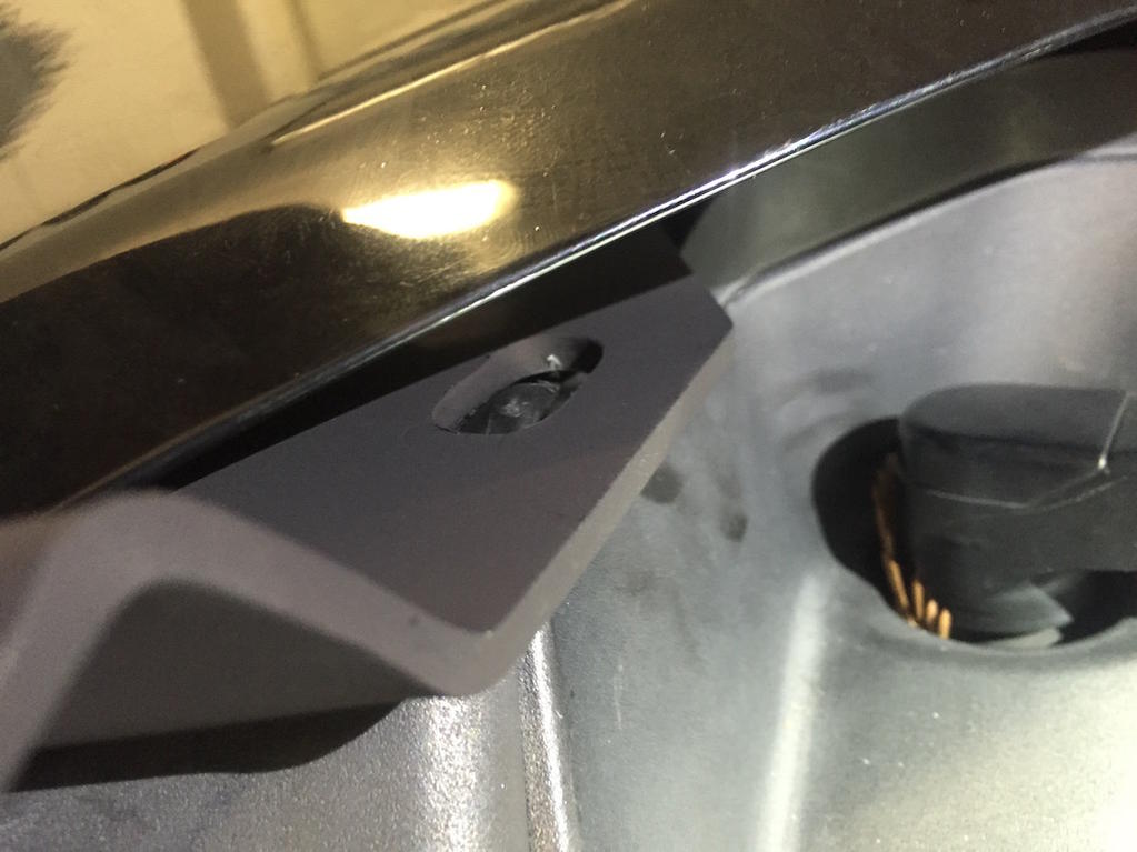

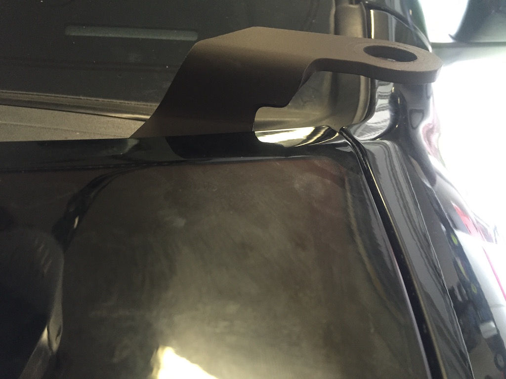

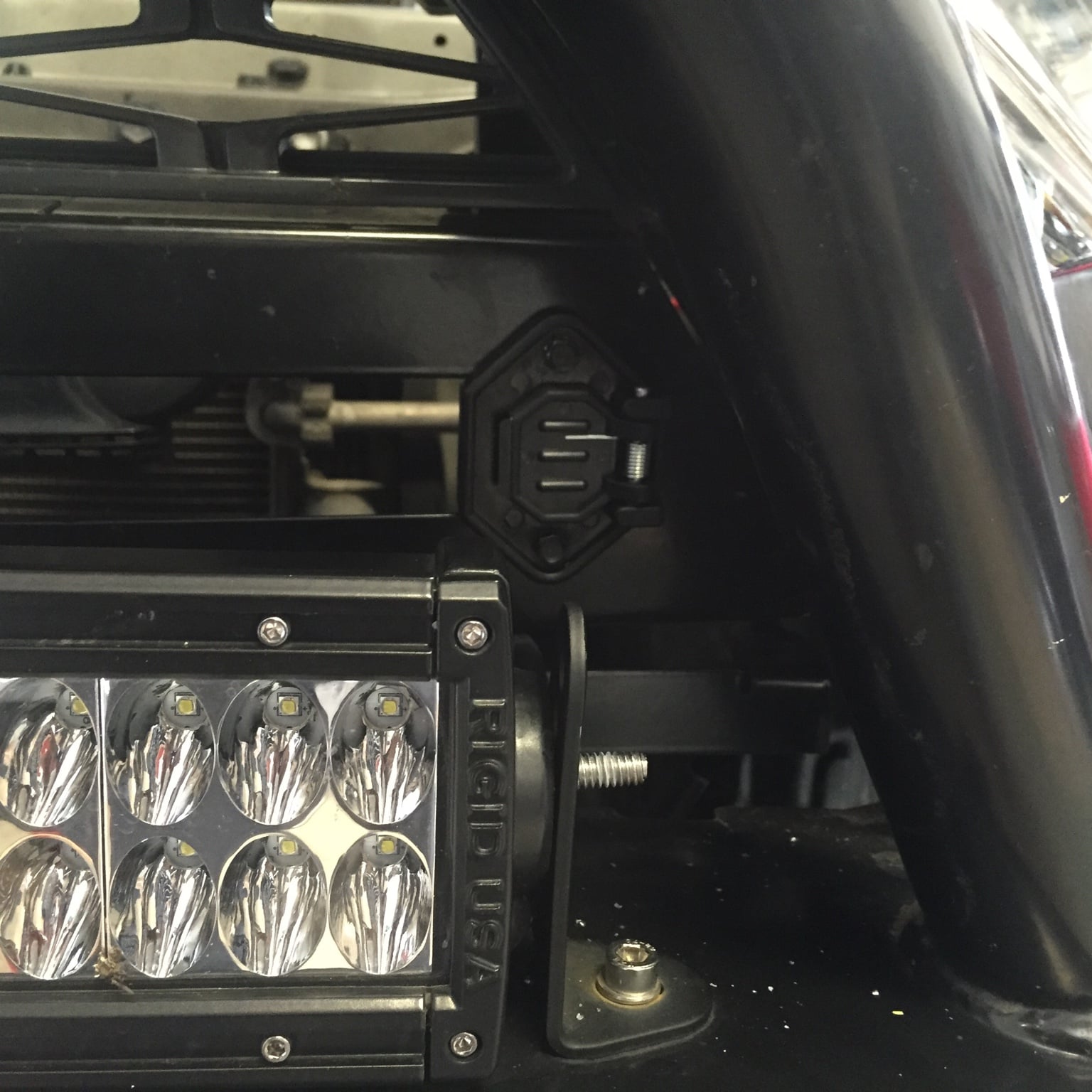

Finalized the ham radio install today. Got a CBI ditch light bracket courtesy of [MENTION=124732]LawnDart[/MENTION].

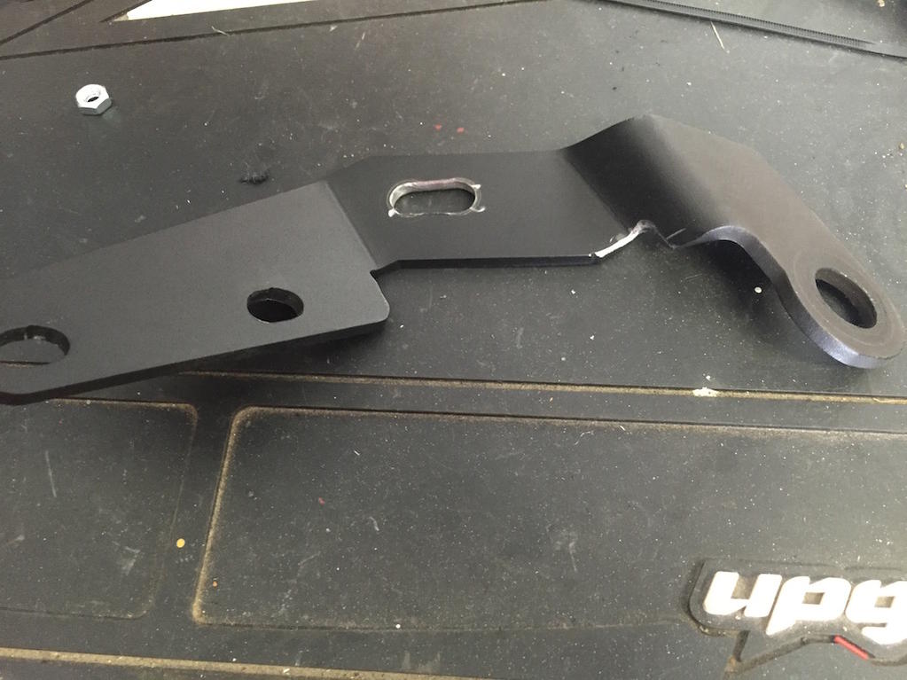

I remember other members having an issue with clearance for the plastic cowling on the windshield. I initially installed the bracket to get a better understanding of what the problem was. It also made the hood stick up at the corners about 1/4" and the OCD part of me couldn't live with it. So here was my solution...
I made a slotted hole to make room for the little bump on the windshield cowling. I've seen some others take a heat gun or even cut the cowling. I figured I'd modify the bracket before I modified the truck. I also took a die grinder to the corner where the hood meets the bracket. You'll see the unpainted parts here of what was modified.
Now there is more room for the bracket to be adjusted and get the hood aligned.
Here's a bit of a close up of where the cowl now "peeks" through the hole I created.
It could probably use a little more material removal but as long as it doesn't create that unsightly gap at the hood anymore, I'm satisfied.
Went with the Pulse/Larsen NMO2/70 antenna.
