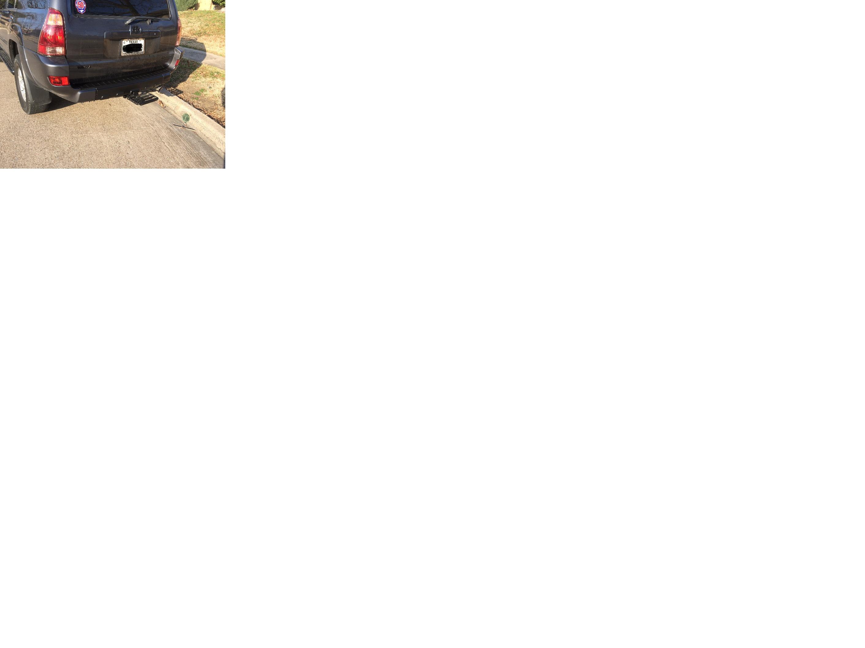

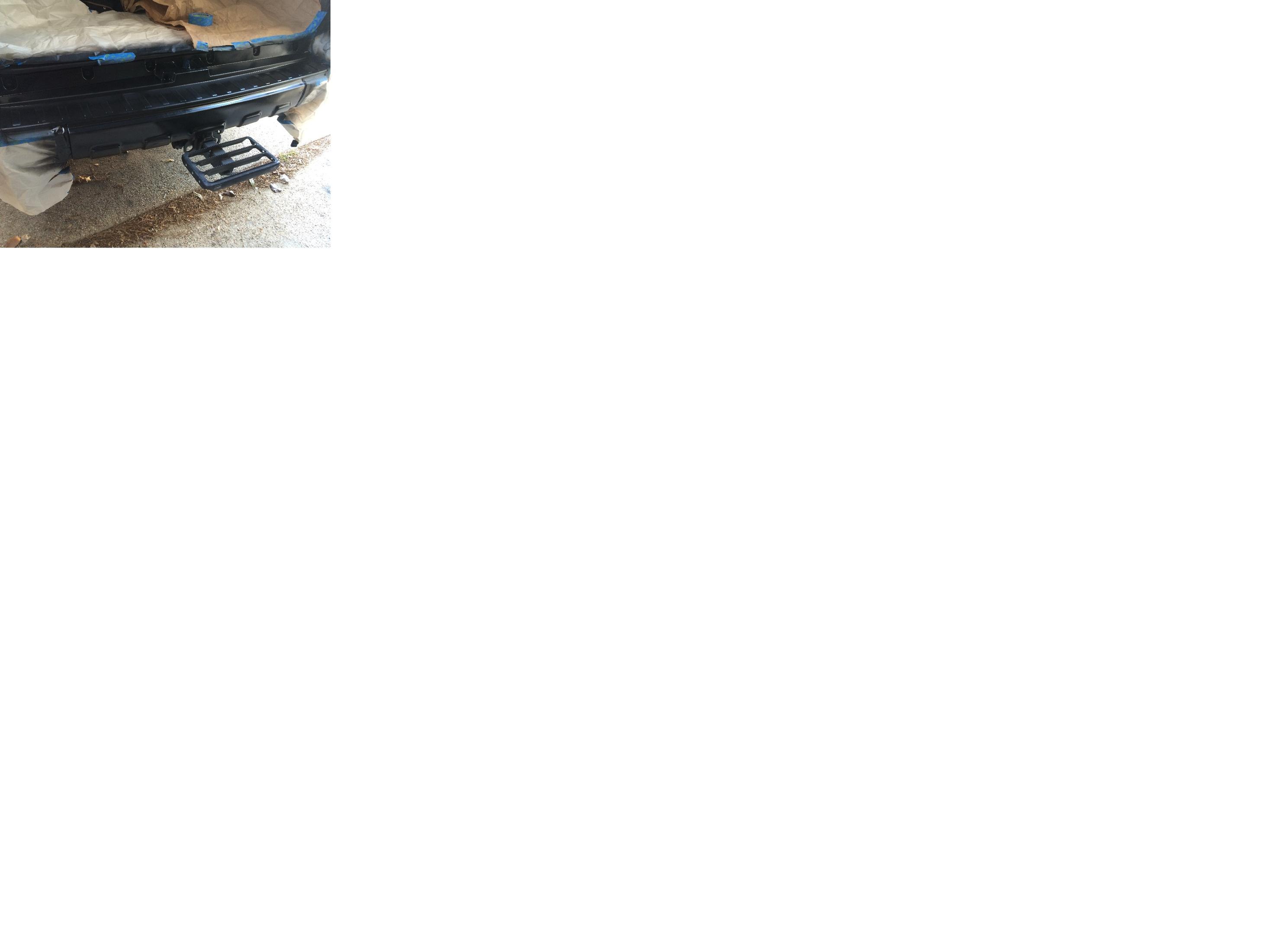

And the back plasti-dip bumper and step. Wkday mods!
