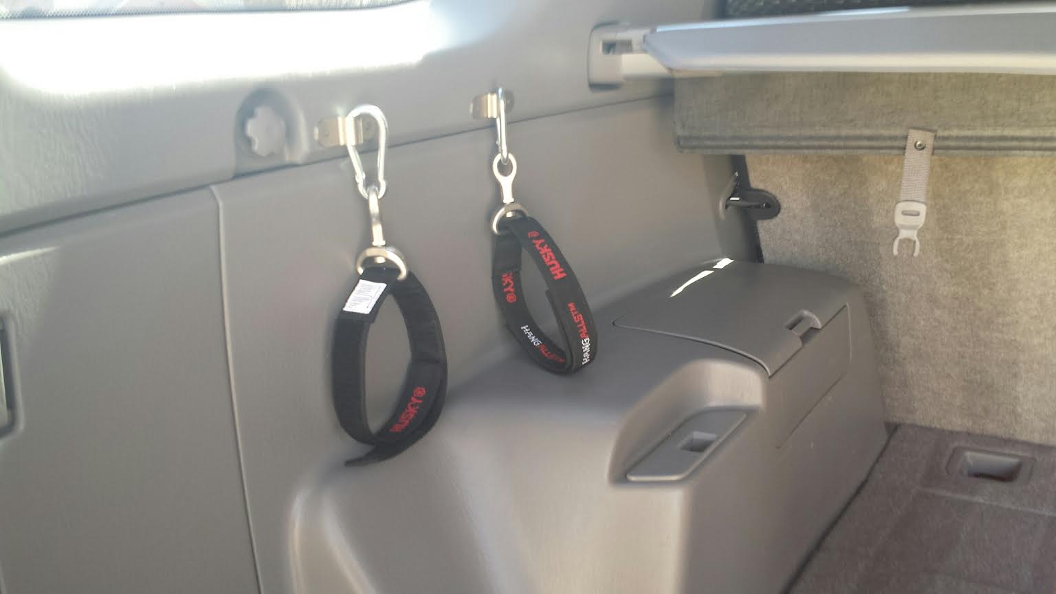

Installed some straps in the back to hold my fire extinguisher... or whatever else I want to secure. Apologies for the blurry picture (looked clearer on my phone), I will get a better one later.

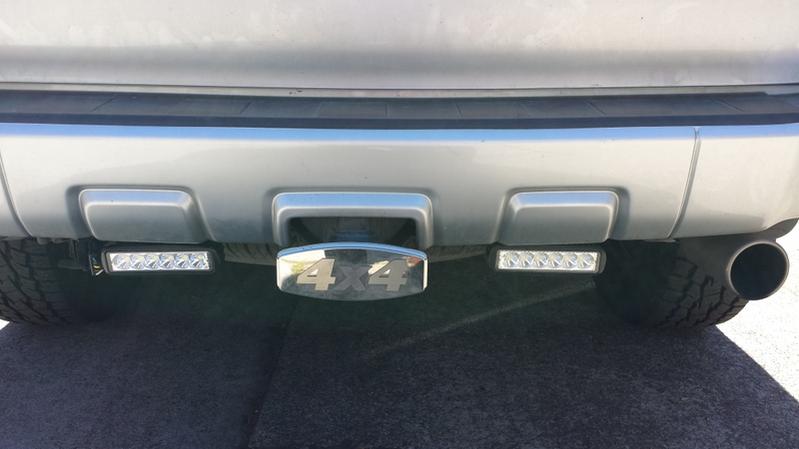

Just tapped into the existing trailer wiring for reverse lights. Attached the LED lights to existing screws. No fuse or wires leading to the battery or switches needed. Also no need to tap the wires to the actual reverse lights. The trailer hook up will still work.
