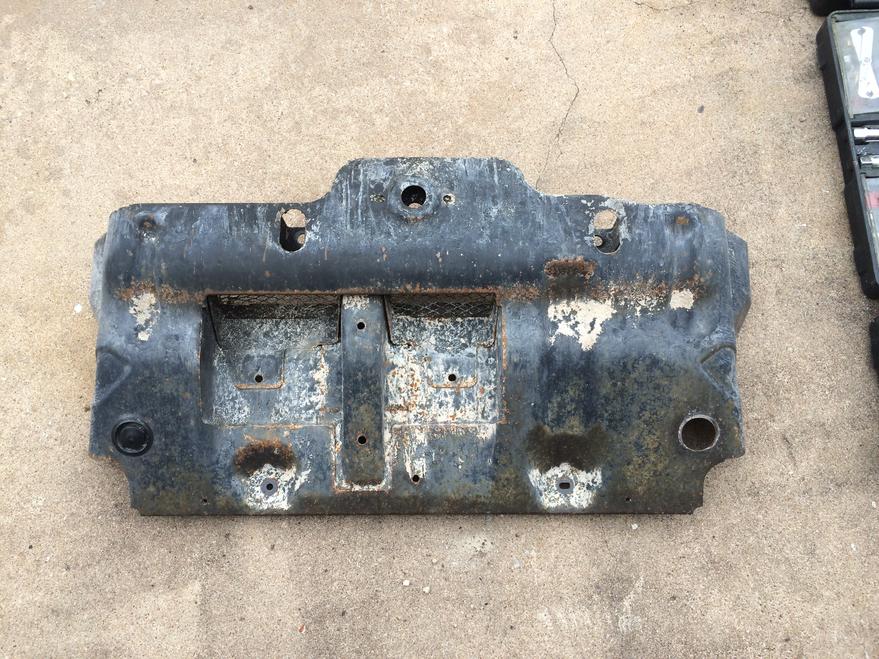

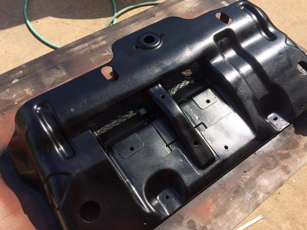

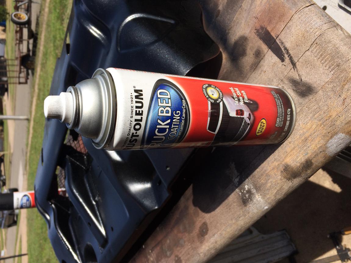

Skid Plate
Not really much of a mod, but much needed. Skid plates needed some attention. Pulled the front one off, wire brushed, primed, and painted with bed liner paint. Second will be done tomorrow.

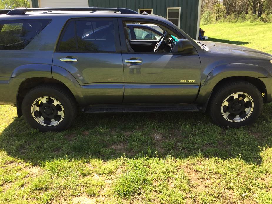

What would be the largest I could do w/ just the leveling kit? Sticking w/ that same tire. Go w/ the factory recommended 265/65/17, and use the more aggressive tread AT/TO?
I just mounted 265/75R17 BFG All terrains on mine this week. OEM suspension as of right now. Zero rubbing
Do you have aftermarket UCA's on your rig? I see you have FJ springs front and rear and 5100's all the way around @ 1.75. I am considering the same but instead of FJ I'm thinking the smallest Old man emu model 883
What sort of lift do you have with your FJ/5100 setup @ 1.75? Are you noticing tire wear is uneven or excessive? Any advice? I want to add functionality to my lift without replacing my 265/60/18 and looking goofy or my UCA's
