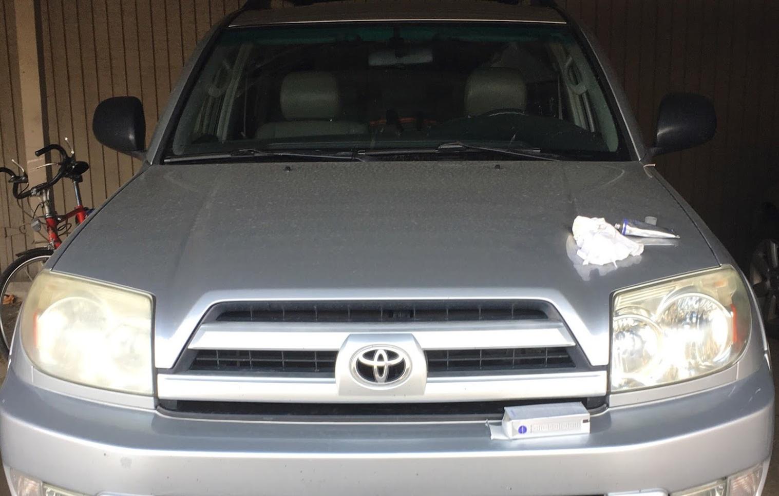

Give a cursory clean of headlights, working in small areas rub on polish, wipe off with soft rag. Took me about 5 minutes. Maas has a variety but this is what I used.
(photo wasn't as clear I wanted but they look great now).

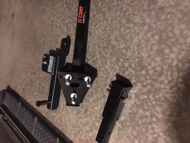

Alright, I will surely do that! I don't have a phone at the moment, but I can grab my brother's or dad's for pics. I have bought all the bolts, nuts, etc and so far I'm around $150 in with the hitch pivot piece, tire mount, and an 8" extender to go between the two and make it higher up. Also bought a locking pin. We won't be able to grind or drill until next weekend, but I can get a pic of everything I have so far and a rough sketch/layout. Will definitely get pics when we start work with the power tools. Be aware that I have 265/70/17 tires and with this mount, I had to get a spacer to move the spare away from the mount by a little over an inch so the tire would clear the main beam of the tire mount piece. You will need a drill and bit to go through hitch steel, a grinder, and something to cut a weld cleanly with. Lemme me hear it for some 4Runner home-cooked projects!:guitar3:
EDIT: on second thought, my tires won't be a change in width from stock so if that's what you have then you'll need some spacing as well. If you have even bigger and wider tires, then you'll end up needing more spacing than I did

Last night we were able to get a friend with a heavy duty grinder to cut the "L" off of the actual tire mount so tonight we'll get to put everything together and mark the holes for additional drilling. That stuff sure is tough to get through as it's the cold-rolled steel! Will have a picture of it pre assembled tonight to show the construction. After that, I'll have to wire up a license plate light so I don't get stopped:naughty:
I should get it all done for a total of probably under $175 when everything is all said and done. I'm eager to get it on the truck:thumb:
