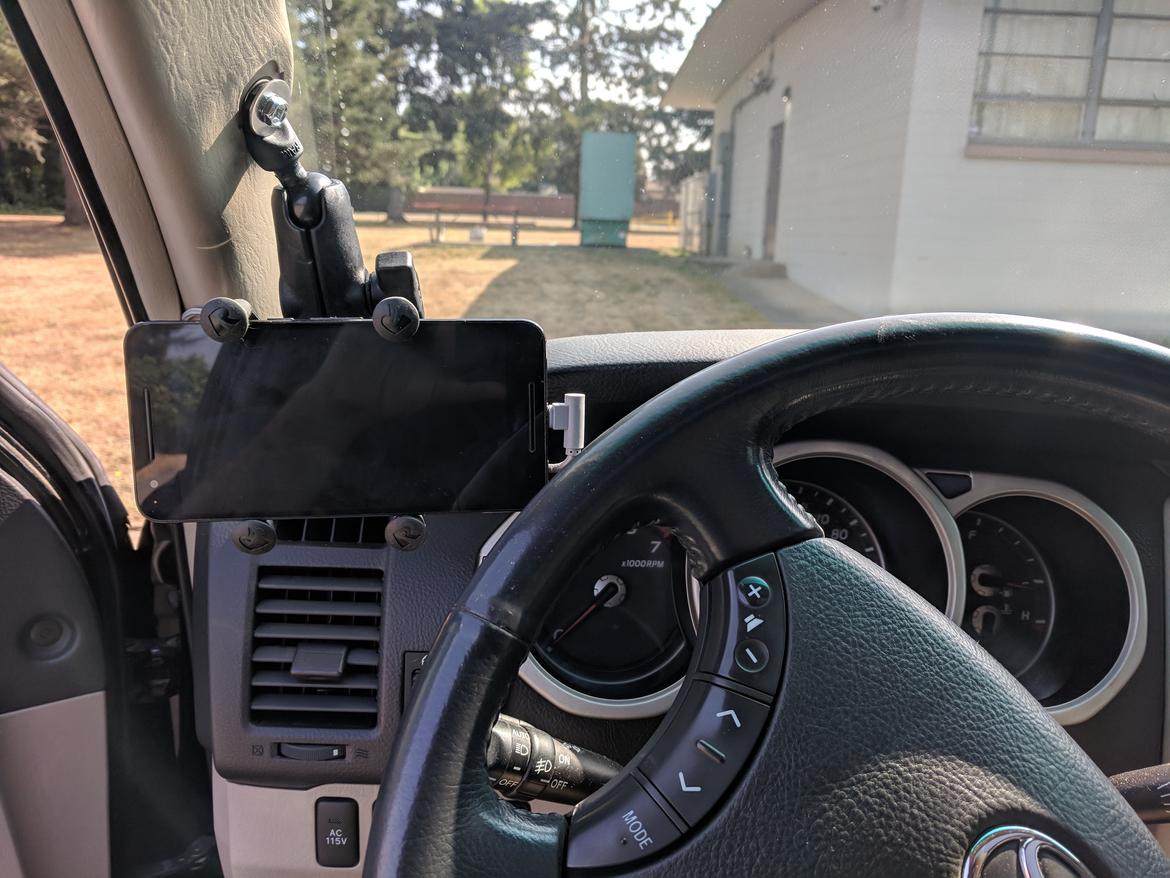

One goes under the steering wheel and up the A-pillar to power my phone mount on the left side. I used a USB Y-Cable to combine the USB data port from my Android Auto head unit and USB power from the new charger to one cable.
Link to Y-cable

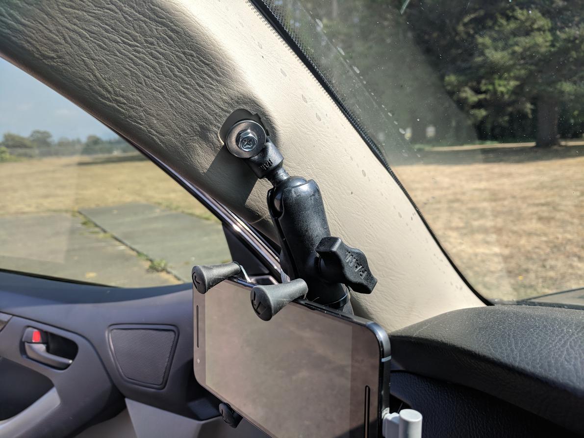

The phone mount idea I stole from a thread here. Attached a Ram Mount ball joint to the screw hole for the A-pillar handle.
Link to base ball joint
Link to extension
Link to phone mount

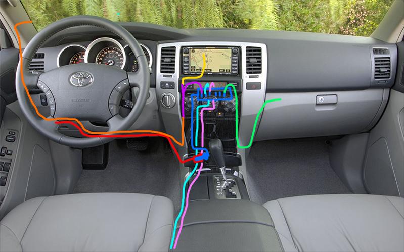

Here's my best attempt at drawing how I wired things using a random picture of a 4th gen dash. Red goes from fuse box to the 12v socket, blue is the USB charger, green is the USB extension cable to glove box, pink and light blue are USB-C cables to the center console, yellow is USB extension from head unit, purple is Y-cable, orange is USB-C cable to phone mount.

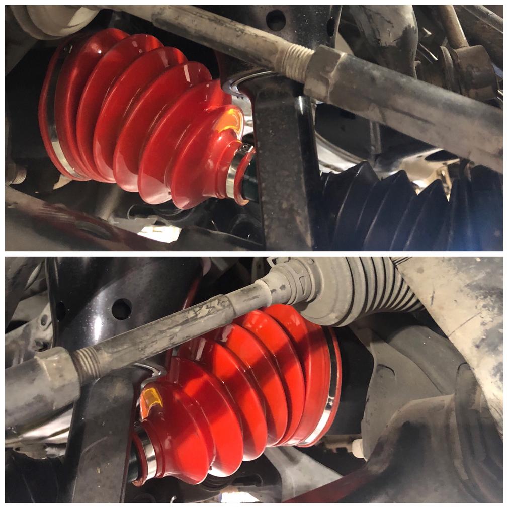

CVJ Axles
Heard good things about them. Decided to give them a try since my old boots were just letting the grease decorate the underbody of my rig.

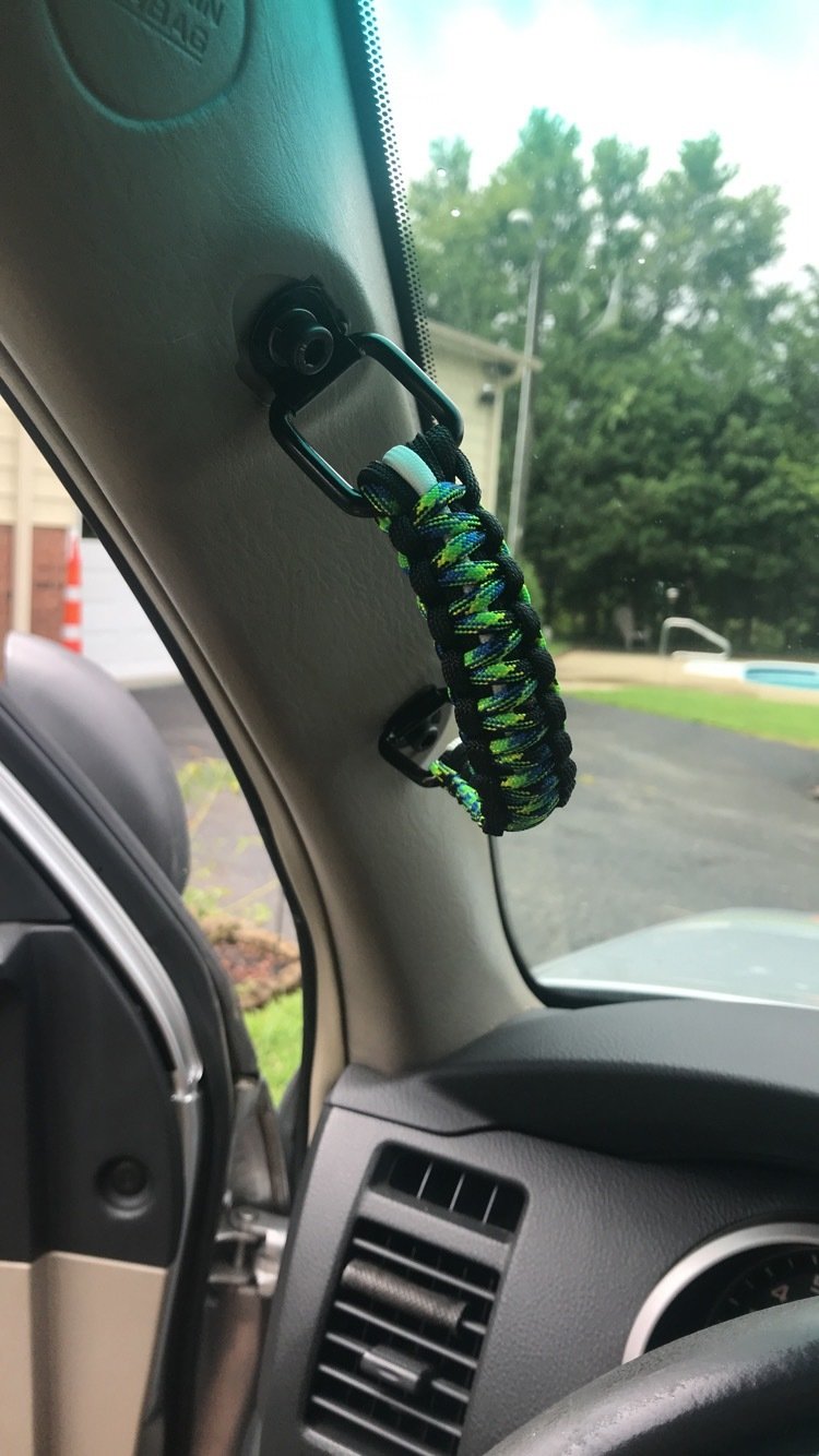

Off-Road Paracord Handles!
Im a college kid who runs a small business making these oh shit handles from my home. I do grab handles, Headrest handles, and rear hatch handles. They're cheap as hell, and they take 5 minutes to install! check them out!!
