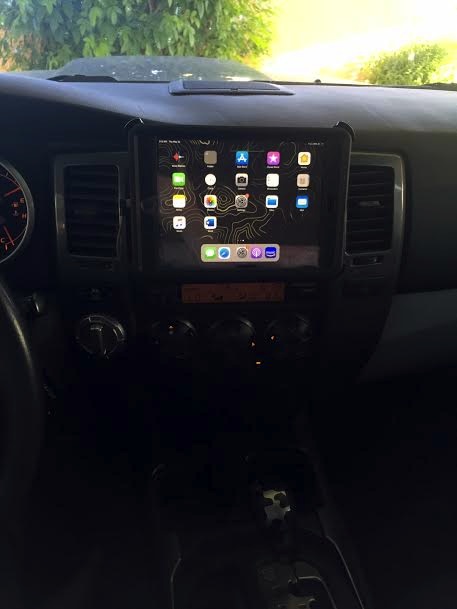

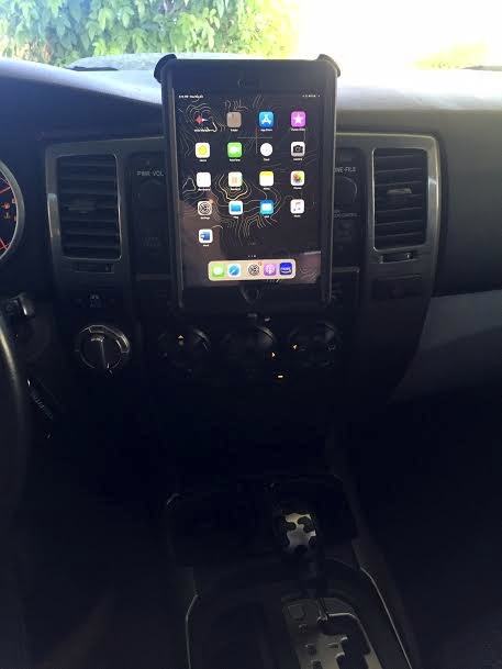

Ive never used the radio because i have an aftermarket bluetooth adapter. Its left on AUX and I just use the steering wheel controls. I wanted a screen for the radio but couldn't justify 500-800 for a Double Din with Apple Play. I wanted the abilities to use my offline terrain maps as i Use the 4runner for hunting and going out to places with no signal. My solution was purchasing a Used Ipad Mini 3 with cellular capability for $175 and custom making a solid mount. I looked at every option for Ipad mounting and none of them seemed good to me. The vent/CD/ Magnet options were all too unstable for when I go offroad. The Ram mounts and window mounts were solid but took up passenger room or window space. This was my solution. You do have to permanently alter the center trim piece but I keep vehicles until 250k+ so this wont change the value at that point. I am beyond pleased with the outcome. The Ipad is removable and the USB is hard wired to the factory fuses. So now I have a complete Navigation/ Music setup as well as an Ipad I can take when I get to my Destination. Let me know if this interests anyone and Il try to list the parts used. This this is SOLID and does not budge.

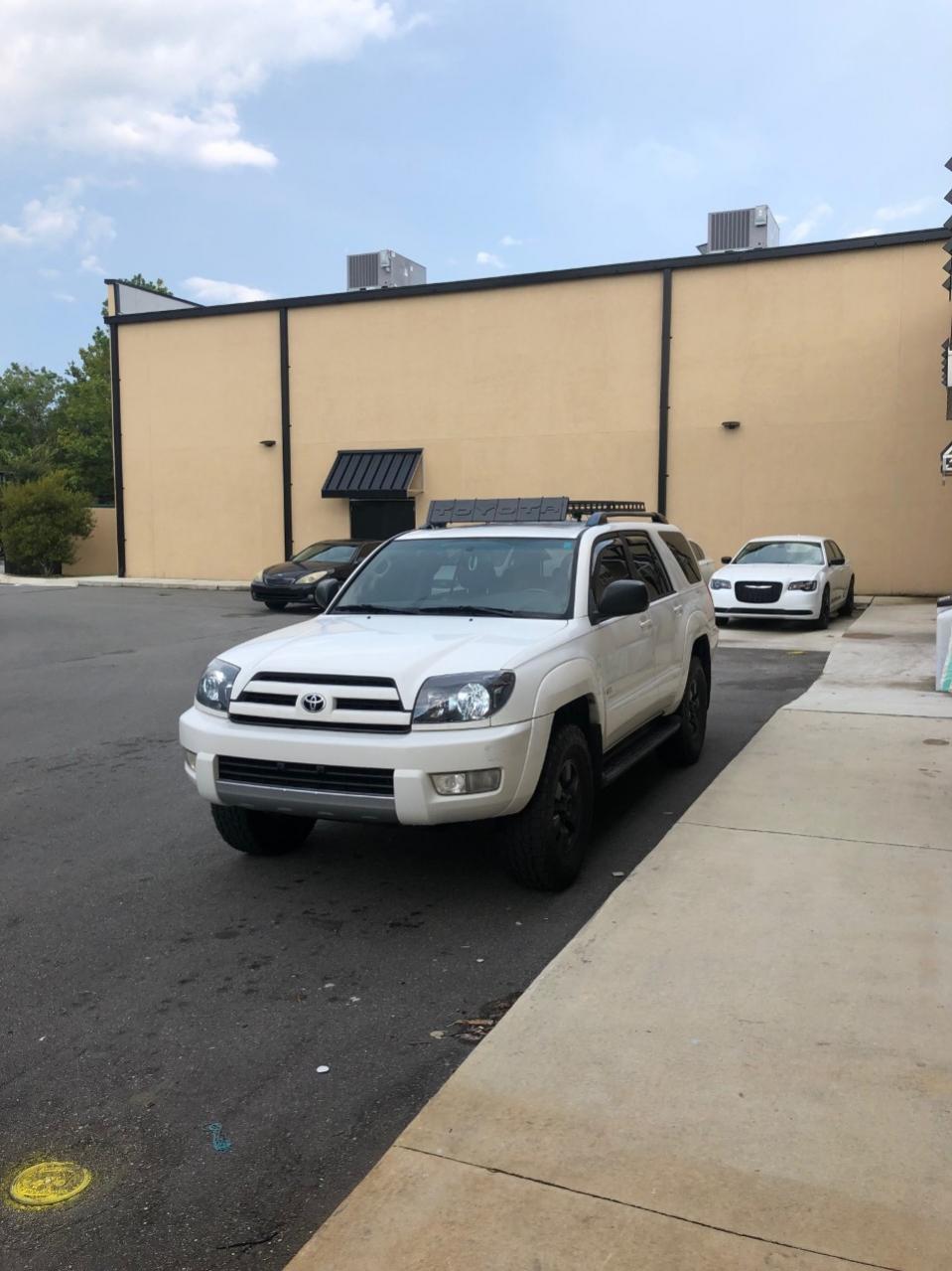

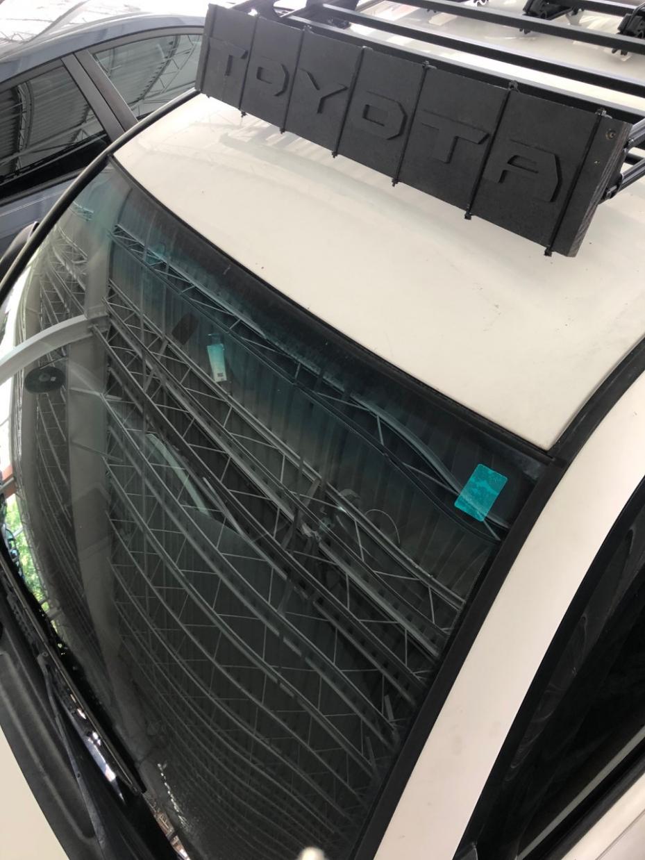

DIY Wind Fairing
CNC Aluminum eBay Letters for $45. Pine plank 36"x6" x 3/4thick $5.
Hammered Paint & Primer $8.
My fasteners were too big for the crappy Roof Rack I had, so I just Zip Tied them and was surprisingly content with the way it ended up. I will likely fasten it properly later on; but it did the job.
Roof Rack is 2x of
Apex Low Profile Steel Roof Cargo Basket - 39-1/2"L x 36"W x 2-3/4"H | Discount Ramps
Installed together as one.
Sorry the images are f'n Massive.
