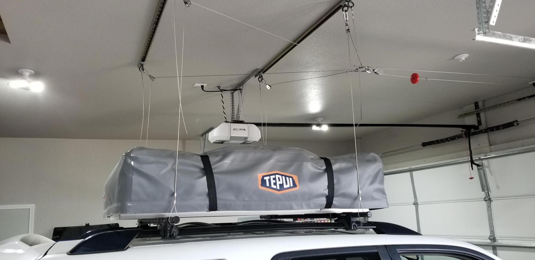

This is exactly what I'm looking to do for my RTT! Would you mind sharing the parts you picked up to help this engineering-tarded fellow Coloradan?

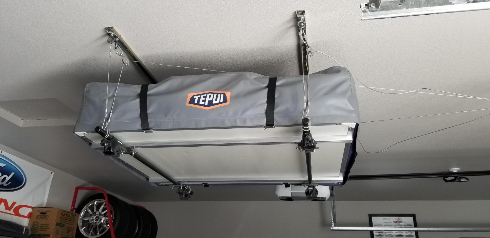

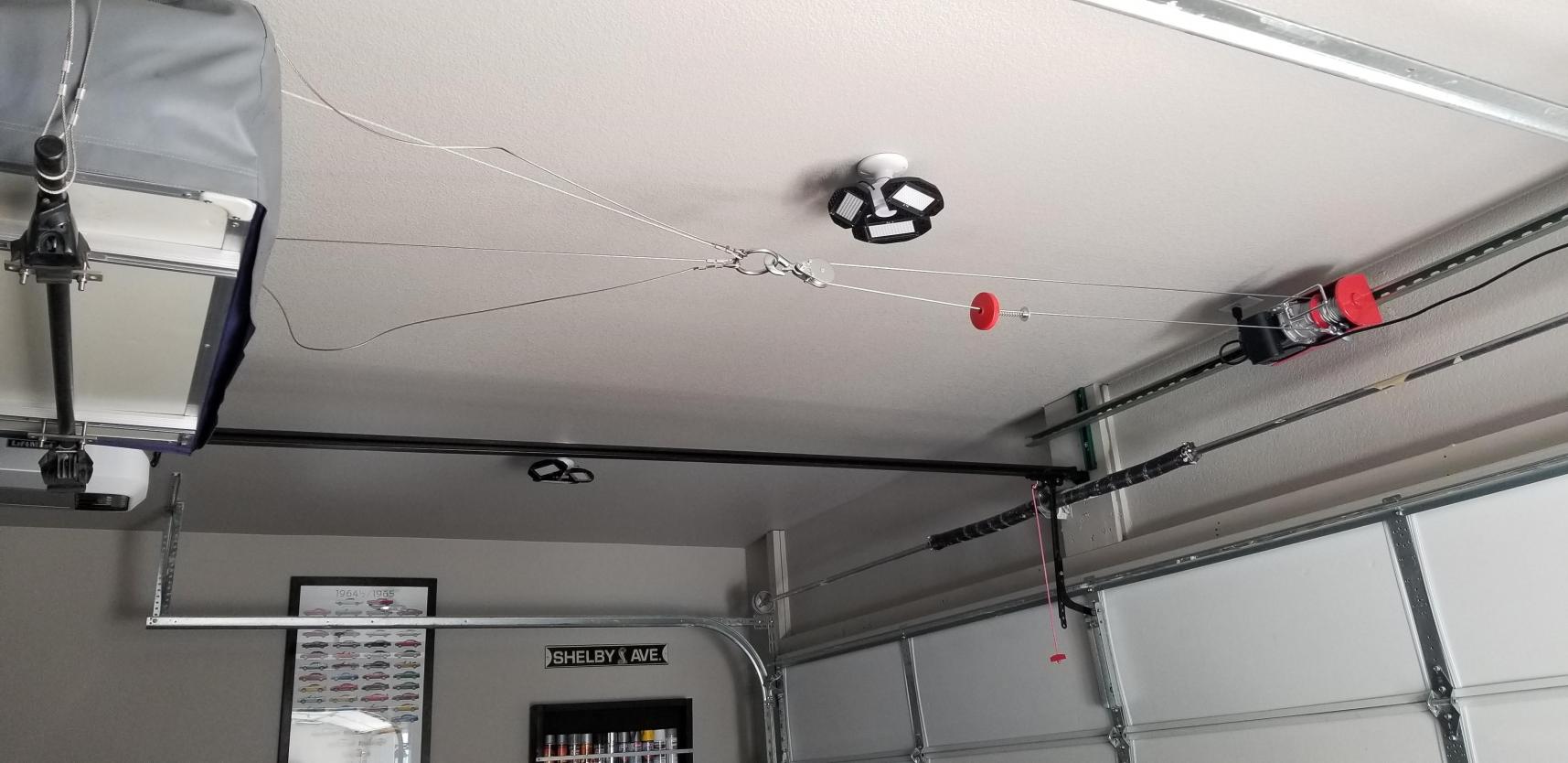

Here is my parts list:
1. Remote operated electric hoist (880lb double line/440lb single) - Harbor Freight. It's overkill, but I had a coupon
2. Unistrut 20ft (1 5/8 slotted) - Home Depot
3. Stainless Steel 316 Round Ring Welded 3/8" x 3"
4. 1/8 Inch Aluminum Crimping Loop Sleeve for Wire Rope
5. Stainless Steel Thimble for 3/32" and 1/8" Diameter Wire Rope
6. T316 Marine grade 1/8 inch Stainless Steel Aircraft Wire Rope Cable, 100ft
7. 100Pcs 1/8" Aluminum Crimping Loop Sleeve Crimps
8. 16Pcs M3 Stainless Steel Thimble Rigging for Wire Rope Cable
9. 3/8" X 1 1/4" DROP FORGED MACHINERY EYE BOLTs, qty 8 (Chicago Hardware)
10. Threaded Quick Link Carabiner 5/16-Inch Diameter, 2-Pack x 2
11. IWISS Wire Rope Tool for Swaging
12. All thread, 3/8 (1ft)
