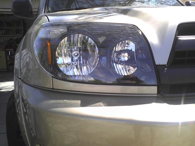

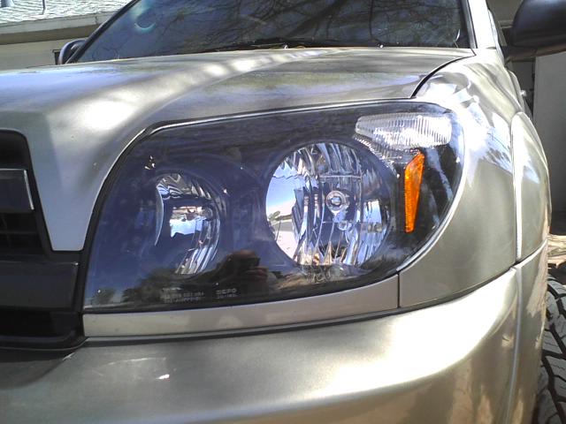

Depo blacked out headlights
Sorry to lazy to do the mod , and don't like baking either ! And I did it on hump day , did it during 1st half of bulls/heat game . Minor profanity & a few cuts but looks nice , decent fit , better than some I've seen n earlier styles . I know pics manana !! :couch2::vader:
Bam
Hope they show up good enough to see ?

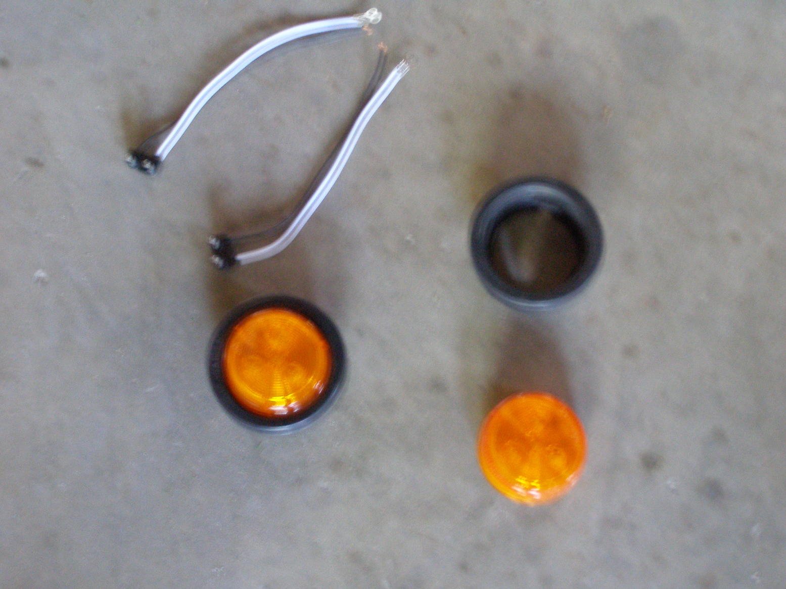

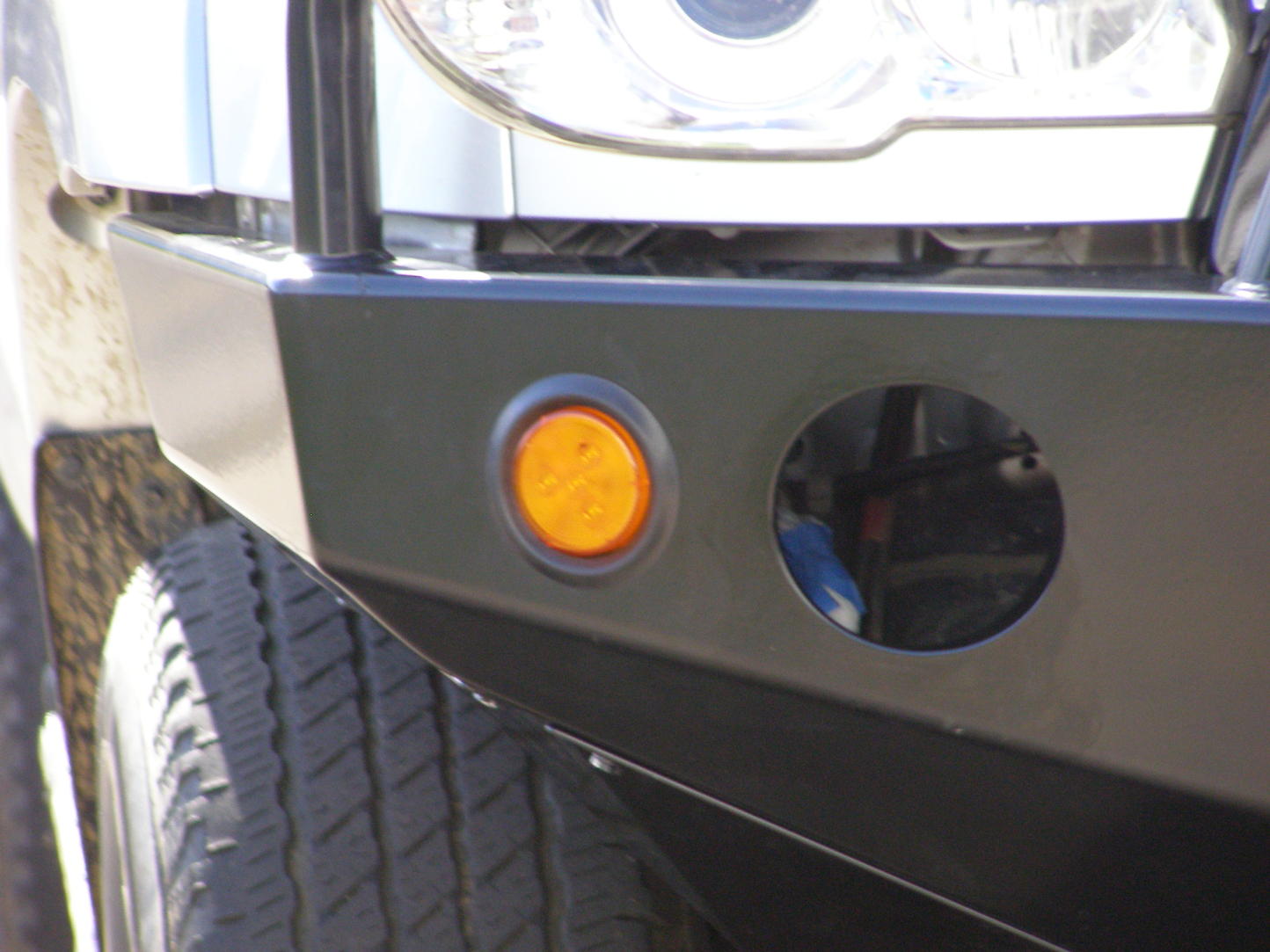

Decided to fill the running/signal light hole with these. All for $20. These are
2 1/2" round, so had to break out the die cutter and cut the inner round piece out. Continue with opening the hole another 1/4" to make them fit. Primer and paint the bar metal. All water proof led running lights.
Had the day off, so was an early weekend mod.

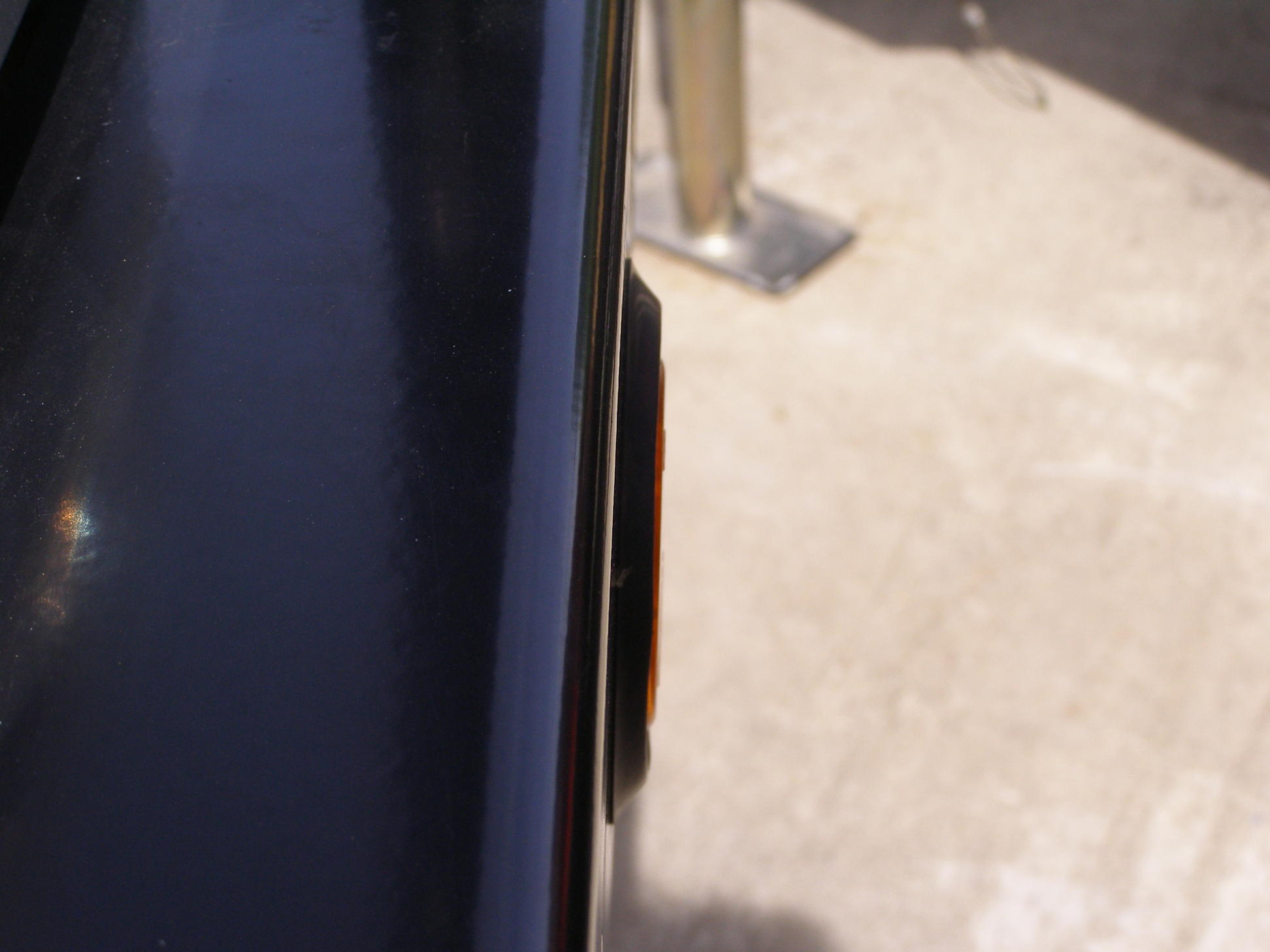

So what did you do to make them fit ? Punch the hole out bigger ? Mine stick out and it is driving me nuts.
The inner round piece that sits behind the bumper, took a die grinder with a cutting disc smaller diameter than the hole. Had to cut through the welds that hold it on, with an assist of a chisel. When the piece was out, used the wheel and smoothed out the weld flat. Used a thicker disc and reamed the hole larger.
Put the light in the hole, larger side and made sure it had 1/8" larger diameter than the light. Press the grommet into the groove slot and had to use the screw driver to help slide the light in. Didn't want to make the hole to big.
It sticks out 1/4" from the bumper.
