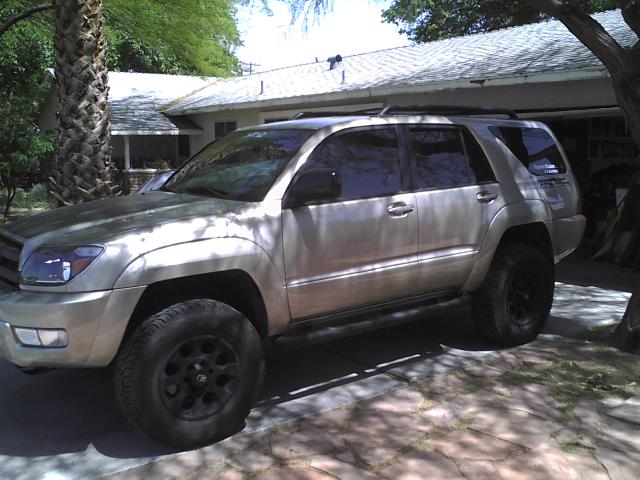

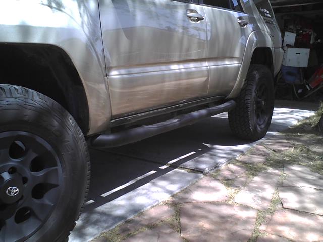

BIG thanks to Chmura this was my wknd mod , hope you can see them , 1 day trip killed 2 birds deal my son had BBall tourney n Corona so it was a perfect fit ! I was glad to find these & nice of him to hold on to them , found I needed steps with my mild lift , to get my ol ass up ! :thumb:
Lookin' good, glad you like them!
