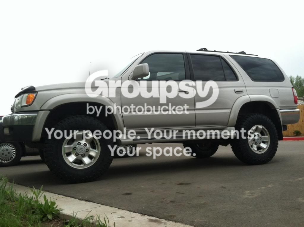

Currently:
<a data-flickr-embed="true" href="https://www.flickr.com/photos/131523454@N04/28216856071/in/dateposted-public/" title="done"><img src="https://c8.staticflickr.com/9/8624/28216856071_ab9e2c24c2_b.jpg" width="800" height="533" alt="done"></a><script async src="//embedr.flickr.com/assets/client-code.js" charset="utf-8"></script>
2000 SR5 4WD 5-speed w/E-locker 220k.
Engine:
--3.4L V6 (5VZ-FE)
--2nd/4th gen TRD Supercharger (black)
--TRD dynamic belt tensioner
--Airaid Intake Tube
--Denso IK22 Spark plugs
--TRD oil fill cap
Transmission
--5-Speed Manual (R150F)
--Marlin Crawler short shifter
--4x Innovations transmission mount
--Marlin Crawler stainless braided clutch line
T-case
Front:
--Toyota RF1A reduction housing
--Trail Gear Tacoma Dual case adapters
--Marlin Crawler 23spline (total spline) input gear
Rear:
--Stock t-case
--RADesigns Triple sticks
--Front Range Off Road Tacoma crossmember
--Custom drive shafts by Northern Colorado Driveline
Tires/Wheels:
--285/75R16 Goodyear Duratrac - Load Range E (x5)
--FN Wheels Five Star 16x8 3.52" BS (x5)
Suspension:
Front:
--Toytec BOSS Coilovers #600 springs (silver)
--SPC/Light Racing UCAs
--Toytec Diff Drop
--Front Sway Bar Removed
Rear:
--OME 861 Coils
--Bilstein 5100 (4th gen/FJ) extended travel shocks
--Toytec Adjustable UCAs
--Daystar progressive bump stops
--Toytec Panhard drop bracket
--Front sway bar links in the rear
Exterior:
--Shrockworks front bumper
--Shrockworks rear bumper w/ swing out tire carrier and jerry can holder
--Shrockworks sliders
--AVS in channel vent visors
Armor:
--Budbuilt front skid
--Budbuilt belly pan
--Budbuilt diff skid
--Lotus RCAMS
--Lil' Skip's fuel tank skid
--Rear lower control arm skids
Lights:
--PIAA 510 (set of 2) in bumper fog lamps
--PIAA Night Tech headlight bulbs
Recovery:
--Warn M8000s winch with synthetic line
--Wireless Winch controller/remote
--Shrockworks aluminum fairlead
--Factor 55 ProLink
--Smittybilt D-ring receiver
--48" Hi-Lift X-treme jack
Interior:
--Weathertech floor mats front and rear (black)
--Matching OEM grab handle added above drivers door
Audio/In dash:
--Pioneer Appradio3
--Innovate Motorsports Boost Gauge
--Innovate Motorsports Wideband
--Uniden PRO520XL CB radio
Expo Stuff
--ARB 50qt Fridge/Freezer
--Dual Batteries (Optima red top and yellow top)
--National Luna dual battery monitor/controller
--Custom rear drawer system
--Onboard electric water system (by www.livingoverland.com)
Misc:
--Sonoran Steel polyurethane body mounts
--Relocated Washer fluid reservoir out of wheel well (w/ Mishimoto MMRT-CA)
I didn't take any pictures of it clean when I bought it.... to busy driving it!

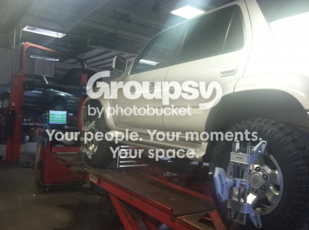

Soon after the tires went on and after consulting this forum for countless hours I decided upon a lift. OME 881s on 90004s in the front and OME 890s with 60028 shocks with in the rear.

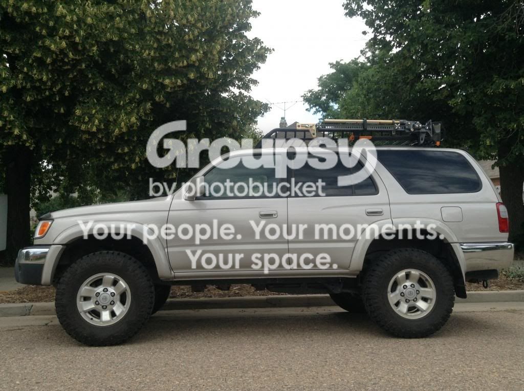

Again came back to this forum and thought... hmm those roof baskets are pretty cool and I do carry a lot or camping gear often. Wanted something low profile and fairly long being as I don't have a sunroof. so I picked up the Rola Vortex with extension. Went exploring again and really liked throwing stuff into the basket while I set up our sleeping pads in the back.
[MENTION=94888]EatonKyleH[/MENTION] I saw you threw your name down for FoCo on the "i'm stuck" thread. When I get back up in mid August we are going to go hit some trails and your welcome to join in!
More importantly your truck is looking real good! Loving the rack and its going to look awesome with those sliders. Keep it up!

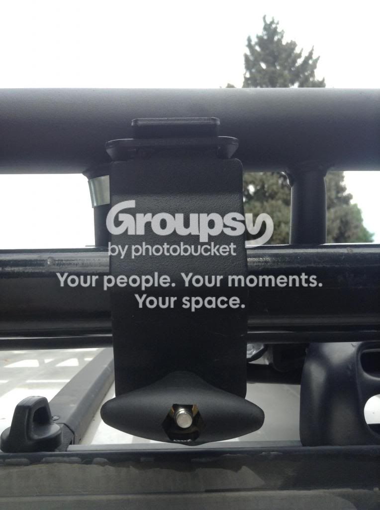

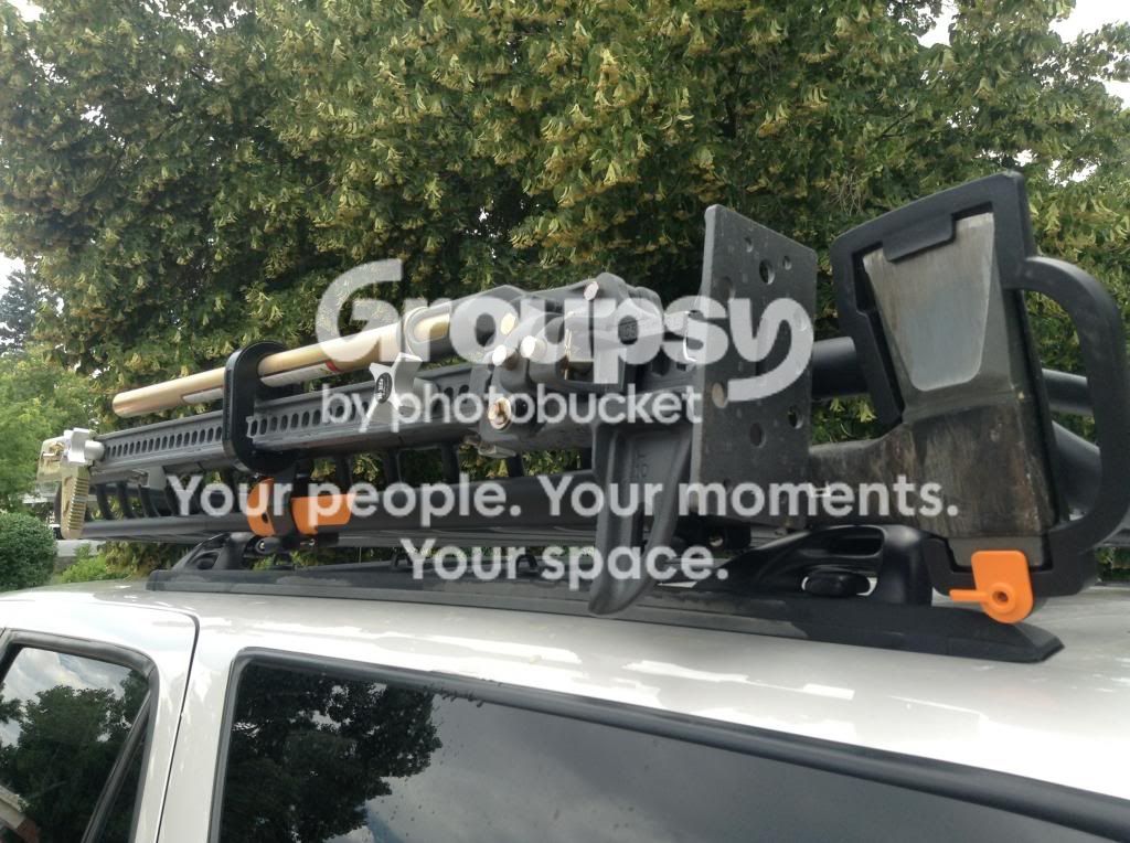

I've been focusing on my roof basket a bit. I modified the factory Rola mounts to sit around and atop the factory crossbars instead of entirely on top. This dropped the whole basket a little over an inch and the factory crossbars sit in-between the bars of the basket. The top of the crossbars are exactly flush with the top of the baskets tubes which I like for securing heavy objects to the crossbars instead of just basket tubes.
I then bought some Yakima axe and shovel mounts not knowing if I'd have any way to fit them. Turns out they fit perfectly if you turn them and hold your tongue the right way. They fit and look awesome honestly like they were designed for it although they are technically upside down. Loosen it up and slide the axe or shovel out of the brackets toward the rear or take the front plate of the mount off. They work great and have no noise or looseness. (Someday I'll repaint the factory roof rails)
Then I got around to mounting my Hi-Lift. I used the Hi-Lift TM-700 tube mounts. These push the jack out just enough to clear my rack and axe entirely while I can still access the axe mounts and easily remove the axe without removing the jack or vise versa.

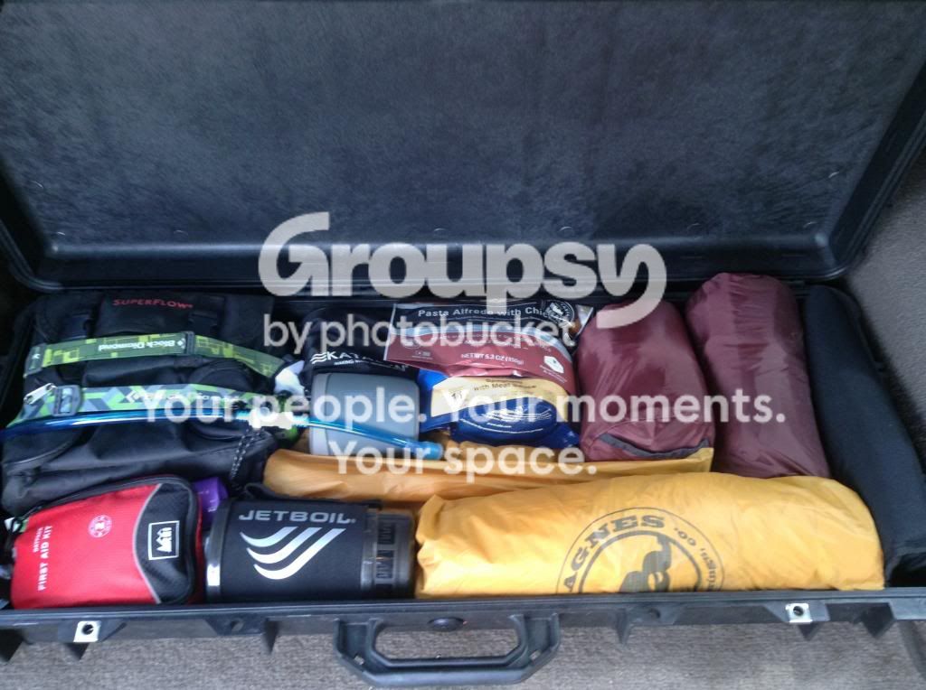

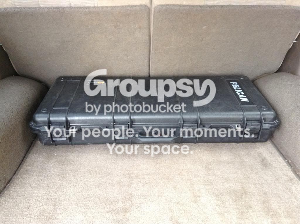

So I was trying to figure out how I would organize and carry the gear I wanted in the back but be able to remove it in less than a minute. I had an old gun case in the basement that I pulled out and played with because of a wild hair one day. To my surprise it fit perfectly between the wheel wells. I put Velcro on the bottom side to secure it to the carpet and allow for easy removal. I can pull it out extremely easily and throw it up on my roof basket when sleeping in the back or running errands. It is entirely waterproof, lockable with factory key and additional padlocks, crush proof.
Enter the Pelican 1700 case
What's in the case you ask? The gear nerd side of me is just dying to tell you!:nerd:
1 - Big Agnes Fly Creek UL 2 tent
2 - Big Agnes Insulated Air Core sleeping pads
1 - REI Flash UL Daypack
2 - 3 Liter Platypus Hoser water bladders w/quick disconnects for purifier
1 - Katadyn Hiker Pro water purifier/filter
1 - Q Industries MV50 Air Compressor
1 - Jetboil Flash System and butane can
1 - First Aid Kit (heavily supplemented)
2 - Headlamps (Black Diamond Storm and Spot)
1 - Glock 19 Gen 4 w/15 round factory mag
2 - Set of GSI stackable bowls
Fire starting gear including....magnesium w/shaver and striker, lighter, waterproof case w/ matches, Coghlan's Fire Paste. (inside bowls)
1 - Sea to Summit insulated mug
1 - Mini roll of black duct tape
4 - Assorted freeze dried foods
1 - Roll of light duty rope
1 - Sunscreen, toothpaste, and sea to summit wilderness wash (gotta stay clean for the ladies)
1 - LaRue Tactical Beverage Entry Tool Dillo LT205 (can't be getting stuck without your favorite bottle opener)
probably missing something but you get the idea.
It's all extremely light as backpacking gear should be in my humble opinion.
Sounds like a lot... doesn't weigh like it.

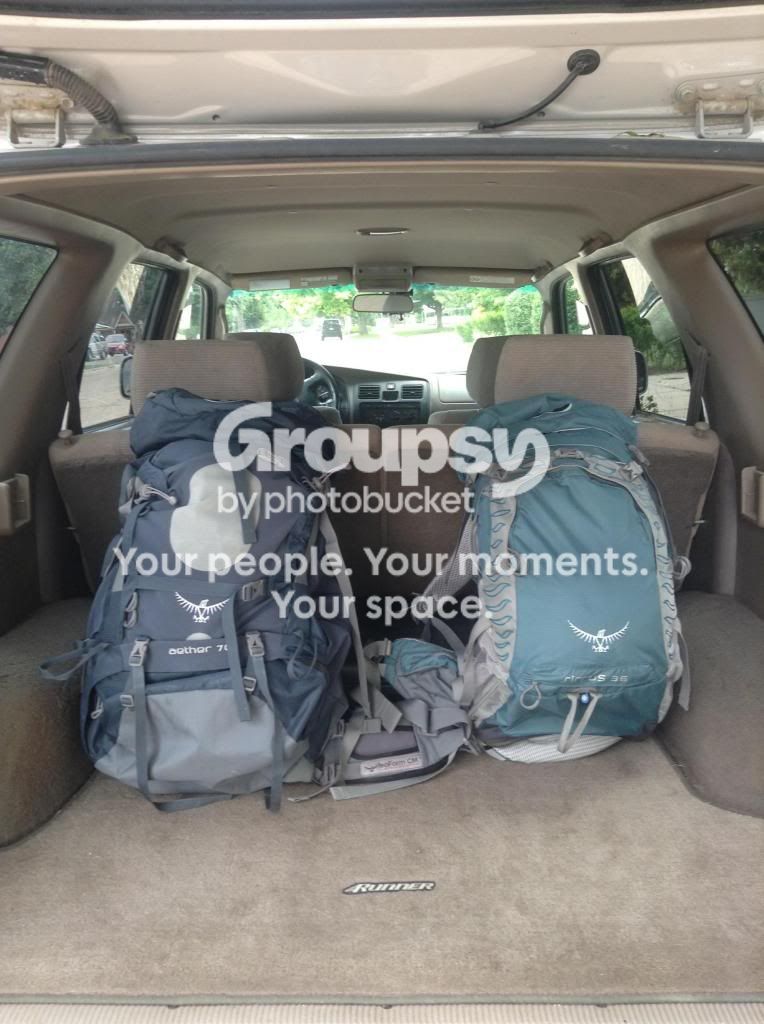

Then sometimes I throw our packs in there with the rear hangers of the packs around the rear head rest rods. This keeps them from going anywhere. The sleeping bags are in their compression sacks (uncompressed during storage) in each pack. Good place to store our gear and be ready for anything. Still a ton of room in the back as everything is right up next to the rear seats.
1 - Osprey Aether 70 Liter
1 - Osprey Sirrus 36 Liter Packs
2 - North Face Cat's Meow Sleeping bags 20degree

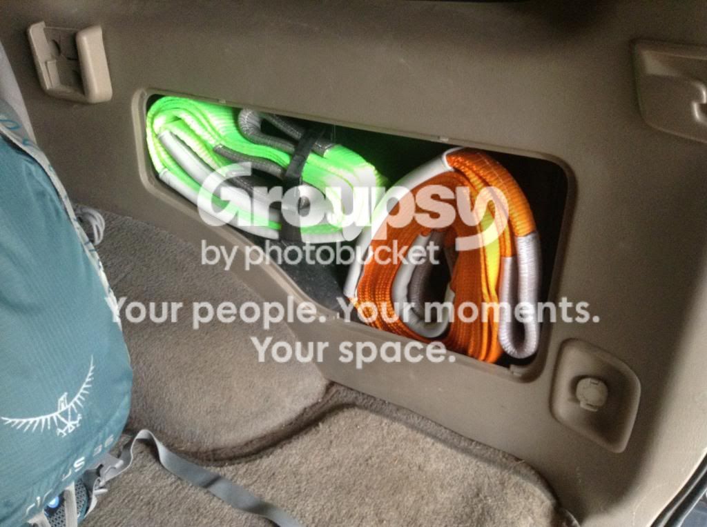

Oh ya.... and here is where I put my straps the cover still fits over like normal.
1 - ARB snatch strap
1 - ARB tree saver strap
