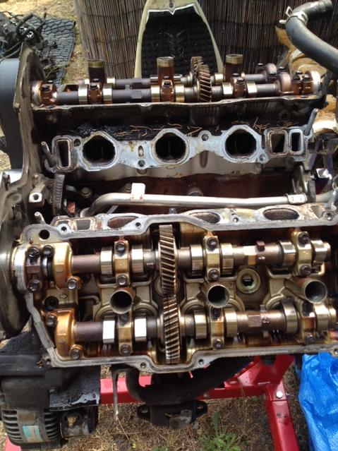

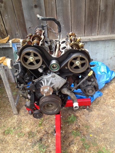

After putting my 5VZ-FE on the engine stand I drug it across my backyard. In hindsight, I think heavy object on wheels + uneven grass,weeds and dirt = living nightmare and what I should have done is either left the wheels off the stand entirely or maybe made a makeshift sled to slide it easily across the uneven surface.
So I got it where I wanted it and yesterday I got the throttle body, and engine harness off. I had one heck of a time putting the engine to TDC because when I inspected the crankshaft and rods etc through the oil pan I removed the caps and rod bearings. When I would turn the crank, it would push the pistons up but it would not bring them back down causing interference with rotating the crank any further. What I did was simply pull the pistons down with some plyers over and over again until the crank was in the desired position.
I also realized that the way I assembled the engine stand makes it impossible to rotate the engine fully. Some bolts get in the way. This isn't super important to me but it did make it a pain to getting to the underside of the engine. It is still a whole lot easier than it would be if it was still in the truck though!
I am still unsure as to what my plan is but I have decided to take the engine apart while I save money for either a rebuild or used engine. I am thinking I want this truck for a long while so I am a little nervous about a junkyard engine and I am a little too strapped for cash to buy an already rebuilt engine so I am just moving forward any way I can. We will see what happens I guess.
What are some important things to consider when dismantling an engine? I remember when doing a head gasket on my SAAB some years back, timing was everything and that is why I rotated the crank to TDC. Other than that, I have been just taking stuff off and hoping I remember where it goes haha

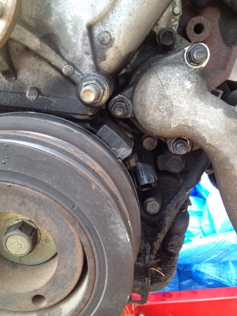

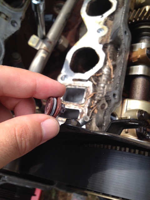

Major props to whoever can tell me where the heck that little brown plastic piece is that I am holding in my hand in one of the pics. I found it lodged in the hole just next to it in the pic... All I know is it sure shouldn't be there. Makes me wonder what else is floating around in my engine.

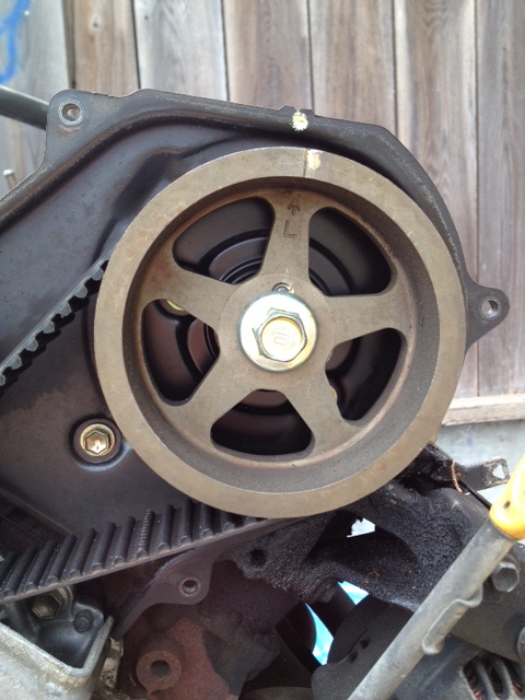

I am stick right now. I need to find out how to remove the heads. I really don't want to bend any valves...been there done that on another car. That being said, I am pretty sure I need to get the cam shafts free from the sprocket that meets the timing belt. On the SAAB I worked on it had a nice area on the camshaft to place a wrench so I could give the bolt holding the sprocket to the cam shaft some torque without moving the cam shaft and potentially bending valves.
This looks a little different in the 5VZ-FE.
Anyway, please help, I need all I can get.

I'm blind, I see that there are places on the cam shaft to secure with wrench so I can remove the camshaft pulleys. :lol:

I have most of what I can take off separated from the engine. I am however, having a heck of a time separating the cam shaft pulleys from the camshafts. I am using a 10 inch wrench on the cam shaft flats and a large socket wrench on the 17mm pulley bolt. I am using everything I have and it doesn't budge. I sprayed some penetrating oil and still nothing. I am unsure as to what to do at this point. Any suggestions?
That being said, I haven't successfully separated the heads from the block yet. Once I get the heads off, one of the only other things left is the crankshaft pulley which I anticipate will be even more difficult than the camshaft pulleys I can't separate at the moment. :pray:
Impact gun and sockets.
Unfortunately I do not have access to that. I would buy some but I think it might be cheaper to have the machinist take the stubborn bolts off for $80/hr. I bought an 18" breaker bar and am trying that... This is unusually difficult. Also, I hope I haven't bent the valves. We will see once/if I get this off.
