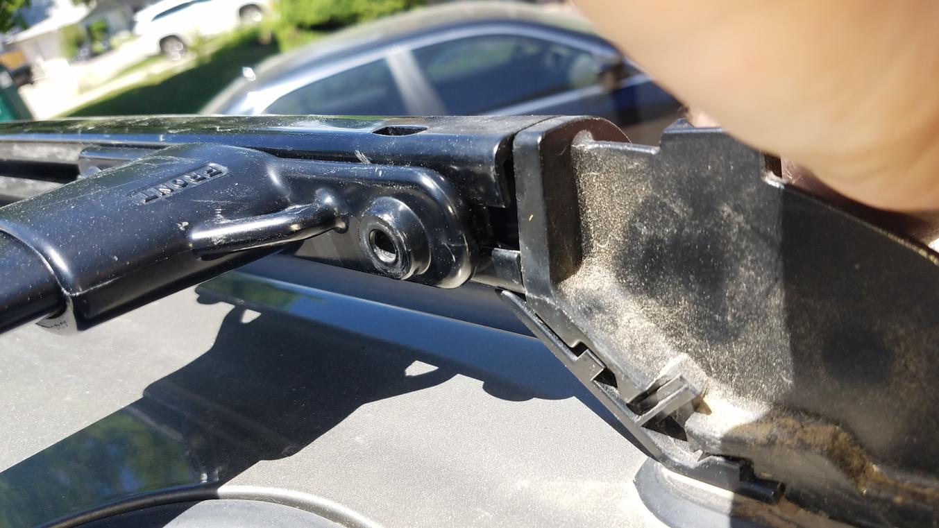

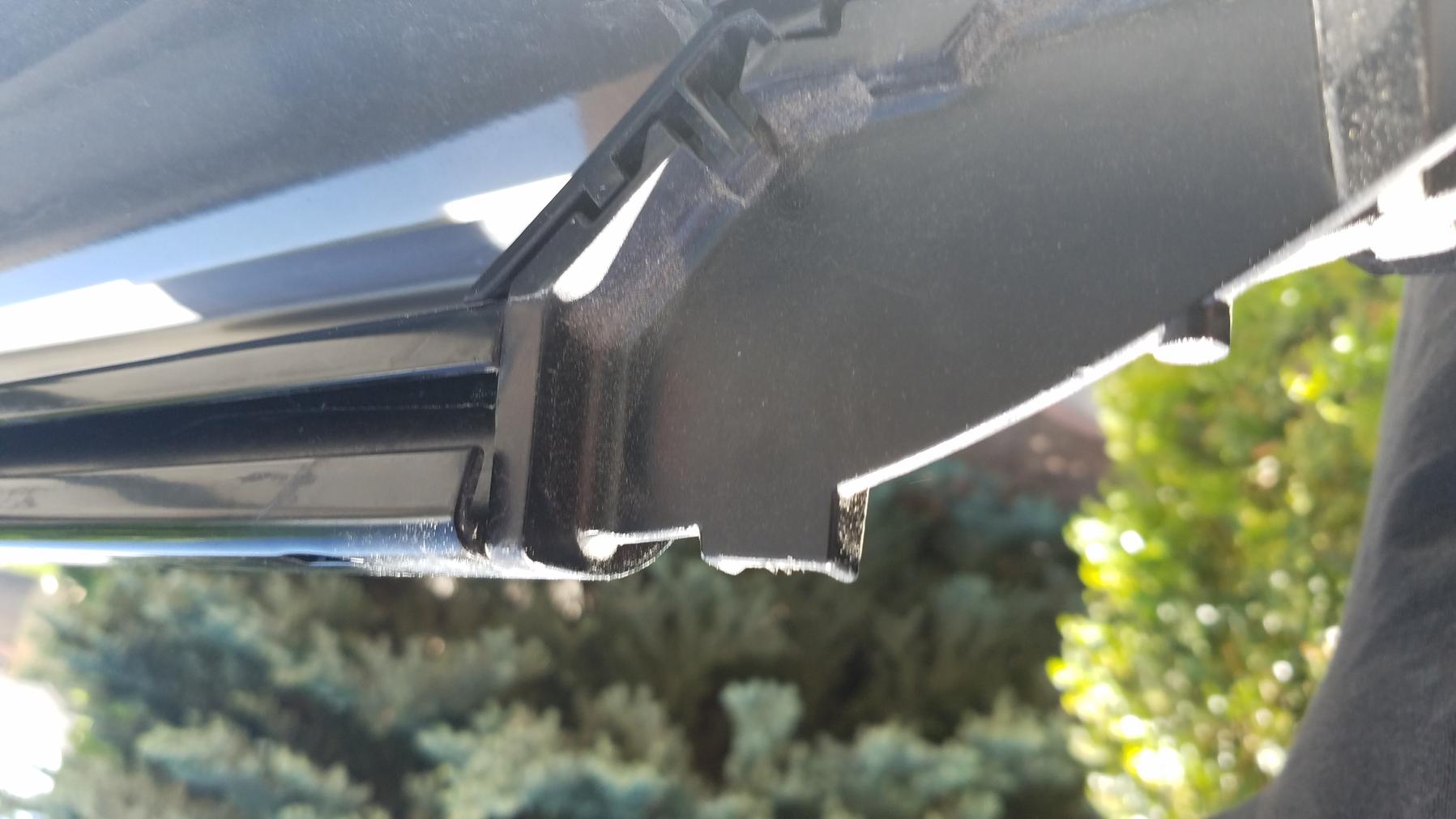

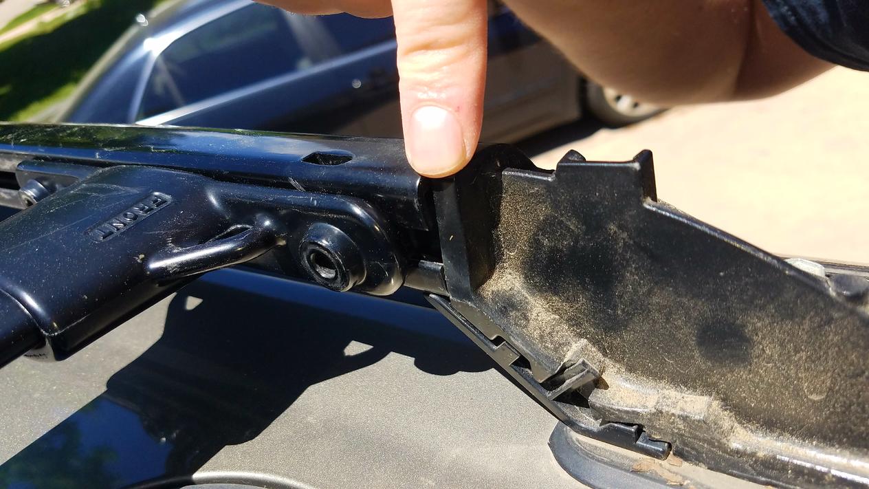

Hey all I've followed this thread and pulled the trigger on a Rola with extension as well as low profile mounting kit from 4x innovations. Unfortunately, 4x innovations didn't send any install instructions. After looking at some user pics and examining the equipment, I figered out the basic layout...but cannot for the life of me get the factory crossbars off. I popped the corner brackets but they are preventing the crossbars from sliding out. I'm waiting for 4x innovations to get back to me but does anyone have any advice? I don't want to cut the crossbars unless necessary. Thanks all!
Once you pop off the plastic covers on the corners and remove the rubber pieces in the channels, you should be able to loosen the knobs on the crossbars and slide them right out.

Semi-correct. You have to actually remove either the front or rear "foot" from the rail to be able to slide the cross bars out. To do that, you have to remove the plastic cover and then the two bolts which hold each foot in place. (That is for the Sport Edition roof rails. You may not need to remove the foot for the SR5 or Limited rails.)

is yours a 06 and above sport? the tube style rack requires that you undo one of the mounting foots to slide the cross bars off.

Thanks for so many replies so fast, its good to see this is an active forum even on an old post. Attached are more detailed pictures. I have an 07 v8 4x4 limited with the standard more flat rails than the round ones on the sport. Thanks all!

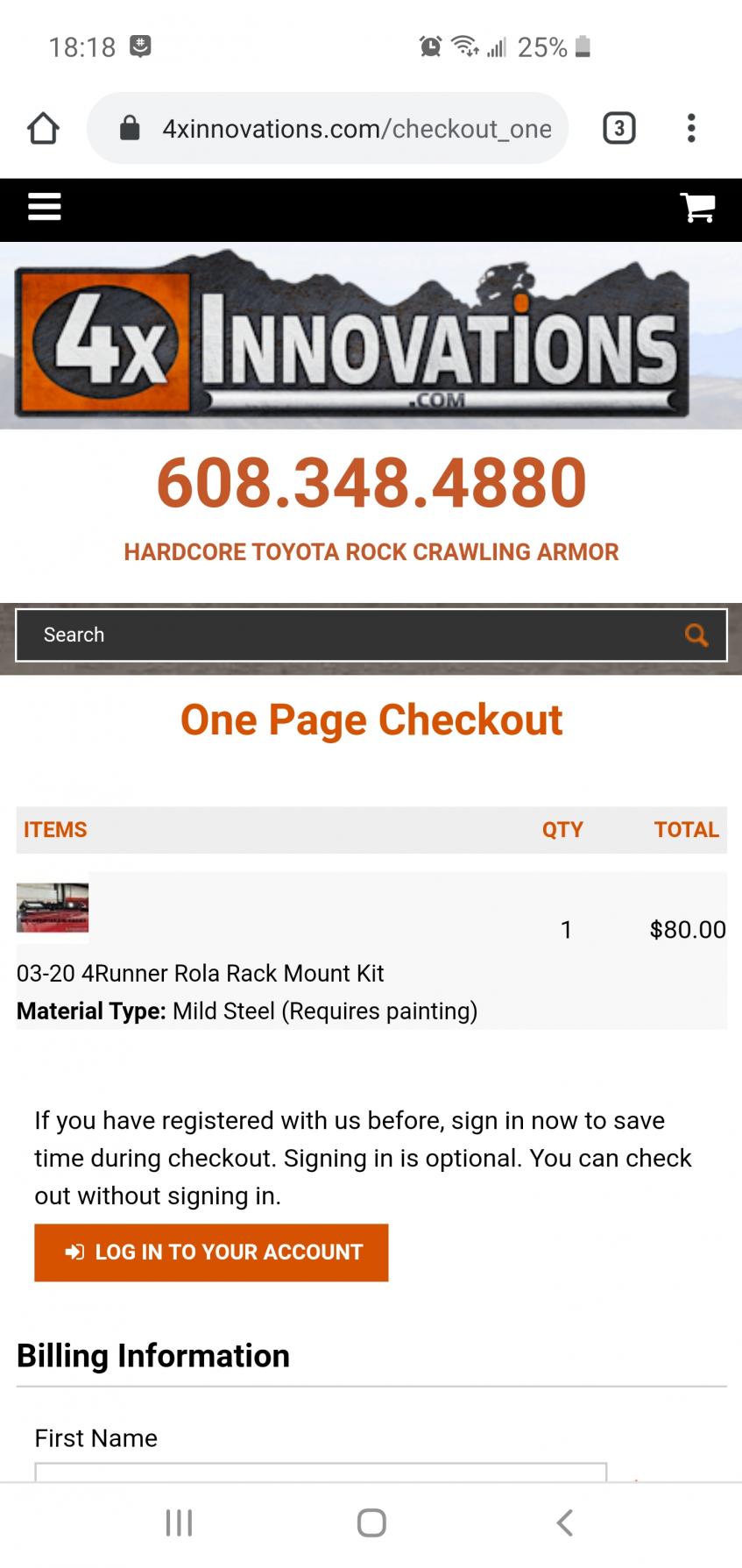

Anyone have problems buying the lowering mount from Armor Tech offroad? Everytime I try to do it, my browser says it's not a safe website and wont let me actually purchase them. Even going through Paypal it doesnt work. Thoughts?
I had the same problems, but saw 4x innovations has a similar kit if not the same
