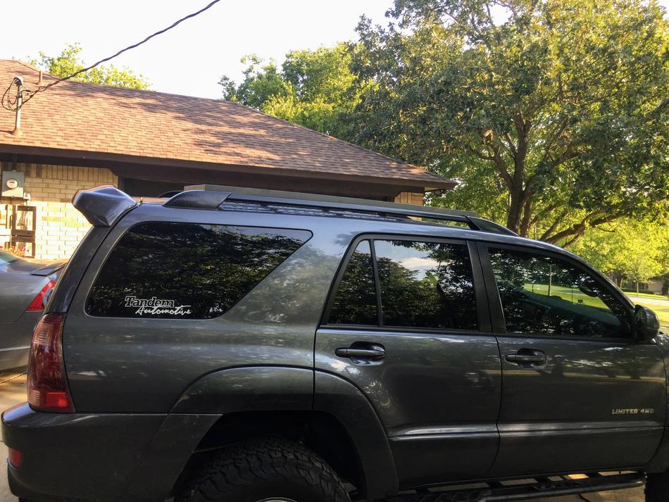

I make and use a similar style mount for my roof racks, and I don't think I'd sell a mount set for less than $75 with the hardware and powdercoated. But I make and drill them entirely by hand.
