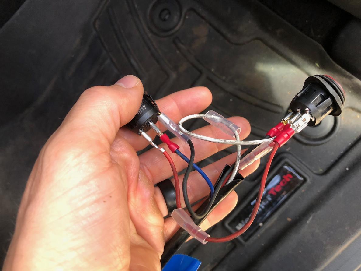

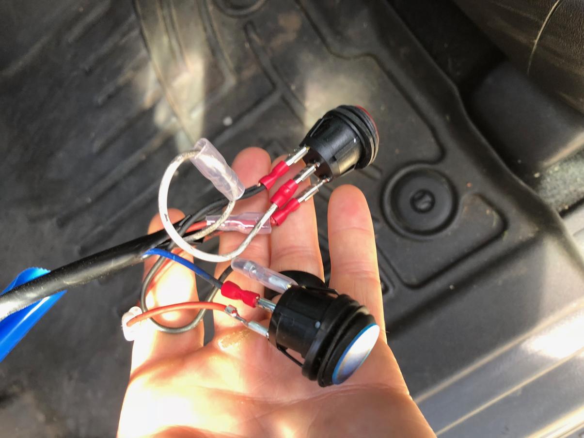

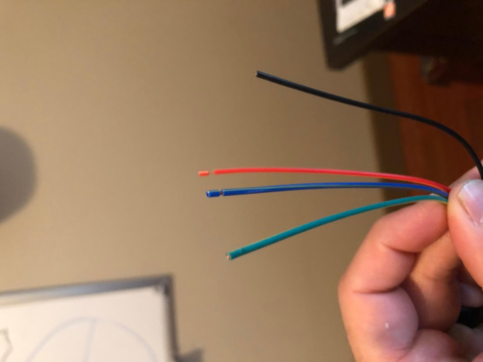

i bought two AOB switches i'd like to install to replace the two rigid harness switches for the clean look. I prefer to not tap into the factory lights and have the light bar operate completely independently. I'm having trouble connecting the rigid harness to the AOB switch harness (pic'd below) Can you help me with the wiring?

For the blue and black wire, you will need to tap from any existing oem switch already plugged. This powers the back light and provides the ground. Green wire needs to go to an activation source... since you want it to be activated soley by the switch and not with "high beams" for example, you can use an add-a-fuse and find a hot fuse slot to use as you activation (whether car started or not). I recommend using a multimeter and finding a slot, I forgot which but there is a empty fuse slot. OR you can tap into another source like a cigarette port or something. Red goes to your relay... sorry for this quick write; im on my phone and its 12am. [emoji28]

Thanks for the quick reply, i thought since the existing switches from rigid are not tapped in to any oem wiring then shouldn't i be connect rigid harness to AOB switch without any additional wiring to OEM components or adding an additional fuse...there is a 20a fuse inline on the rigid wiring harness as well?
Are you running a relay as well or does the switch go from [battery -> fuse -> switch ->light]? The AOB switch works little differently as the green "activates" the switch to use, the red triggers the relay to push power, blue to turn the back light on and black to ground. Not entirely sure if you could reuse the three wires but the negative.
Is your rigid wiring like this? If so you might be able to reuse them.

yes works like that, relay is inline with the AOB switch. the difficulty is the LED light bar has two switches one for the back lighting on the lightbar and one for the LED spot lights. here is a pic of what i'm working with. you can see the red and black run to both switches.

Ah ok, so the red and black are power/ground and the blue/silver is for back light/main light. Are you trying to run two AOB switches, one for back light and one for main? If not you may need to, to gain benefits to both. Run like the first diagram i posted but each switch goes to the intended blue or silver wire. You will still need a trigger source ie a fuse slot, cigarette port, etc and the back lighting which could run off the same source as the trigger or you can tap the oem buttons.

That's right i bought two switches, one for the backlight and one for LED spot lights. Can you dumb it down for me and give me specific (AOB )color to (Rigid) color + what of each runs to fuse slot?
