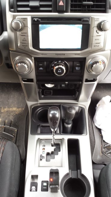

They also fit center console knock outs too......can you say dongle :naughty:

Has anyone mounted these factory style OEM replacement switches in their center console in the heated seat knock-outs to control their fogs?
If so, what wiring are people hooking into to light their switches in the center console?

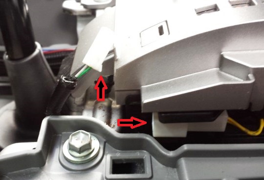

Did dongle mod a couple of weeks ago, connection was made at shifter illumination circuit indicated by arrows..............
Green wire 12 volts when parking/headlights are turned on, gray wire is ground. These connections will allow illumination circuit of switch to dim with factory rheostat.
