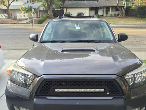

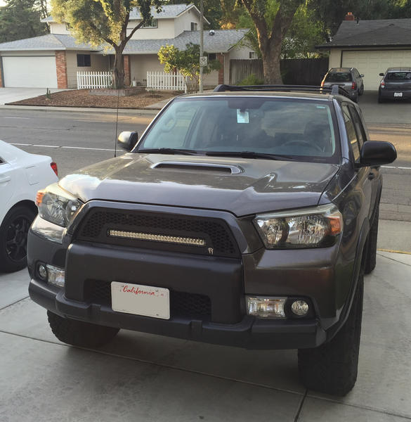

Here are some awful photos of my dirty rig. California drought has kept me from washing it for a while.
I'll probably get it cleaned up this weekend and take some better photos of the truck, grill, and switch installed.
4funnr-albums-rigid+led+light+bar++grill-picture33946-rigid-led-light-bar-grill-closeup.jpg
"Here are some awful photos of my dirty rig. California drought has kept me from washing it for a while..."
NO EXCUSES! "Open a door and let's see the "Factory (style) Fog Light Switch-fits knock-out! just like it says in the title!!!" :dancin:
Cheers!
Looks great [MENTION=46530]4Funnr[/MENTION]! Like how you used black hardware instead of the bling-bling Rigid provides.

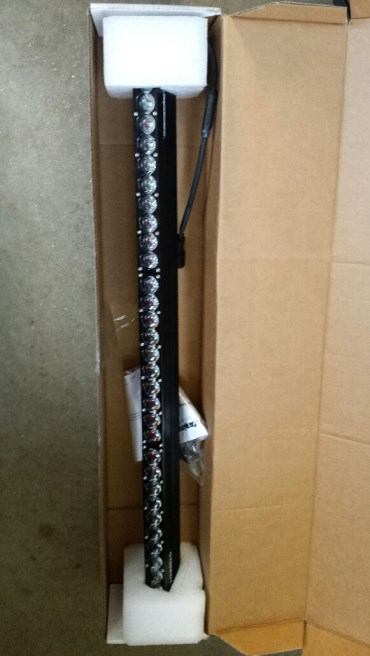

Guess what arrived yesterday :whoo:
Big thanks to Chas and Mike at [MENTION=120150]TotalAutomotiveLV[/MENTION] for the smokin' deal and great customer service!
You know you have a problem when you're on a first name basis with FedEx & UPS drivers :loco:

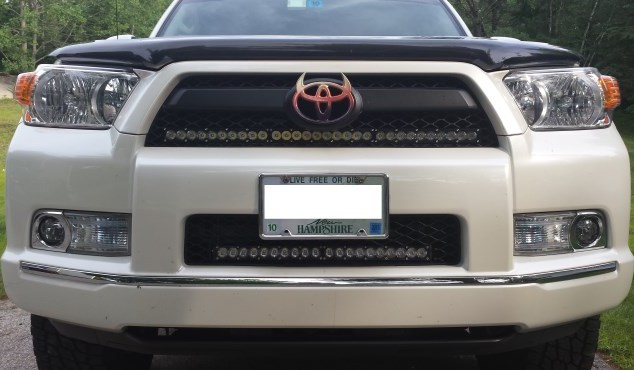

Yeah [MENTION=120150]TotalAutomotiveLV[/MENTION] hooked me up for the Rigid Grill and 20" LED bar. Awesome pricing and pretty fast shipping!
Thanks!

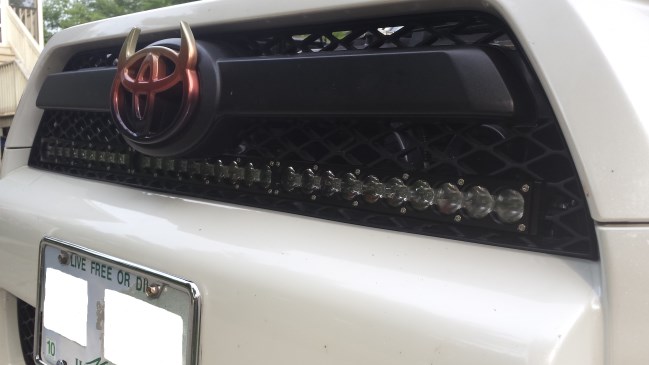

Who said a 30" light bar won't fit in the upper grille of a 2012 SR5? :flipoff:
Had the day off today, took about 4 hours start to finish.

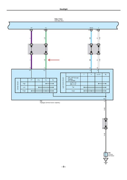

My question...I've read through the post and I like the idea of having the relay tied into my HB. My 16 has DRL's that gives continuous power (albeit at a lower voltage) to the HB's. I can't use the HB + to tap the relay into it because won't it always be on?
I know i can disable the DRL's, but I have LED's in there now and they look great during the day. They aren't that great as a HB, but my HID's give me enough light most of the time. Thus the light bar...
Easy way would be an independent switch, but after reading the thread I like the HB option (if the DRL's will allow it).
thanks in advance,
Great thread. Lots of great info.
I have this on my to do list. I have the brackets on order as well as the LED light bar.
thanks in advance,

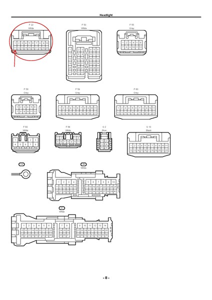

Thanks bowhun2r.
Think it is possible, you could possibly tie into the high beam wire at the headlight switch. Attached is a Techstream wiring diagram for a 2016 Runner for your review. Caution - Before making any connections, test with a meter to verify proper operation!!!!
Light Green wire (pin #11) should send a ground signal to ECU when stock is moved to high beam or flash to pass position, ECU then triggers high beams. Adding a second relay using LG wire as ground trigger should accomplish what you're trying to achieve without affecting DRL's. Also, make sure relay has an internal diode to prevent back feeding OEM wire, if it doesn't, you will need to add one.
Possible second relay terminal wiring;
30 & 86 - 12 volt battery or ignition (+ positive) fused.
87 - Run to AOB Red wire, this is a + positive output that will trigger LED light relay (main relay).
85 - Light green wire from high beam circuit (- ground trigger).
Please post back with what you find and/or do. Good Luck!
