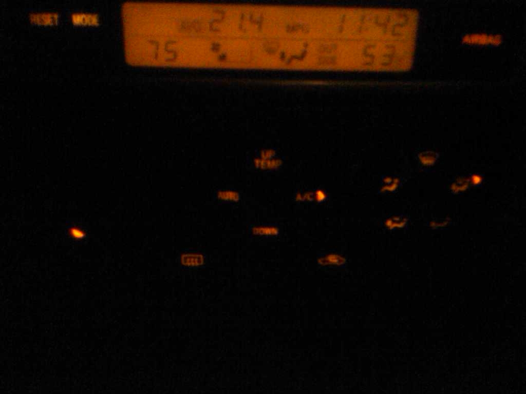

The illumination is out on the fan control lettering on the climate control panel.
NOTE: However, the Low, Med, High indicator arrows stay lit.
Is this indicative of a bad bulb?
See photo below:
You can easily replace it yourself. Yes, it is an indication of a bad bulb. The reason the indicator light around the outside of the control knob is still working is because separate bulbs are used.
