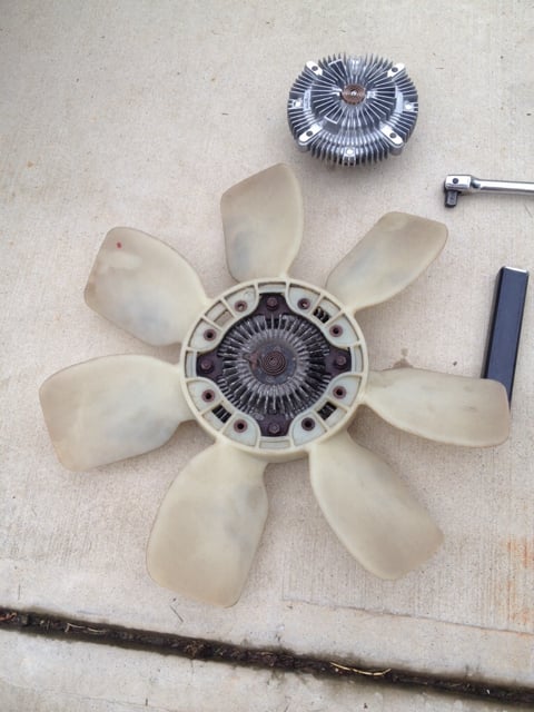

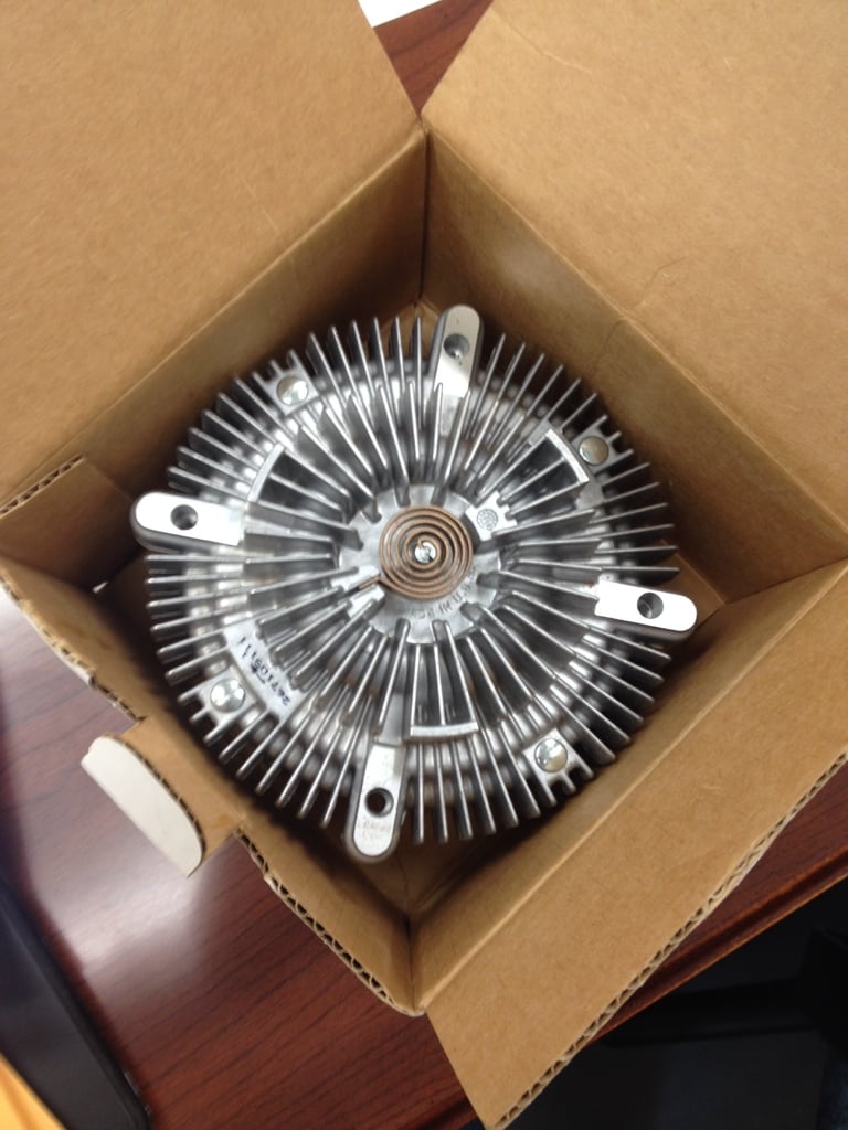

Picked up over lunch from my local independent parts store. Will write a short how to when I get done tonight.

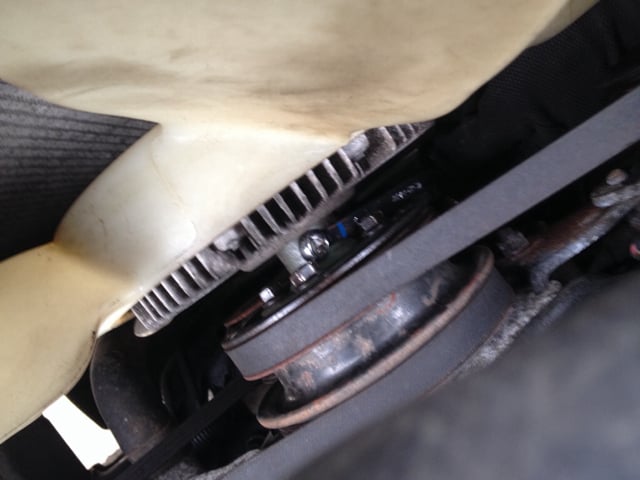

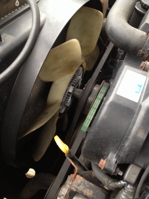

Guys,
I swapped out my fan clutch after work before dinner. Total time was 30 minutes. I could have done it faster if I had a proper tool for holding the pulley.
You'll need a 10mm and 12mm wrench. Loosen the 4 12mm nuts holding the clutch first and remove it. I used a spare wrench and wedged it between the bolts to get leverage and to keep the pulley from spinning. Then remove the 4 10mm bolts holding the clutch to the fan. Put everything back together. I user a c clamp around the pulley to keep it from spinning. I didn't use a torque wrench - as I never really do unless I'm working on something with tight tolerances. Easy job.
Took the 4runner for a quick test drive and the roar is gone. Everything running smoothly with no new vibration.
Fwiw, I took off an Aisin unit and replaced with a generic made by "Cooling Depot." The casting said it was made in USA. So at least it isn't Chinese.
