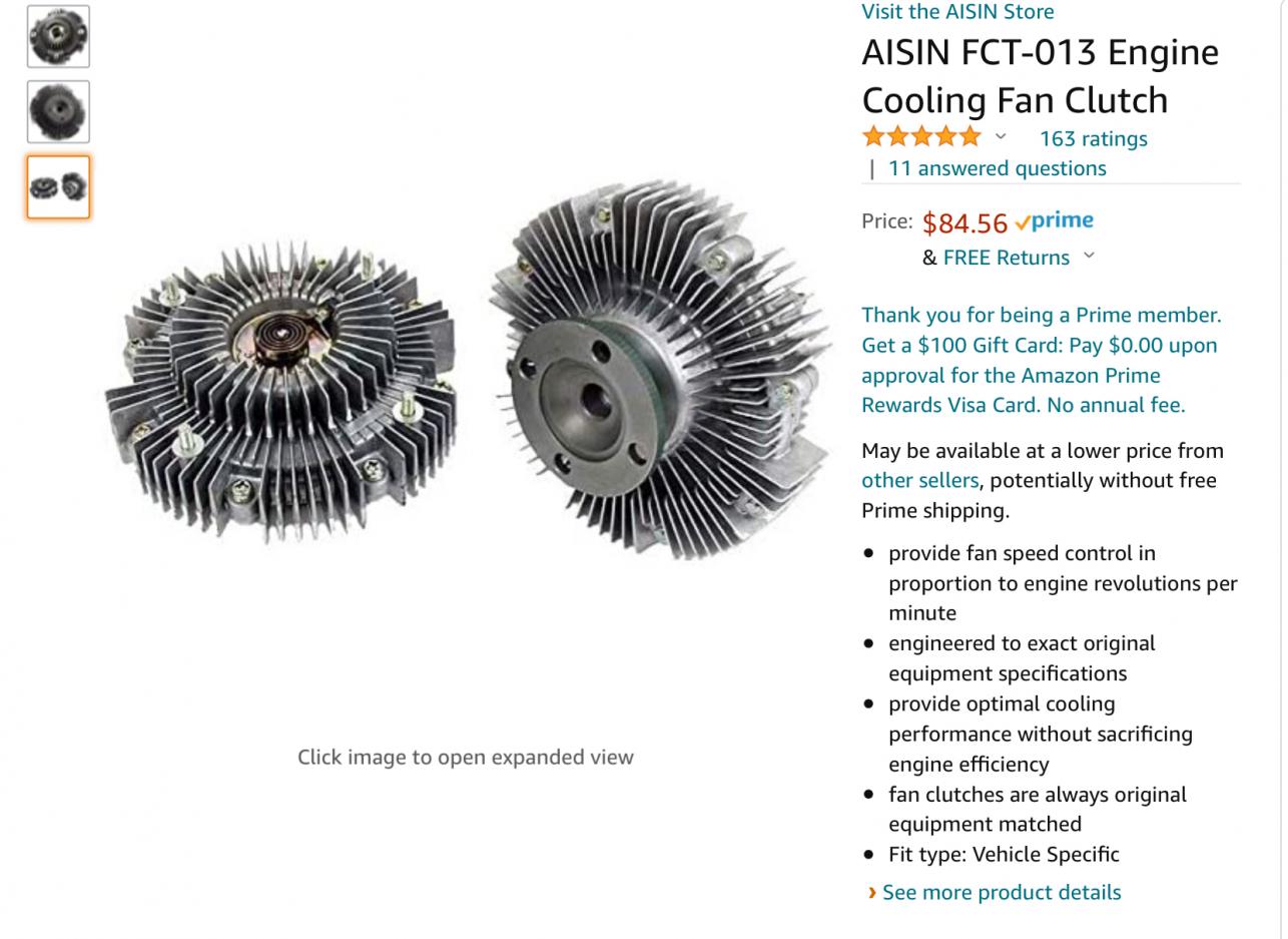

I recently bought an AISIN FCT-013 fan clutch on Amazon. Here’s the listing:

But the one I got does match the listing’s images.

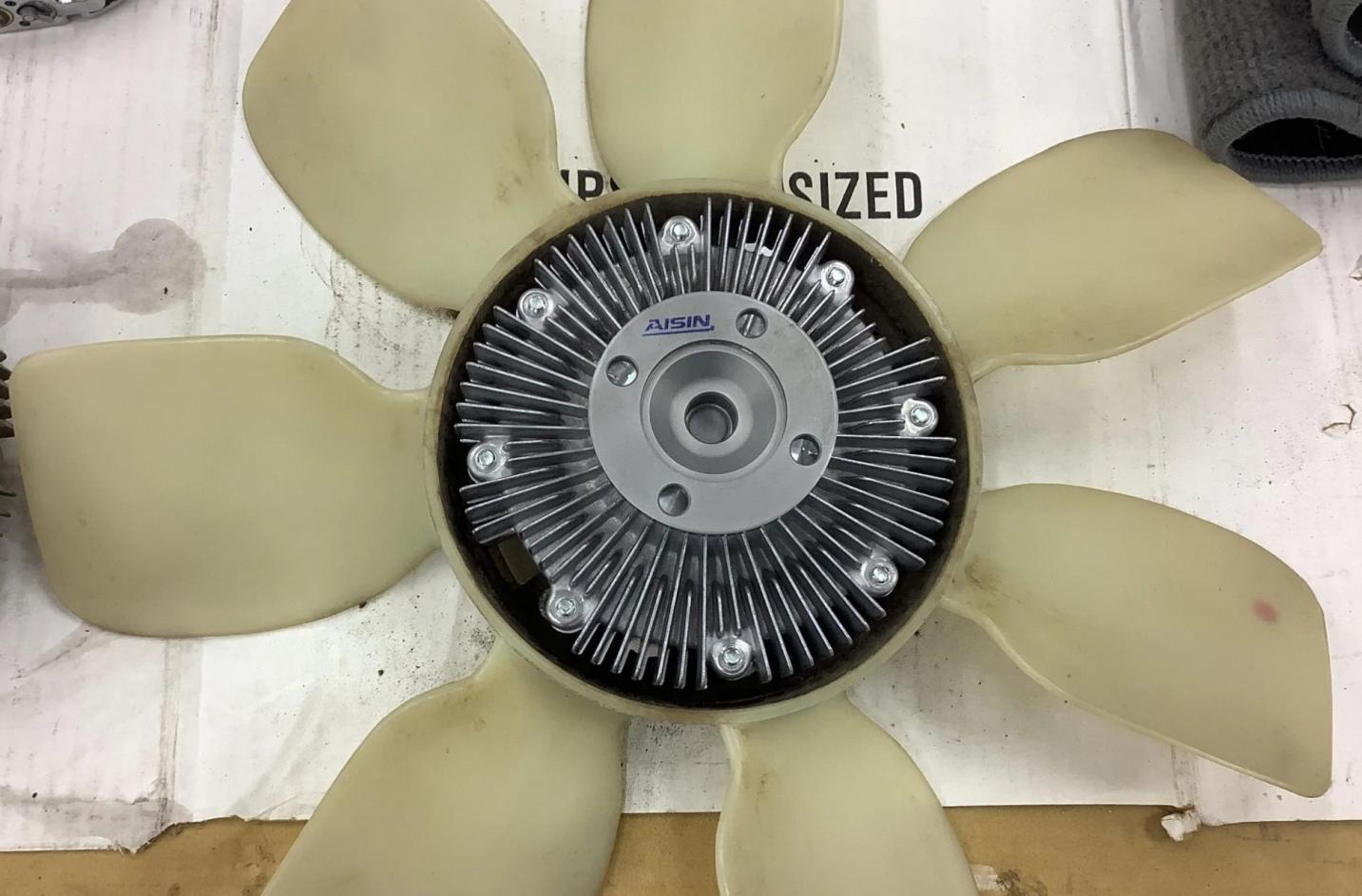

It should definitely say “Aisin” on the reverse side unless things have changed over the past few months
I purchased 2 of them on Amazon last year, one for my T100 & one for a 4TR.
See attached photo of the Amazon seller as well as where it should say “Aisin”.

The font on the box with the word Aisin is a dead giveaway. As well as the styling graphics on the box screams somethings not right.
And the part inside, it confirms counterfeit.
That’s definitely a sus fan clutch unit. I, too, purchased one from Amazon last year, but it came in a much different looking box than what yours came in, and the fan clutch itself was stamped “Aisin” on it. Very weird that’s what you received. Although if RockAuto has it for only $10 more, I’d be okay with spending that extra amount to ensure that what you’re getting is in fact a genuine unit
That is definitely a counterfeit part. What's weird is i ordered my fan clutch from the same exact link as you but I got a genuine Aisin fan clutch. The box was totally different and it had Aisin stamped on it. I would definitely return it.

Interestingly, it was from the "AISIN Store" Amazon storefront, and all the user reviews showed photos that matched Timmy's video. What's more, I followed the link the Timmy posted in his video description. This was the same product link that several other members in this thread and Timmy used to get the genuine part.
So you're right: need to be very diligent. And the diligence doesn't end at time of purchase, have to continued that diligence during and after unboxing (hence this thread).

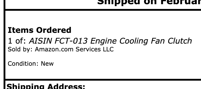

Very interesting. Yeah, even though it looked like it was being sold directly from Aisin during checkout, when I look back at my actual invoice for this purchase, it shows the seller is "Amazon.com Services LLC"
Also, the invoice says the unit is "New" ha!
