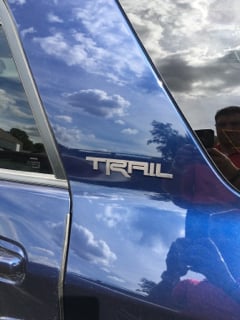

Finally got my "trail" badge.

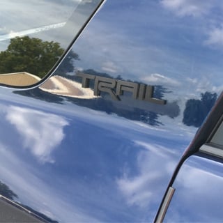

Just did mine yesterday.

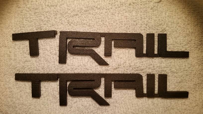

I'm pretty bummed. Post office delivered these last night and I opened it this am after getting home. On one the R is bowed down somewhat making the I and L seem misaligned. The other had the T bent downwards which just came off as soon as I touched it. I love the texture and finish but I don't know what to do with these to be honest. I don't feel they look as well made as the others I'm seeing posted. Perhaps it's the material? I'm not sure how to address this with shapeways either.

I would "politely" contact them (Shapeways, they are very helpful and accommodating) and tell them is was damaged in transit (which it was if you opened it and the T literally fell off). As for the other, that shouldn't be that way either, there Q&A should have caught that. That is a metal material correct? For the price they should be perfect IMO.
The strong and flexible materials you can heat and fix any "bend" imperfections, I can't believe that would be a reasonable fix for a metal material.
So the process for metals as I understand, they are "wet" printed meaning that the printer lays down the metal in powder form with a wet binding agent, they are then transferred to an oven where the binding agent is released and the metal melts and binds together. I suspect this would explain why the second looks deformed, they have to move the print from the printer to the oven, maybe not enough care was taken during the process?
I'm not mad or pissed (I know sh** happens). I did send them a polite email and they opened a case for me. That particular material was matte black steel. The finish is beautiful but she also has to 1). stay together and 2). not look like Salvador Dali made it. :thumb3:
I hope they don't think I just tossed these $150 emblems around trying to break them. I don't roll that way.
I'll update once I get some feedback. I'm just sad I cannot slap them on. Now that I see the finish I might even forego powder coating.. just depends on my mood for the week.

I got the flexible rubber ones and they have the same bending. Luckily with the rubber i just bent it back while I was sticking it on and its fine.
Oh and from experience working with this powdered metal, support every section of every letter. The powdered metal / plastic has a tendency to break in odd places if not supported.

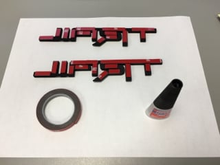

Both, I completely covered the back of the logo with tape and then cut it out very carefully. The way 3d printing metal works produces a lot of little bubbles inside the material, so the surface might look perfect but it's more like an Aero bar.
