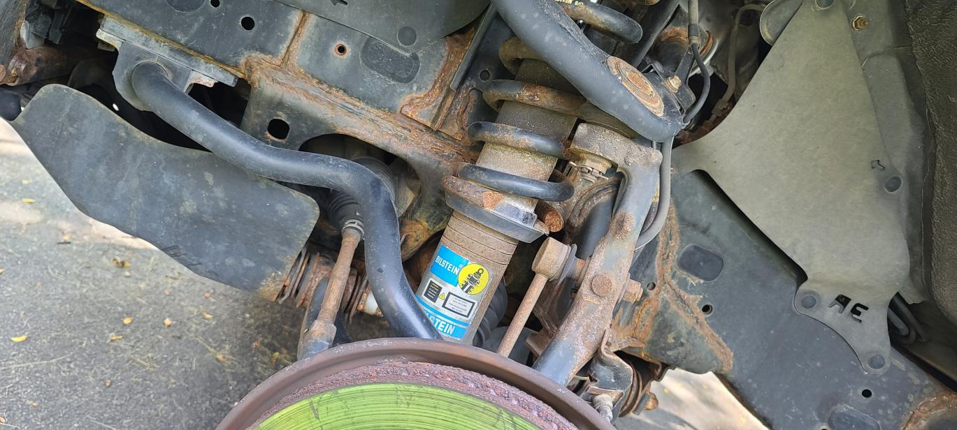

So prior to my trip to TN I found that one of my springs was missing a chunk from it! Thankfully Chitown4x4 was able to take care of me and I swapped over from the 6112s to 5100s in the front end and grabbed the new shoes for my ride!
When I pulled off the other coilover, I found that one cracked as well!

Do you have any pics of the bad coils? Also was there any signs that made you take a look at your coils?

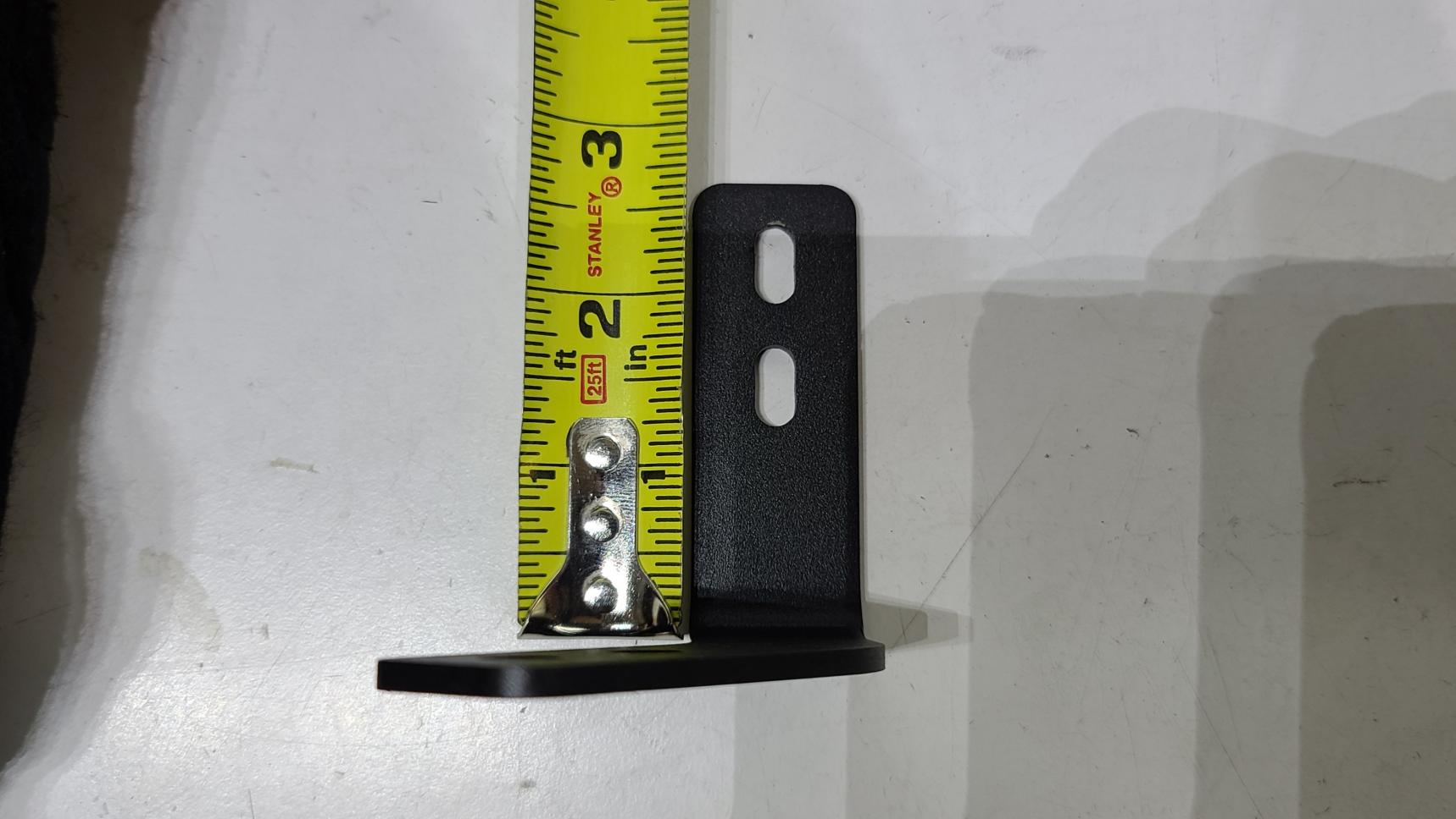

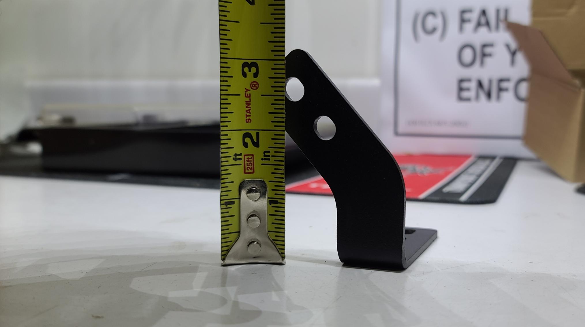

Since no one has the specs posted up
In case anyone needs it here is the measurements for the cbi prinsu led light bar bracket mount
This way if you're trying to find out if it will work for your light bar you have some reference numbers.
