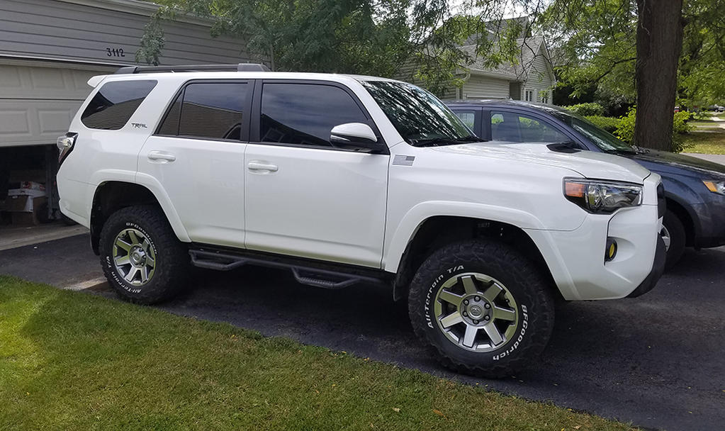

N-Fab T1464R Nerf Bar running boards
Install notes,
Torqued bolts to 15lbs
used a drill with 12mm to remove all old bolts to speed up the job.

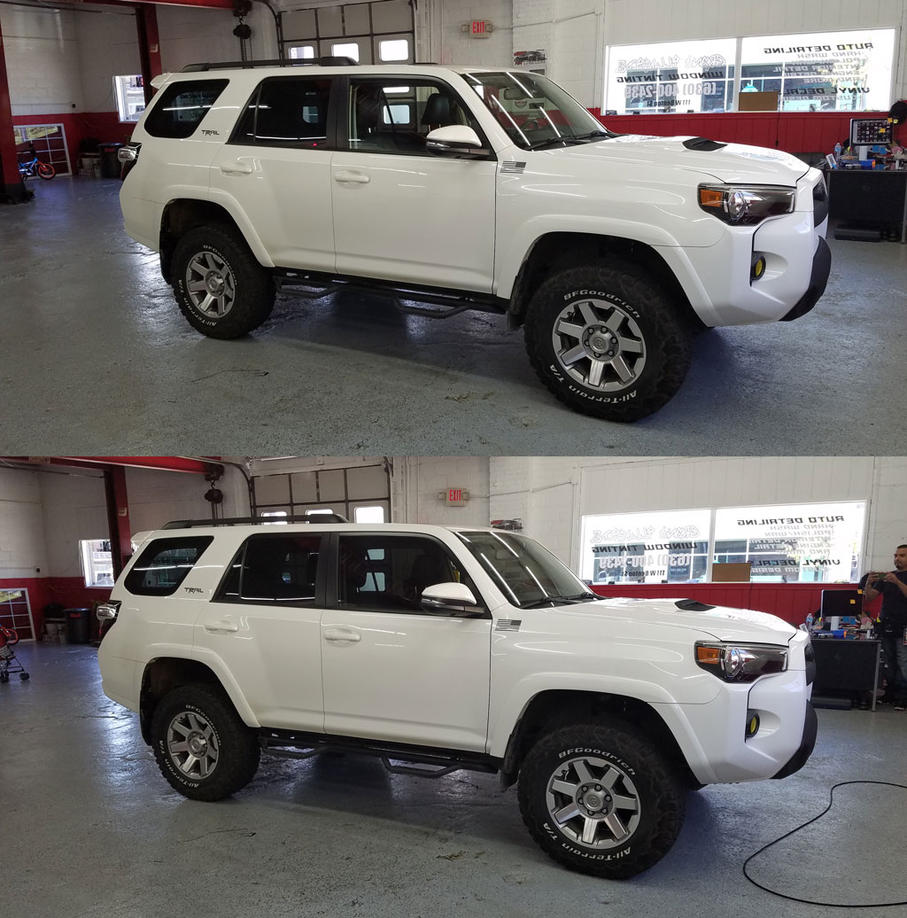

So, I was tired of the missing tint on the front windows.
I went and had 20% installed on the front windows today.

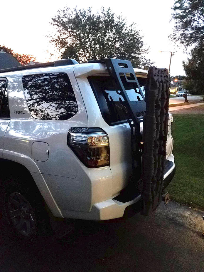

Ecotechne Ladder I picked up from [MENTION=159421]5thGen4Runner2015[/MENTION]
Lotsa gripes with how I installed it, scratched up the top, I think the ladder and brackets were bent a bit and me winging it because of difficult instructions caused me to miss some points. So while lining it up caused me some issues :( I shoulda done better :(
Love the end result.
I had an idea, it failed due to the mounting and I may revisit it. But too many mosquitos and darkness to keep trying this avenue.

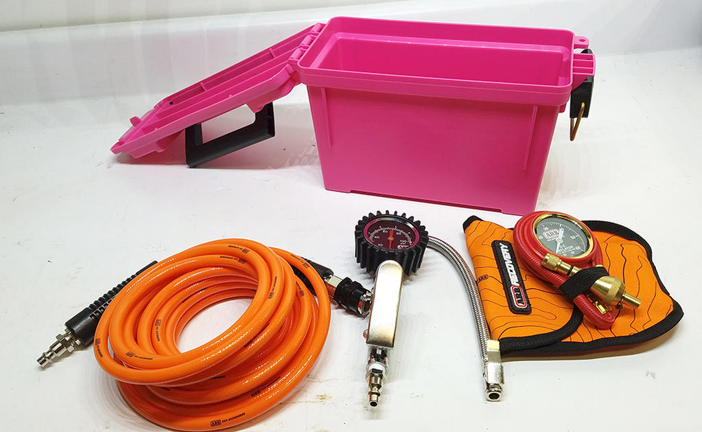

Pink ammo can for ARB stuff! That way a green bin accidentally doesn't get left behind.
