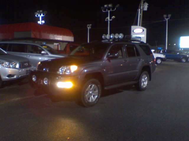

Well after 8.5 hrs I finally got the DS 2.5 and the FJ rear suspension done. It was the most frustrating install I have EVER done. Def would have helped to have had a partner. As far as ride goes it feels better than it did before and with a new set of BFG AT KO it should look pretty wicked come january. This is a crappy pic I snapped with my camera phone. Will get better ones tomorrow.

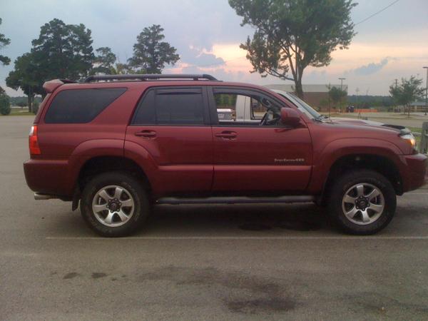

Hey guys, this is my first post to the forum. I just wanted to give some insight on the whole FJ suspension swap. First of all I will tell you how I got my FJ suspension so maybe you can do the same. The toyota dealership where I live lifts new vehicles and sells them in order to make some more money. I went there one day and asked them what they do with the stock suspension and they said they have to trash it because they cannot use it for warranty work. I asked if I could have the next set of FJ suspension that they take off and they didn't mind at all. So with that being said, I have an 07 sport edition 4runner and I did the swap and also put the toytec 3'' leveling kit on it. Front: 3" Front Lift Spacer Kit -- CNC Machined From T-6 6061 Aluminum and Rear 1 1/2" coil spring spacers. I had the xreas suspension on my yota so it did get a little messy. No matter what anyone tells you, when you take those lines off hydraulic fluid WILL come out. So anyway, I took everything apart according to the toytec instructions on the website. Super easy! When I went to put the FJ shock on I could not get it into the lower shock assembly. Not a big deal though. What I did was take a BFH and and put it in the slot and pry the opening just a hair and then I was able to slide it in. With the back I had to use a spring compressor to get the fj springs in the back with the coil over on it. not a real big deal though. Other than that I also followed the toytec directions and everything went together fine. Key things to my installation going smooth: I was in a garage with a hydraulic lift, I had some BF pry bars to use for pushing the front lower a arm down to slide the shock in easily, and I had a helper. If you want to do this I say go for it. If you dont have someone to help you and a pry bar, I say your insane. I will be more than happy to help someone out that wants to attempt this. It really made my 4runner sit up higher and did away with that mushy shock feeling but the ride is still smooth. I tried to add a pic but could not get it to upload, sorry. Good Luck.
Good deal, glad you're happy with the swap. Do you have measurements before/after? It looks like you got the 2010-2011 suspension, which will require slight modification to fit. 2007-2009's you don't have that problem, but you can't beat the deal you got!!!
Sorry for the major delayed response guys. I am located in fayetteville, NC. I am in the Army here and I was away for some time shortly after doing this lift which is why I didn't get a chance to respond. I did not take any measurements, sorry. The ride is still good though. I definitely recommend that if you can find a place that does lifts often, asking them when they lift an fj to save the old shocks for you. They seriously just trash them!
