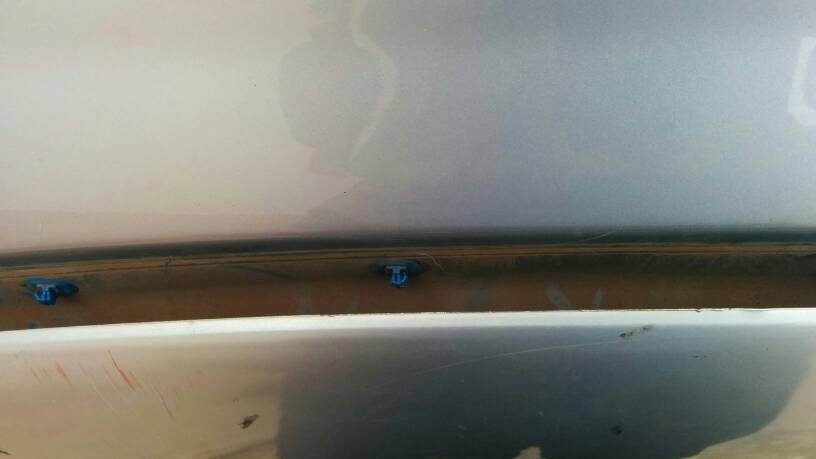

Hi Team,
I lost a couple of my flare Clips yesterday. Kindly send me a link to a replacement link on Amazon so I can pin them back. Pictures below
Thanks in advance
did a quick search and i found PT Auto Warehouse CPA136-15 - 15pcs per Pack, Wheel Flare Moulding Retainer Clips - Fasteners; Replaces OE #: 90904-67036, 90902-67036...wondering if it will fit.
Rocker Panel Clips Orange
Your welcome. I find it easier to rotate the old clips 90 degrees to get them out. There are sometimes orange clips mixed in with the blue to hold on rocker panels. PN 75397-35010. Used both on my 2006 and 2007 4runners.
