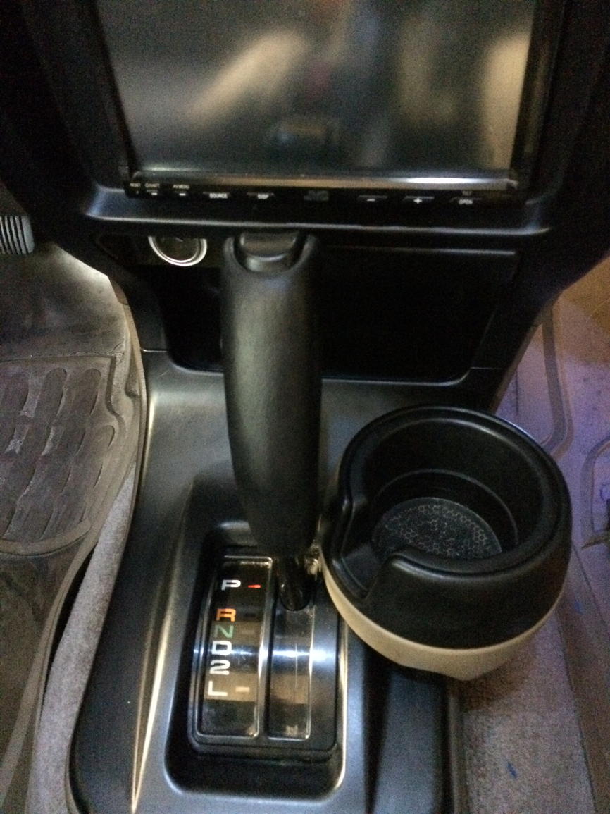

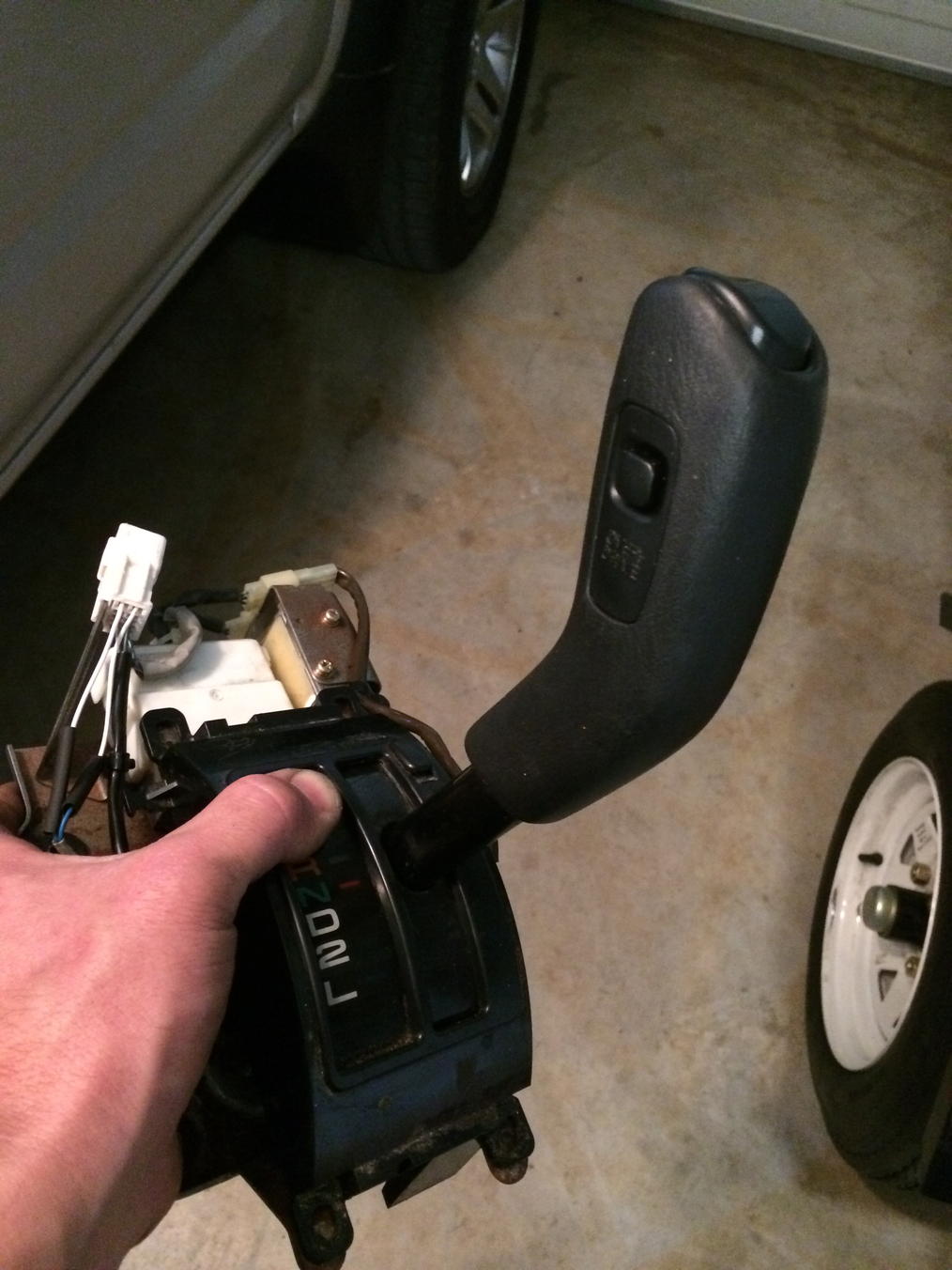

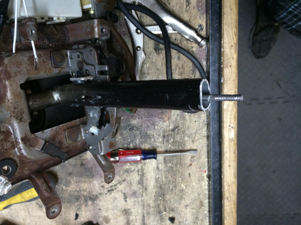

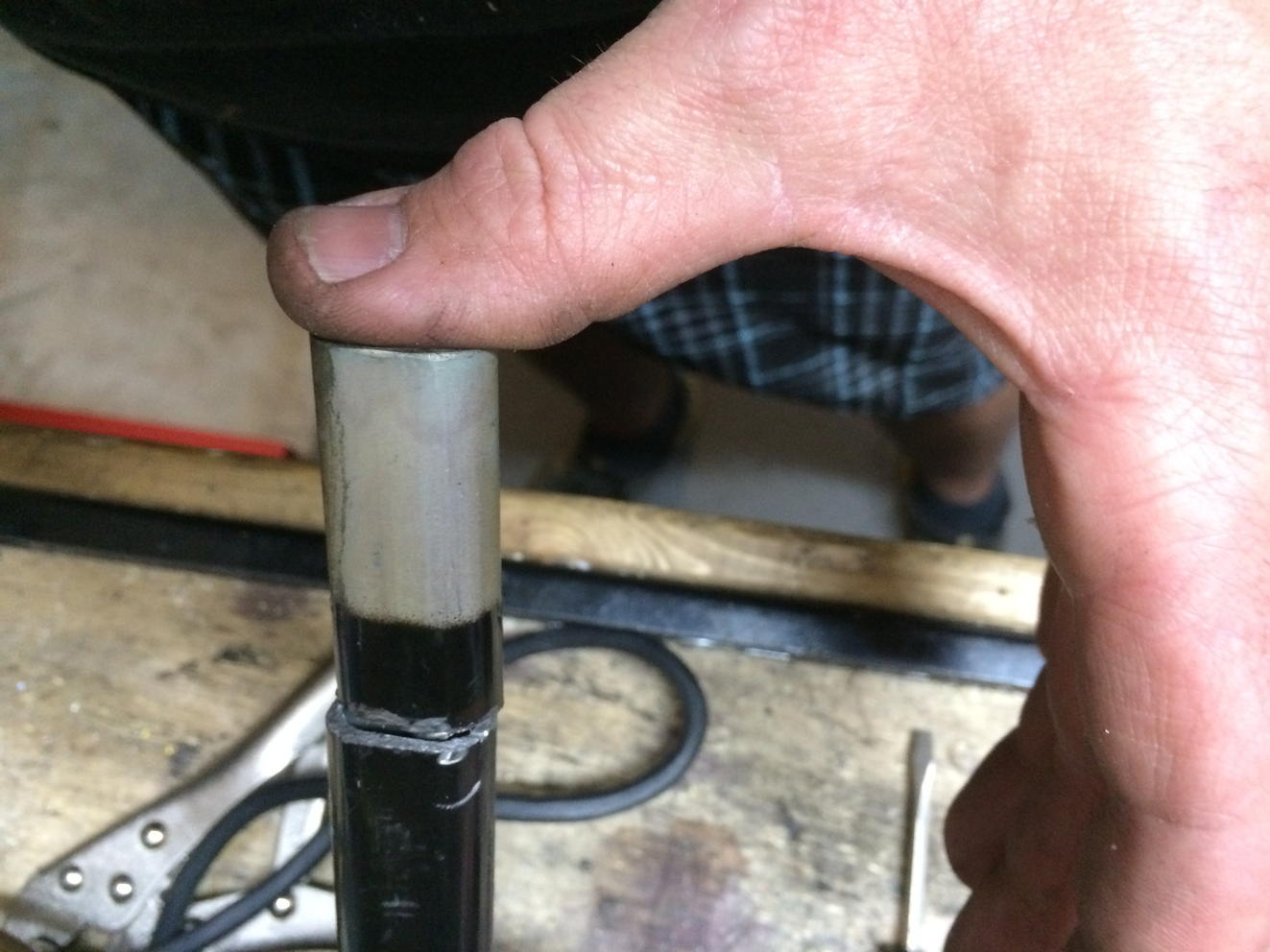

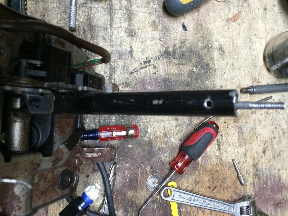

First off, thanks to DeathCougar for the parts! Ok guys so I know that maybe it seems like a silly mod, but its something I have always wanted to do. Did a ton of searches about trying this on all the relevant forums and found nada. Looked like it would be swapping a couple screws and a spring or two, easy right. NOPE. 2 hours later, and a bunch of work and VOILA! Had to cut 50mm off my stock shifter and its interior parts, tap some new mounting holes, re-thread the pushrod, shorten the trigger spring, and rewire the O/D button. So if anyone had this in mind BE AWARE its kind of a PITA. Turned out really cool though and it looks like it came from the factory this way.

Awesome MOD [MENTION=64040]dgoll75[/MENTION], I bet there are some people out there that will really appreciate your hard work. :tea:
no pictures of the end result?
I guess I'm confused because I expected to see a 4HI/LO shifted added. What exactly did you do? I have never actually been inside of a 2WD 4Runner so i don't get it.
BTW faking 4WD is highly highly offensive. :fear:
The actual shift knob is different, kinda big and ugly.

Not faking a 4wd by any means. As Mike&Ike said the OEM 2wd shifter is huge and clunky. If my intent was to fake a 4wd, I certainly could have mounted the tcase shifter along side.....

nice job, that looks way better than the giant bobblehead that comes in the 2wd. if you can do all of that, then a 4x4 swap should be a cake walk...

Thanks bro. Its my DD for my Mobile Detailing biz which I carry a trailer for. No need for 4wd. But I love it anyway... :bigok:

To go the opposite way I think it would only require the swapping of a couple screws and springs. Reason I had to cut the stock 2wd shaft is because the 4wd handle is taller. Would have hit my dash.
