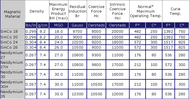

Now... with a heat range of -100c to +80c, how can we be so sure that the material won't disintegrate?
Well they probably don't generate the same heat but the differentials come from the factory with magnetic drain plugs.
neodymium iron boron does have a lower curie temp point than samarium cobalt. As this temp is approached the magnet will experience irreversible demagnetization. Nd Fe B should be fine at the temp. of the oil drain plug though.
Now, I would be careful about the marketing approach used for the drain plug. These rare earth magnets are expensive so be sure that the plug has this magnet type as opposed to a ceramic grade magnet, also known as strontium or barium ferrite (sounding scientific).
