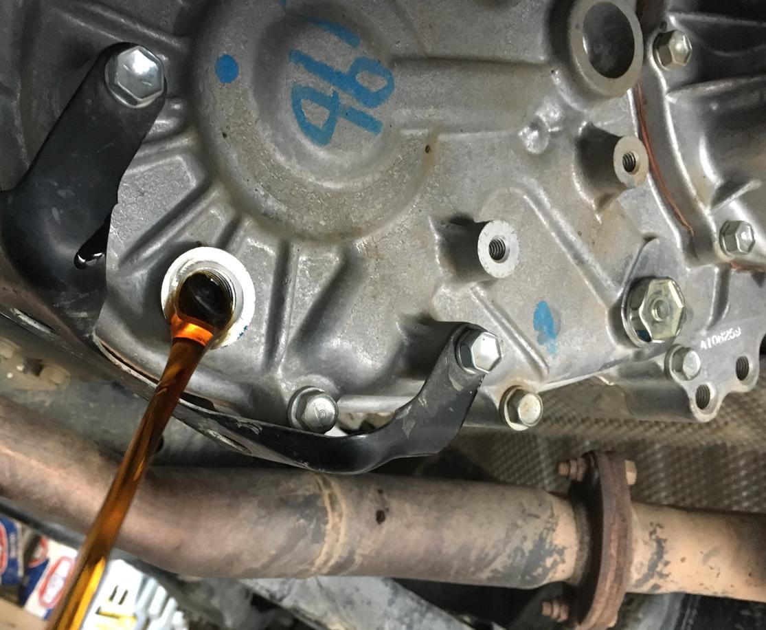

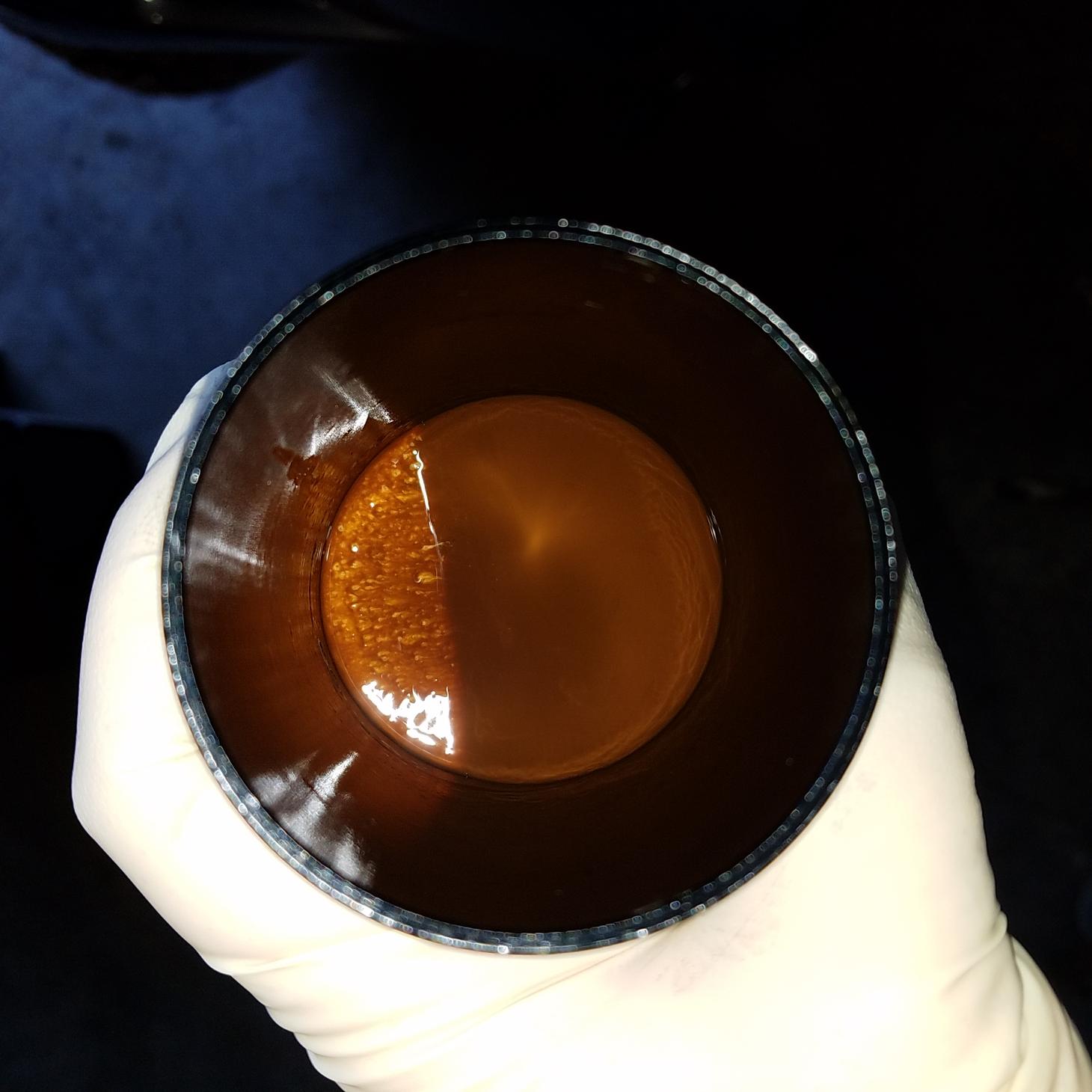

I’ve got just over 91,000 on the truck.
Changing my Transfer Case fluid for the second time in its life.
45596 miles and almost 4 years of service using the Delvac 75w-90.
No leaks, no issues so far. Fluid level was right at the fill plug. Fluid looks good and no debris on the drain plug (no magnet). If you’re wondering about the fill plug still installed in the pic, I put it back in after checking the level to slow the initial draining.

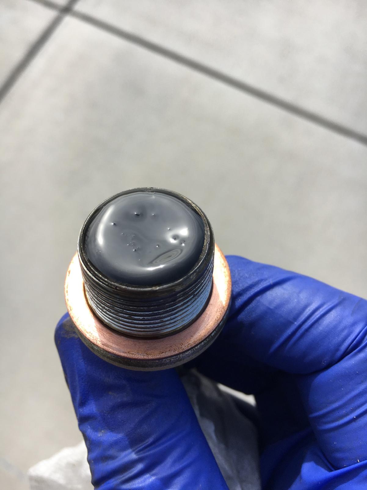

I thought these would have had magnetic plugs? Something to look into before my first drain and fill. Swap in a magnetic drain plug, did the same with the engine oil drain plug.
Yeah I guess I forgot that they didn’t have it on the T/C.

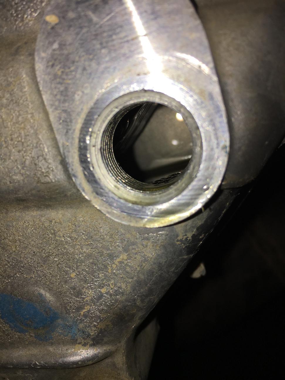

Here’s my front diff.
Fluid is even cleaner. I like to think I do a lot of 4wd but obviously not that much. My long breaker is too long, the medium worked but hard to get leverage laying on my back. This did have a decent amount of gunk on the magnet.

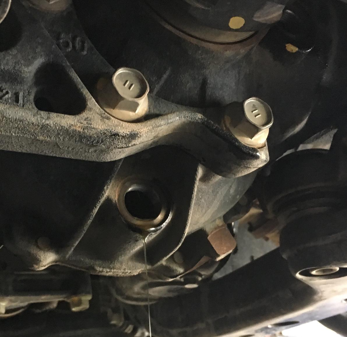

I changed my OEM front diff oil at about 11k and it was dirtier than that. Rear was quite a bit dirtier than the front was. Wondering if it's just initial break in and it'll be cleaner moving forward. I had only been in 4wd for the monthly engagement and quick trip around a parking lot and used it for short periods through the 1st winter I had it. Guess we'll see what it looks like when I change it again but that'll be a while. I bought my 2016 and drove it home brand new January 29th 2017, left the lot with 8 miles on it. I don't even have 14K miles on it yet, I don't put many miles on my vehicles. By the time I hit 50K and service the transfer case it'll be 6-7 years old give or take with an average of 635 miles driven per month. Curious to see what the oil looks like at that point but I feel it'll look brand new. I'm about 1000 miles from my 15K engine oil change, curious to see if I find anything on the magnetic drain plug when I pull it and curious to see what's in my catch can since this will be the first 5K mile oil change since I installed it. Last oil change revealed about 2 ounces of mostly water in the catch can, that was in about 2K or so.
