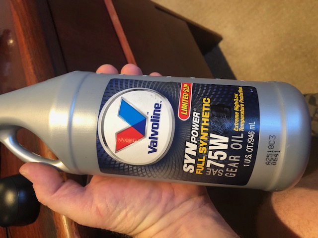

One quick question: the mobile 75w-90 mentioned in this thread are the $10 per quart LS one? Is there a non-LS version?
Not in synthetic that i'm aware of. There is nothing wrong with using LS gear oil in a non LS diff though. Just don't use it anywhere there are brass parts as LS additive eats them up. One of the reasons it doesn't belongs in a lot of transfer cases and manual transmissions.
